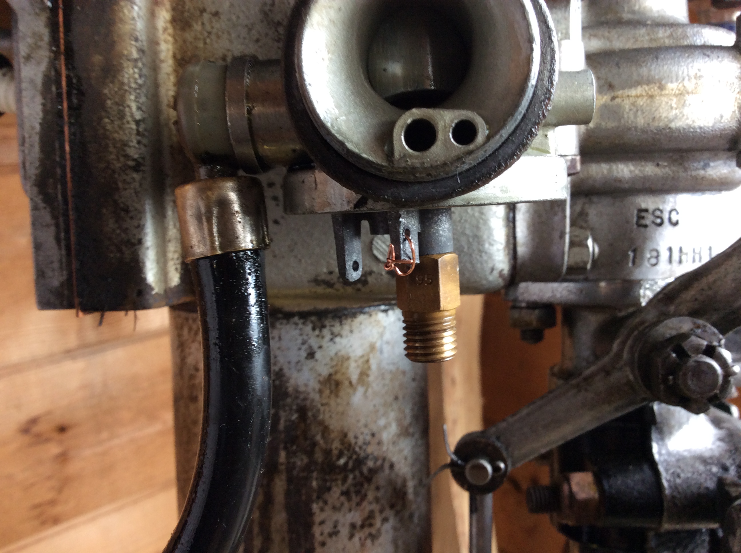

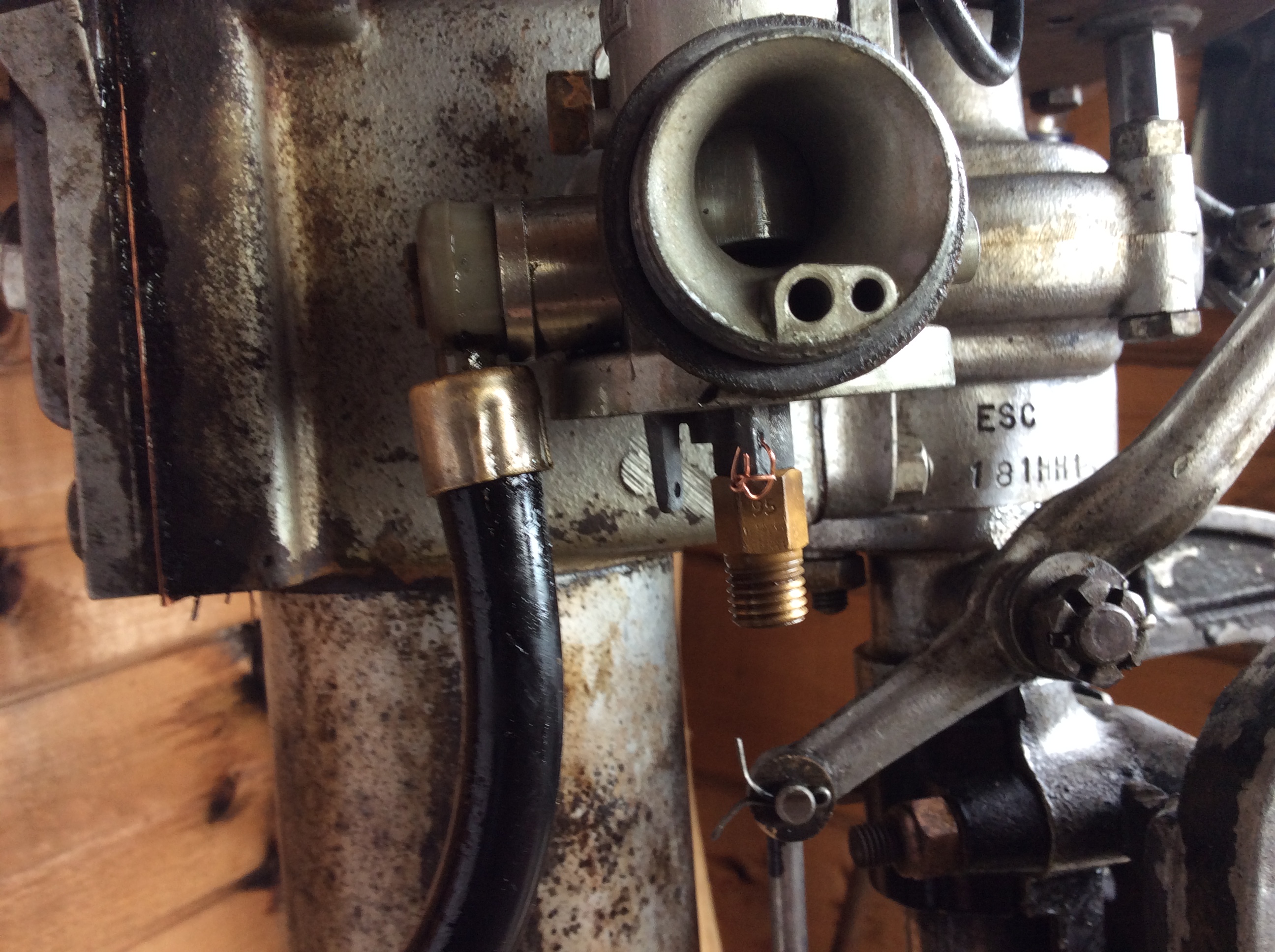

Looks like I have found the problem
The two little arms that come down to hold the brass pin for the float
One has been snapped sometime or other
There has been a small hole drilled up one of the arms
With a small piece of copper wire put through it
And tied so the brass pin can go through it and line up
With the other existing hole
Obviously not a good idea
I will try to post a couple of pics

That carb is dead, try asking John Williams see if he's got a 416 body, as thats all you need.
