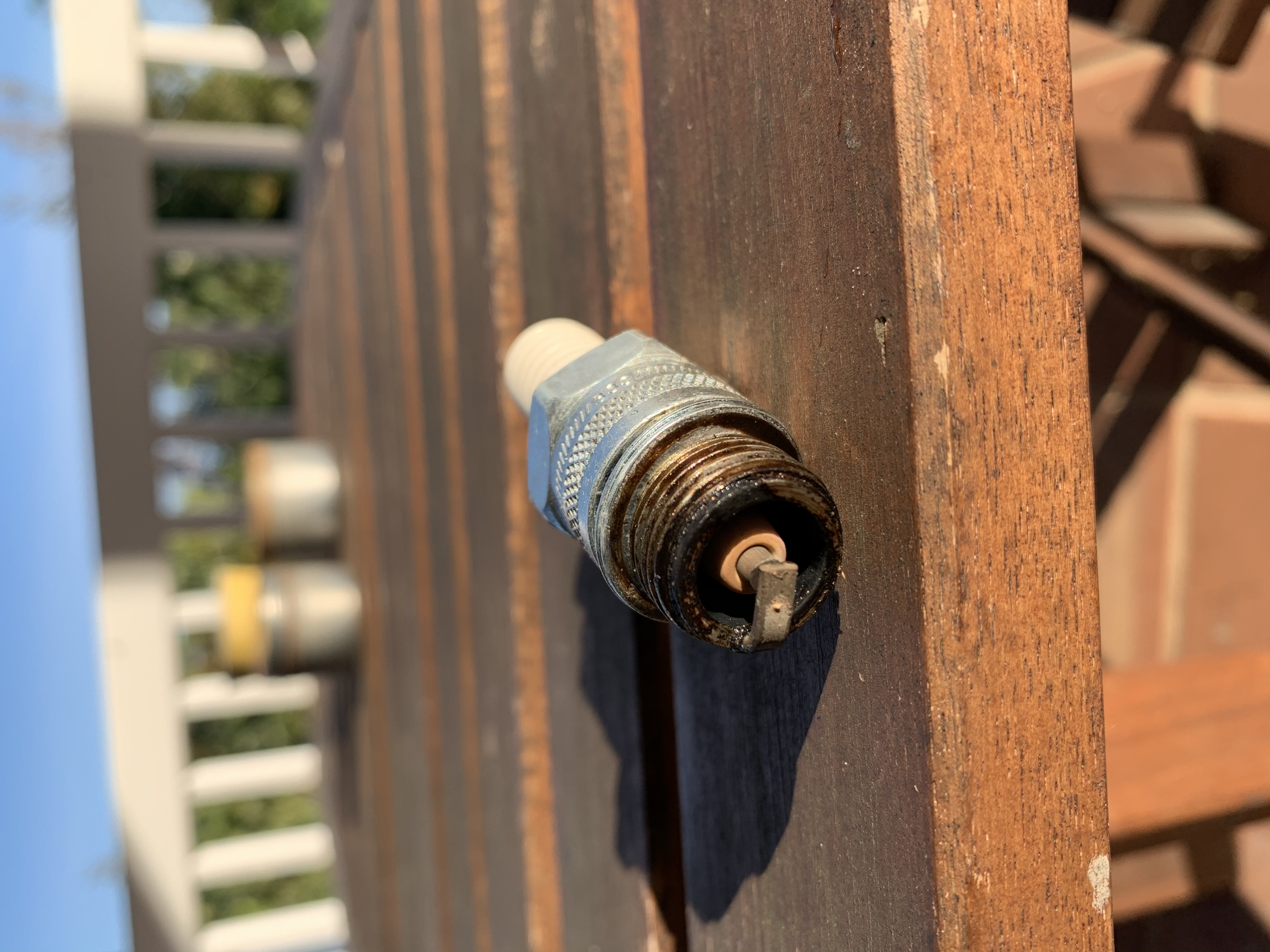

So onto my question. I’m sure this has been covered plenty, but the search feature is a bit tricky on the forum. Below is a pic of the spark plug, which was a new champion d16 properly gapped and run for about 90 minutes. Can anyone give feedback on the plug condition or point me to a thread that can?

Plug looks good to me! Nice colour

With you saying the engine was 'running cool' that would explain the slight oil residue on the threads and barrel of the Plug. The actual combustion zone colour at the tip seems to be more or less perfect. I wouldn't stress about it. 8)
