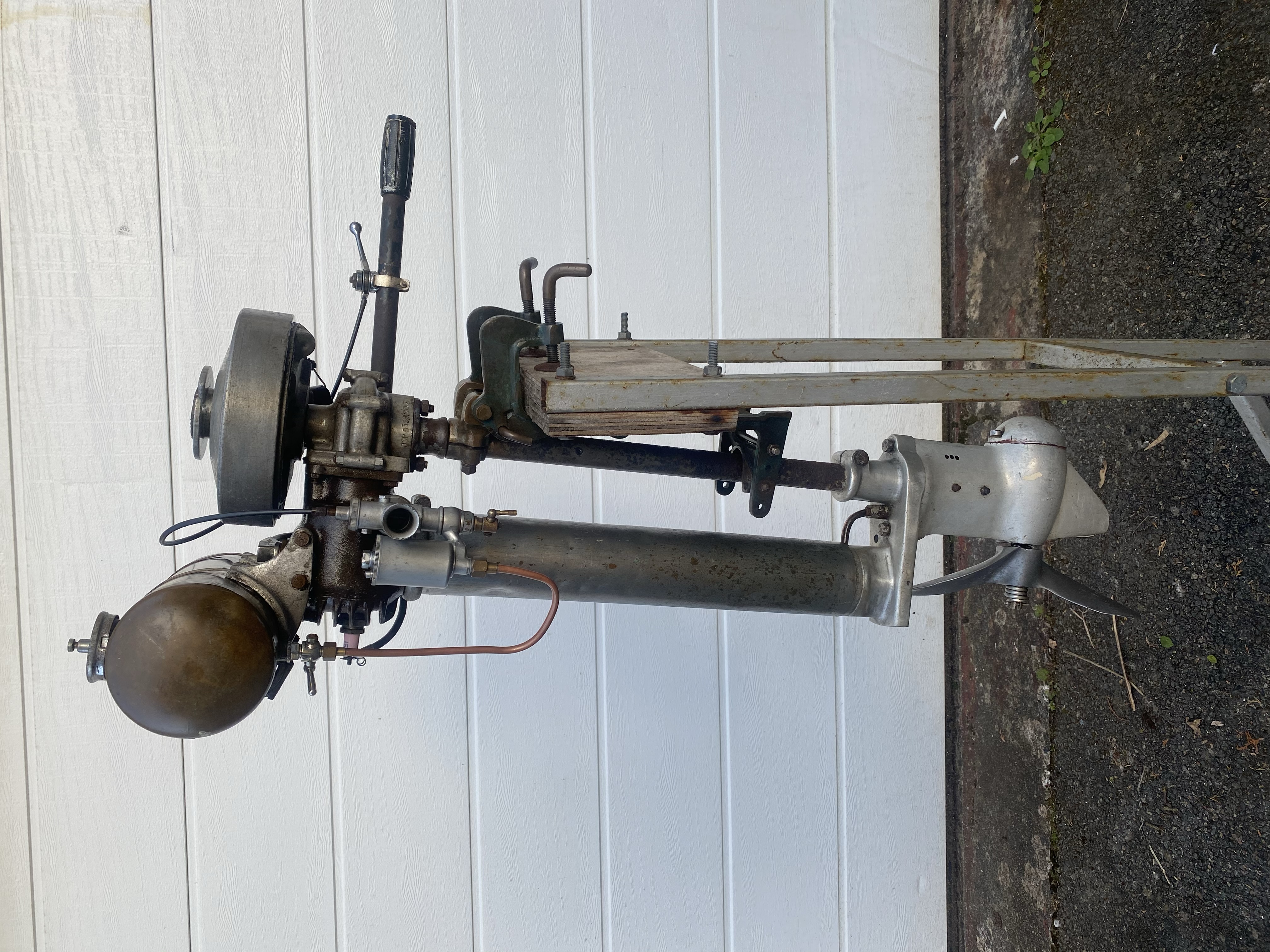

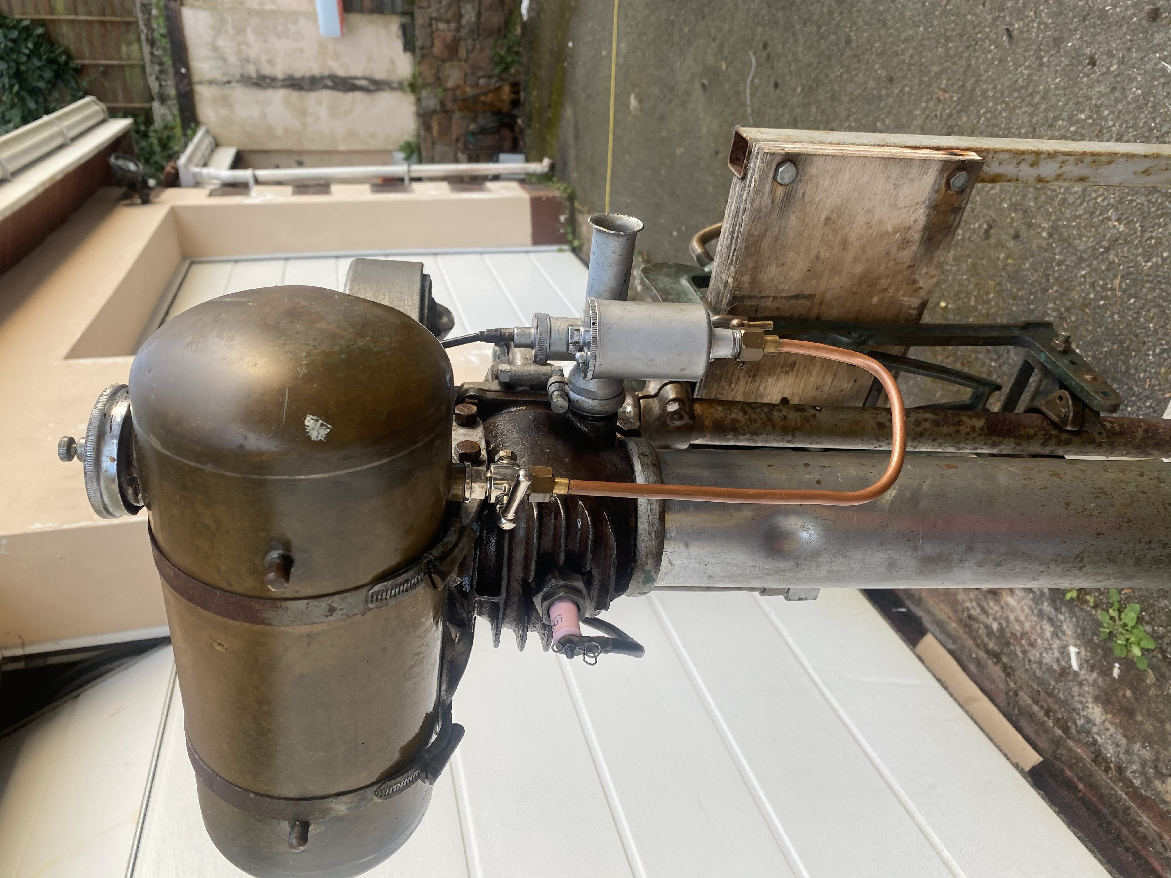

As I’ve been away I’m stuck with this self isolation so into the workshop, I’ve managed to find some period Marston parts, I’m lucky to have had a spare ignition and flywheel of roughly the right year, JM 1984 number stamped on the flywheel and baseplate, I’ve put an early straight out of the back exhaust/pump housing, not quite correct as the original would probably have had a rudder pintle that all pre war gulls seem to have but close enough for now, fitted the correct type prop although a little later as well as the correct barrel, carb float chamber, inlet trumpet, fuel tap, throttle lever and steel tiller although the original may have been chromed, so all I need now is the patience to find a fuel tank with the filler in the middle, one piece tank mount, pump housing with pintle and a transom mount although the bronze skeleton I’ve used is pretty, quite rare and only a few years younger, saying that the original would be nice.
Is all this worth it?? Or have I used up my scarce Marston spares
One nice thing though, amazingly it’s got a spark, may try to fire her up later...
