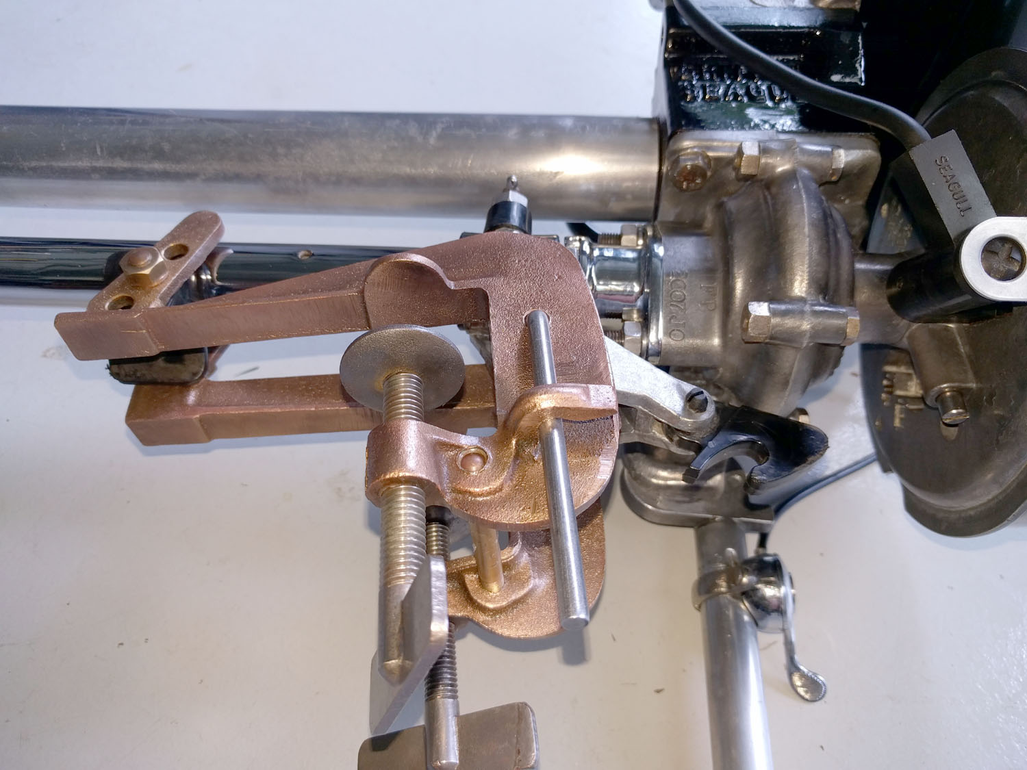

I've been mucking around with a Silver Cenury that I have had for years. The gearbox was shot, the barrel was rusted, and it did't have a transom bracket so it was mainly just for parts. I repaired an old cylinder barrel so decided to resurrect the Silver Century. I found an ad on Gumtree for the missing parts and collected them today. The parts came with a 40 plus as well, so I guess I have another project. The box of bits had a couple of tillers that I hadn't come across before. They are made of brass but have a bracket welded to the end. The grips look like genuine Seagull. Any idea what model (if any) these tillers came from? The round tank appears quite old as it has the hex nut and not the round for the fuel tap thead.

Re: Box of Bits
Post by cookie1 »
Nice selection , the round tank and 2 blade bow tie prop for a 102
Posts: 3319
Re: Box of Bits
I Like a box of bits, always something of interest to be found 8) The 102 tank has an incorrect fuel tap by the looks of it. Those tillers are normal for earlier 1950s century and 40 series engines.

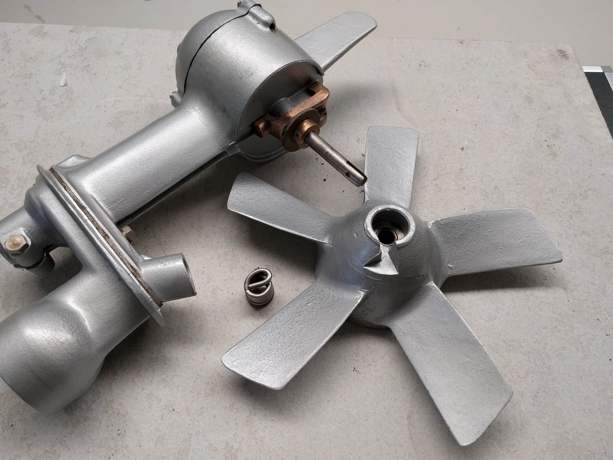

Re: Box of Bits
Can you post pictures of the lower unit around the propshaft area.
Is that a 3.5 : 1 box?
Or have I lost it?

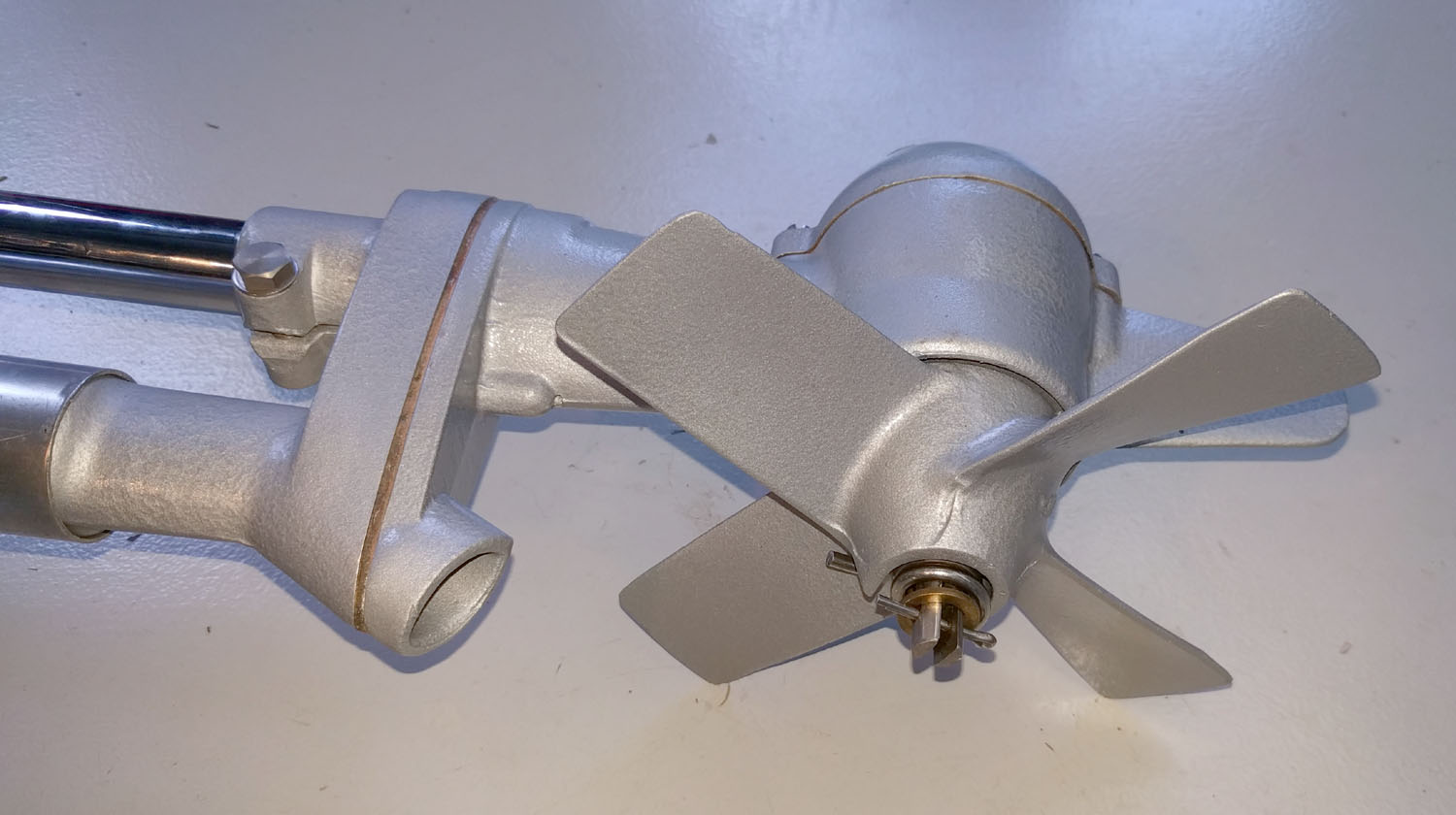

Re: Box of Bits
Post by Raya »
I very much doubt that you have lost anything.
The gearbox is a 12/48 clutched model, I assume from a Century Plus model. I thought that the 10/35 box was for the direct drive models only, but I could be wrong. Anyway, here are some pictures of the box (after a cleanup) so you should be able to tell from these.

Re: Box of Bits
The girlfriend bought me a bag of marbles for my birthday, & that says it all!
That's a "barge pusher" lower unit, the reason for the request was it looked like a 3.5 : 1 box but with a clutch & that couldn't be right.

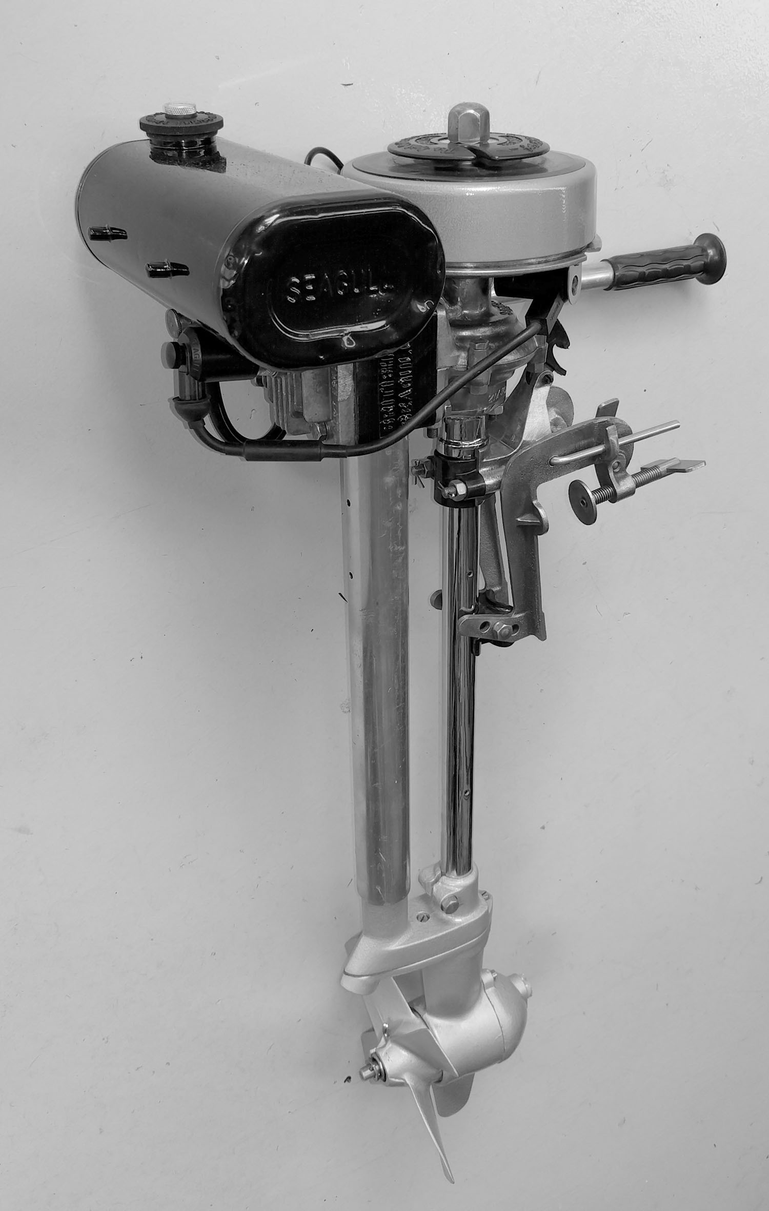

Re: Box of Bits
Post by Raya »
I thought I would post a few pics of the 40 plus that came with the box of parts. I had the tank powder coated but wasn't satisfied with the finish so haven't put on a transfer just yet. Apart from that, I'm happy with the result.
Re: Box of Bits
That has come up nicely. Job well done!
