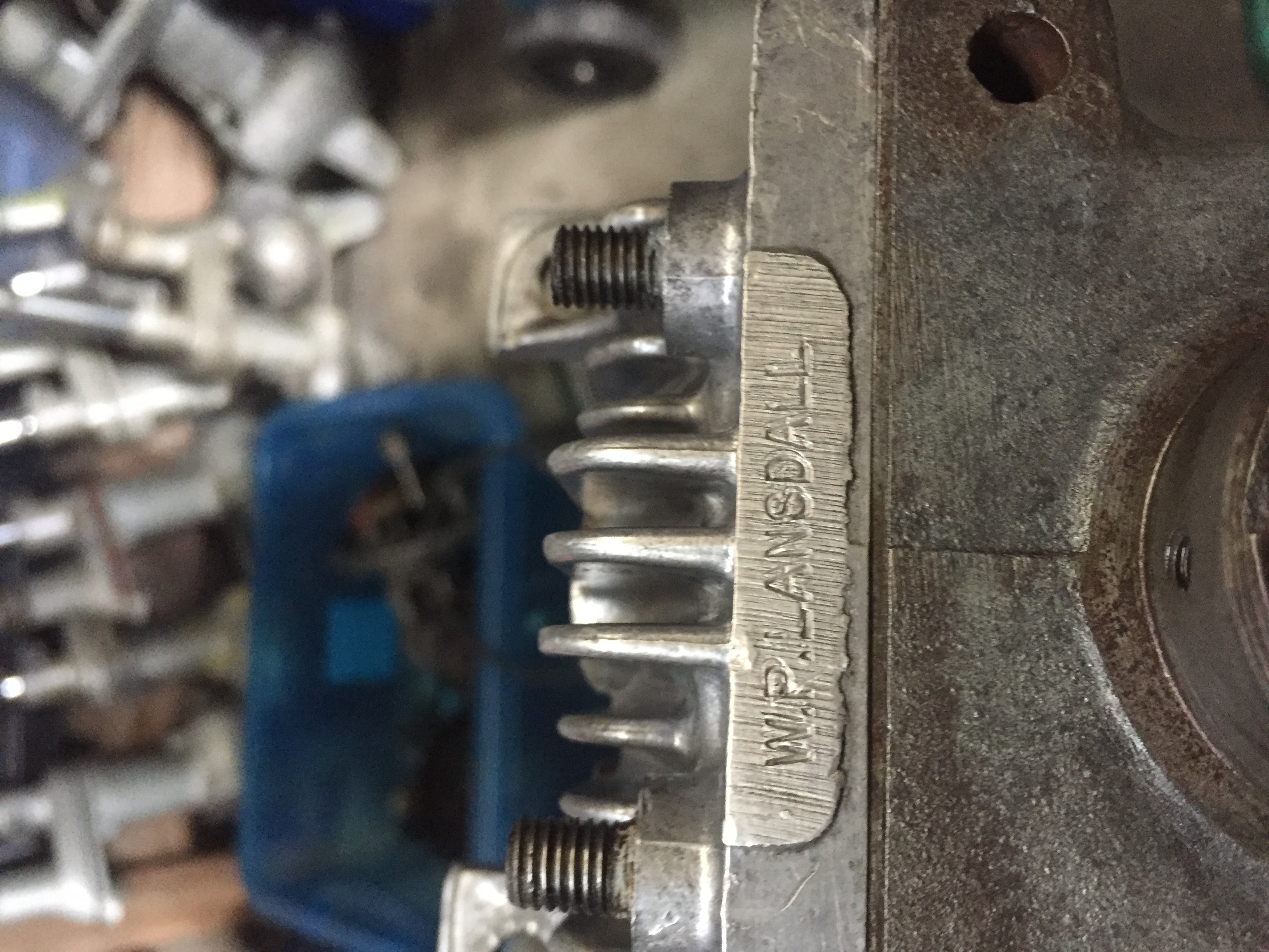

Found this while looking over an earlier seagull I picked up would this be a previous owners name
Re: Clynder head
Well it's not anything that Seagull stamped there.
