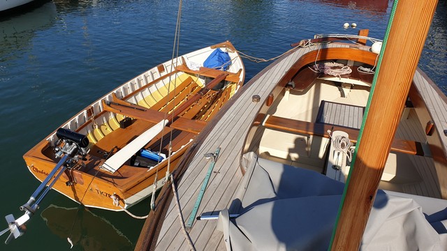

Anyway, it was all in good enough condition to restore. Once the weather gets better I'll give it a run on my little Fazackerley

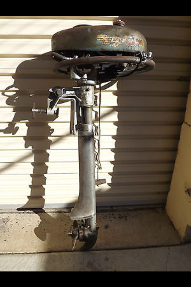

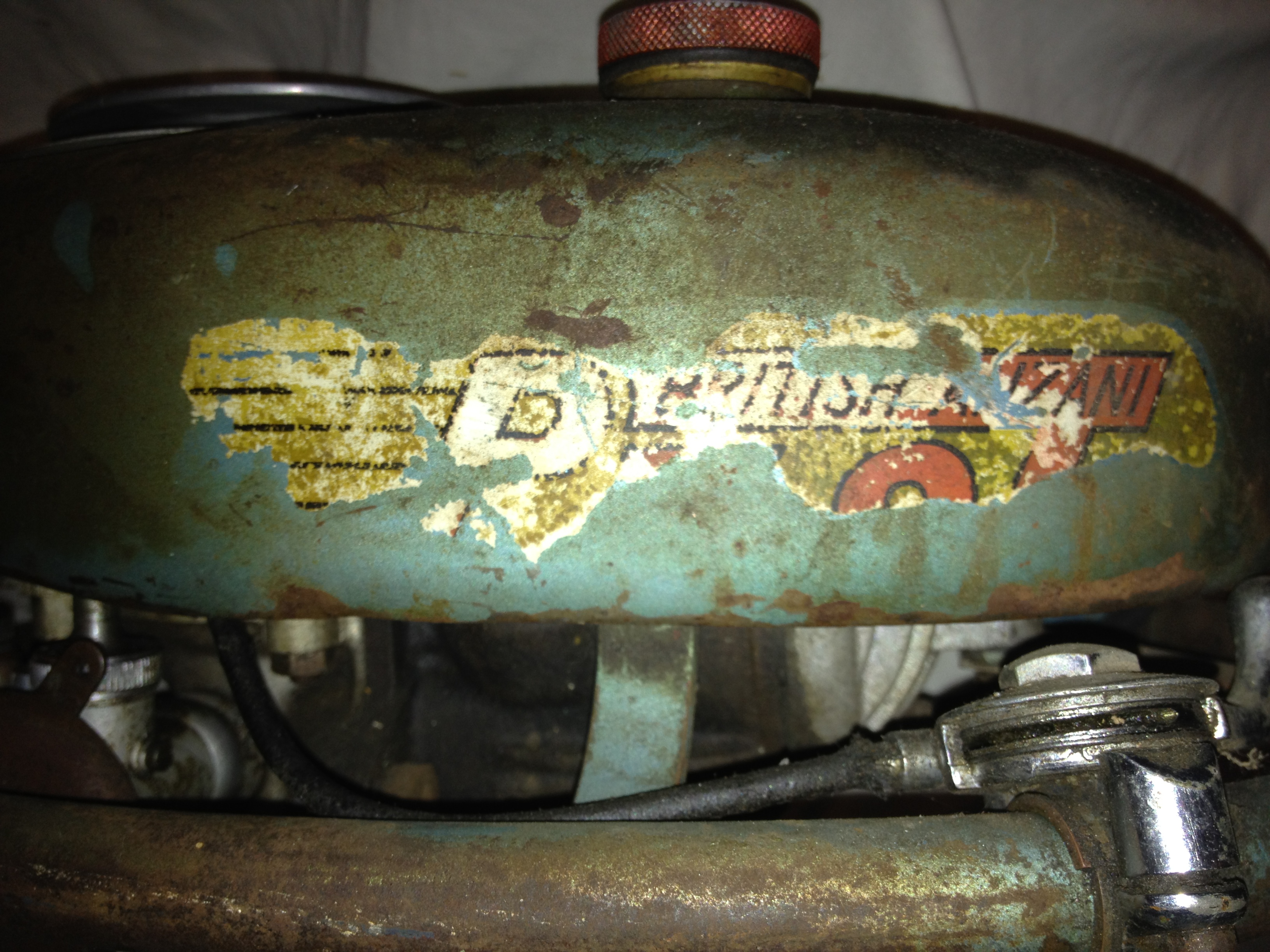

From my own observations, the earliest Pilot outboards had a drive/exhaust tube instead of a full castings. These are the models that comprised the decal of the style applied to your pilot outboard. Below image was posted in these forums by another SOS member.
The second type I am aware of comprised a cast drive/exhaust tube and a single transom clamp. The decal was a single wing with the Pilot name on either side of the tank. Sorry, i don't have a image of a completed Pilot with this decal on file.
