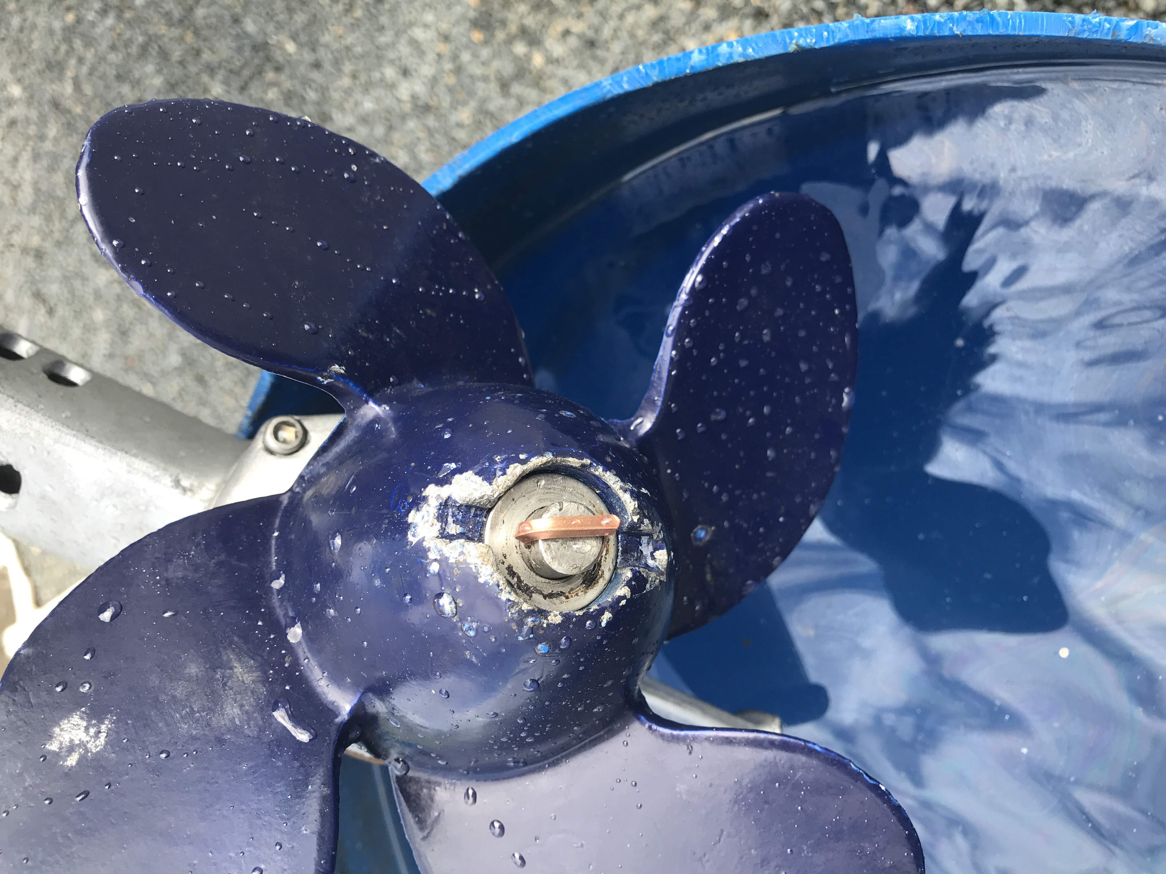

Basically it runs fine with no prop, in gear and out. I put the prop on and it just stalls.

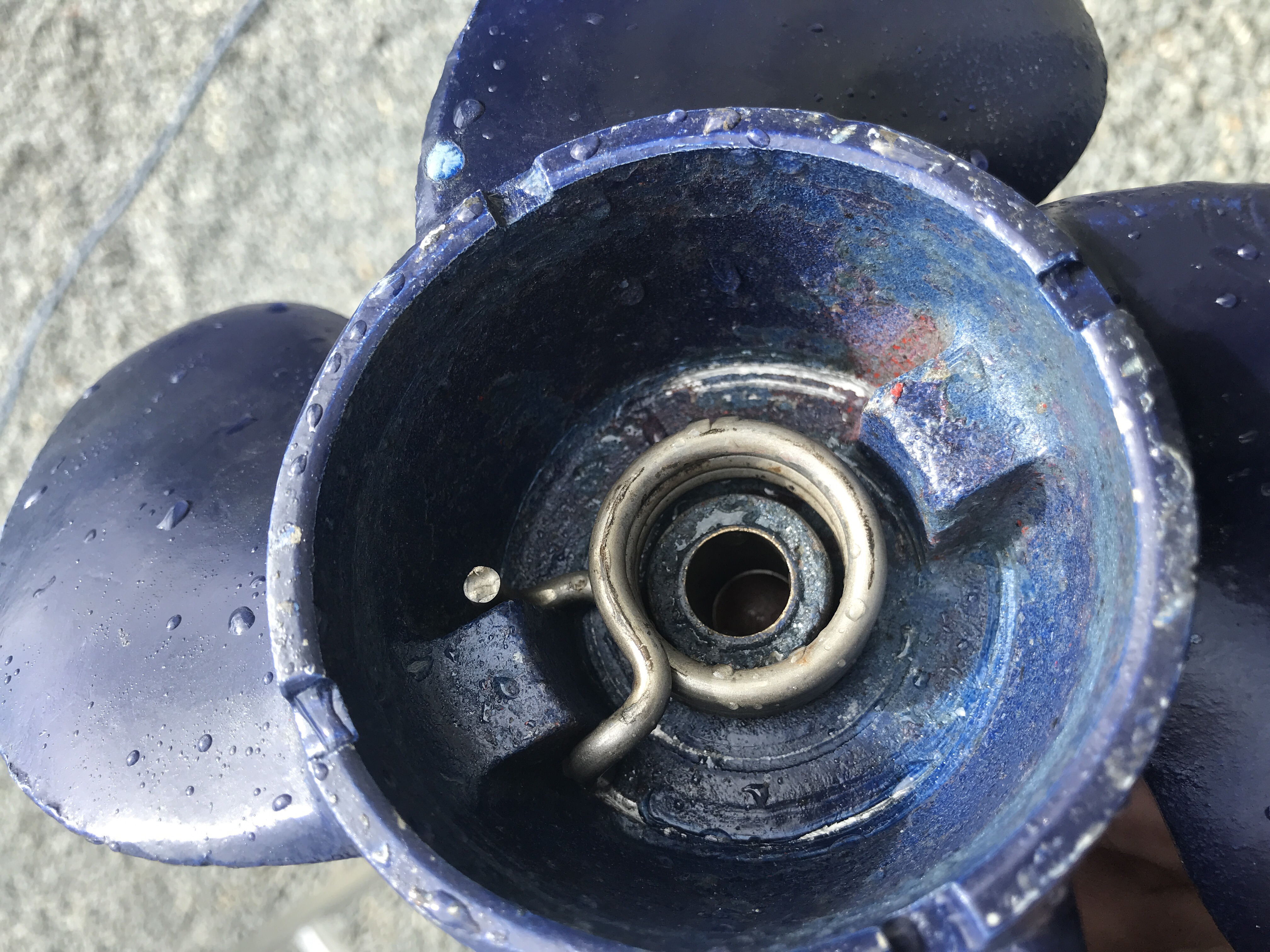

The prop is the kind with the internal spring.
I would normally say it is fuel starvation, but the carb has just been cleaned and is fine.
Plenty of fuel getting there, and the breather on the tank is open!
I can put it in gear and turn it over freely so something else might be at play.
Is the prop on the correct way?
Thanks

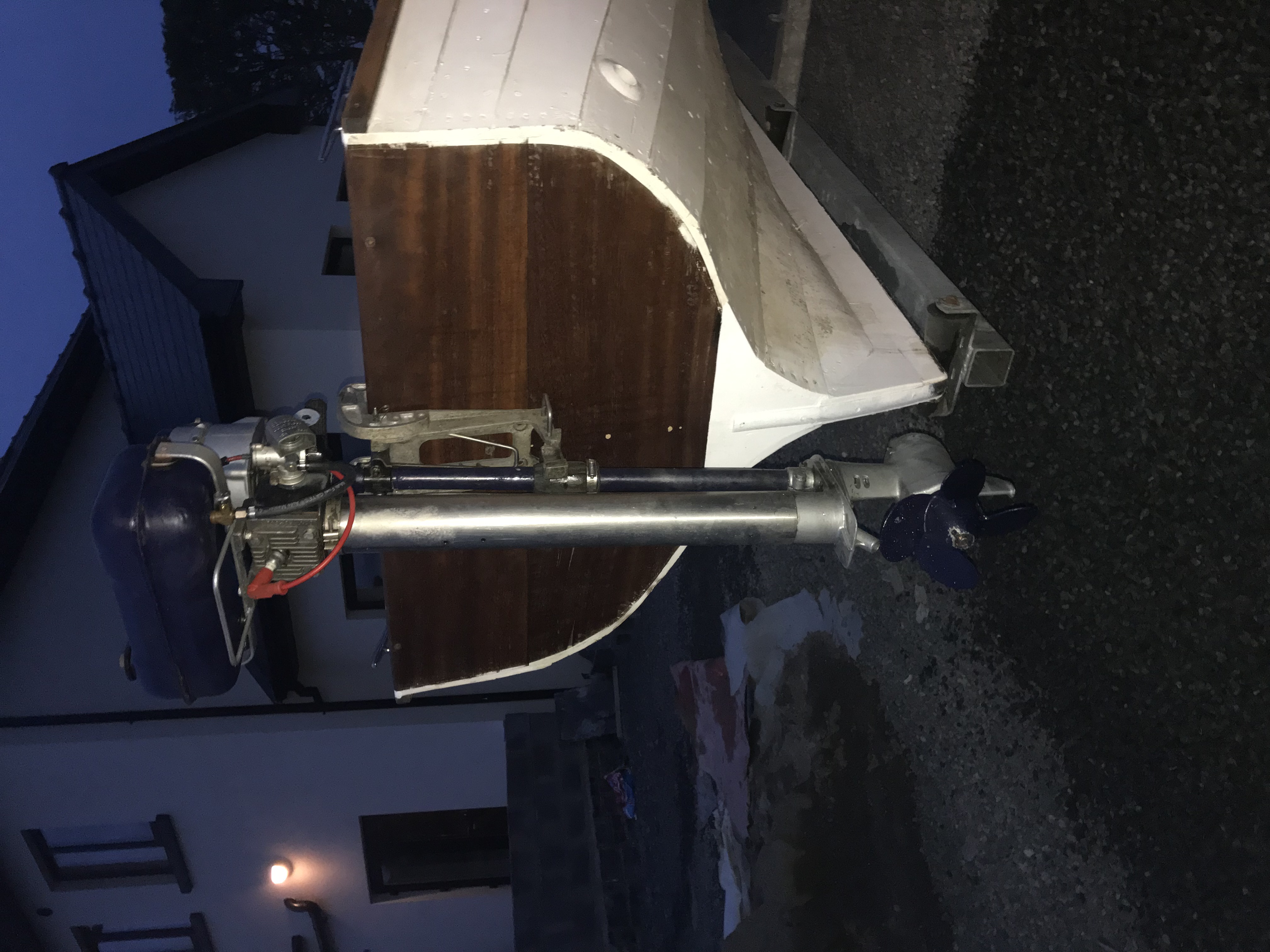

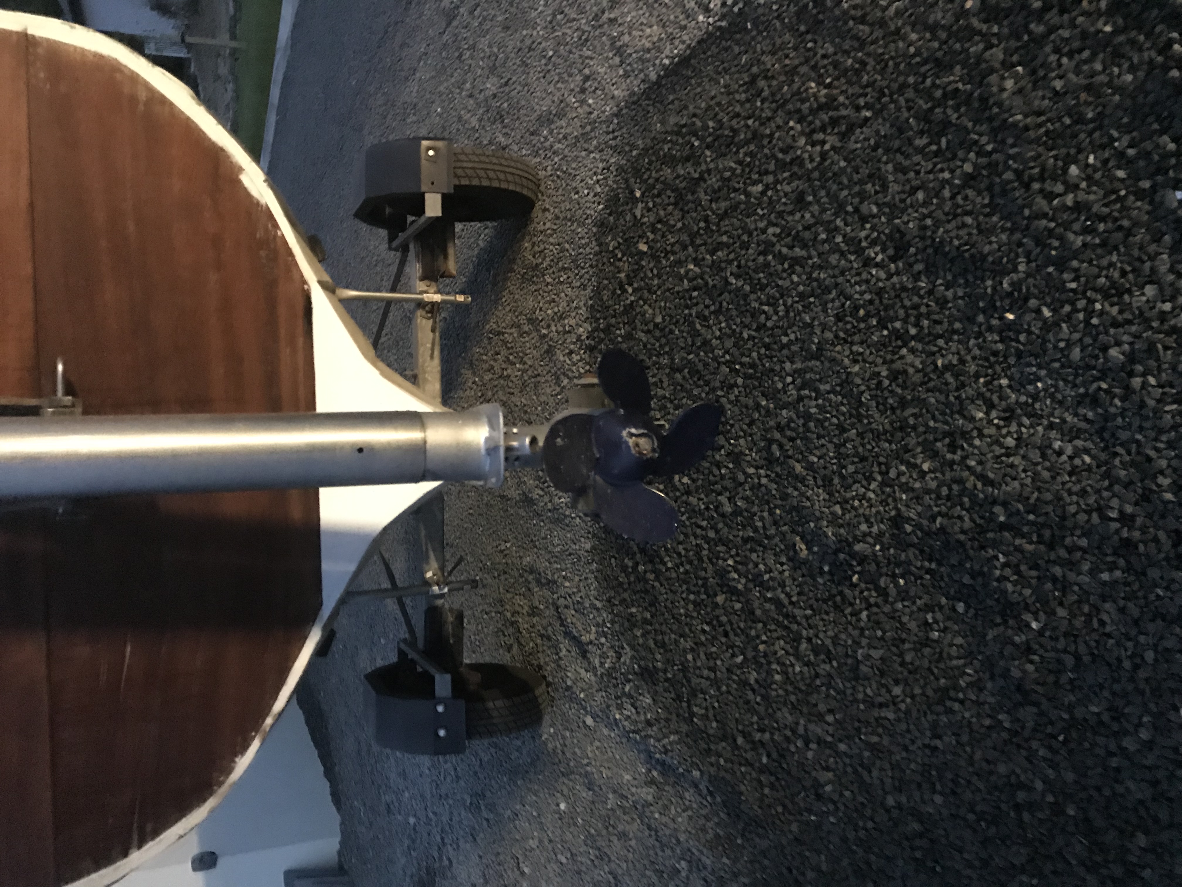

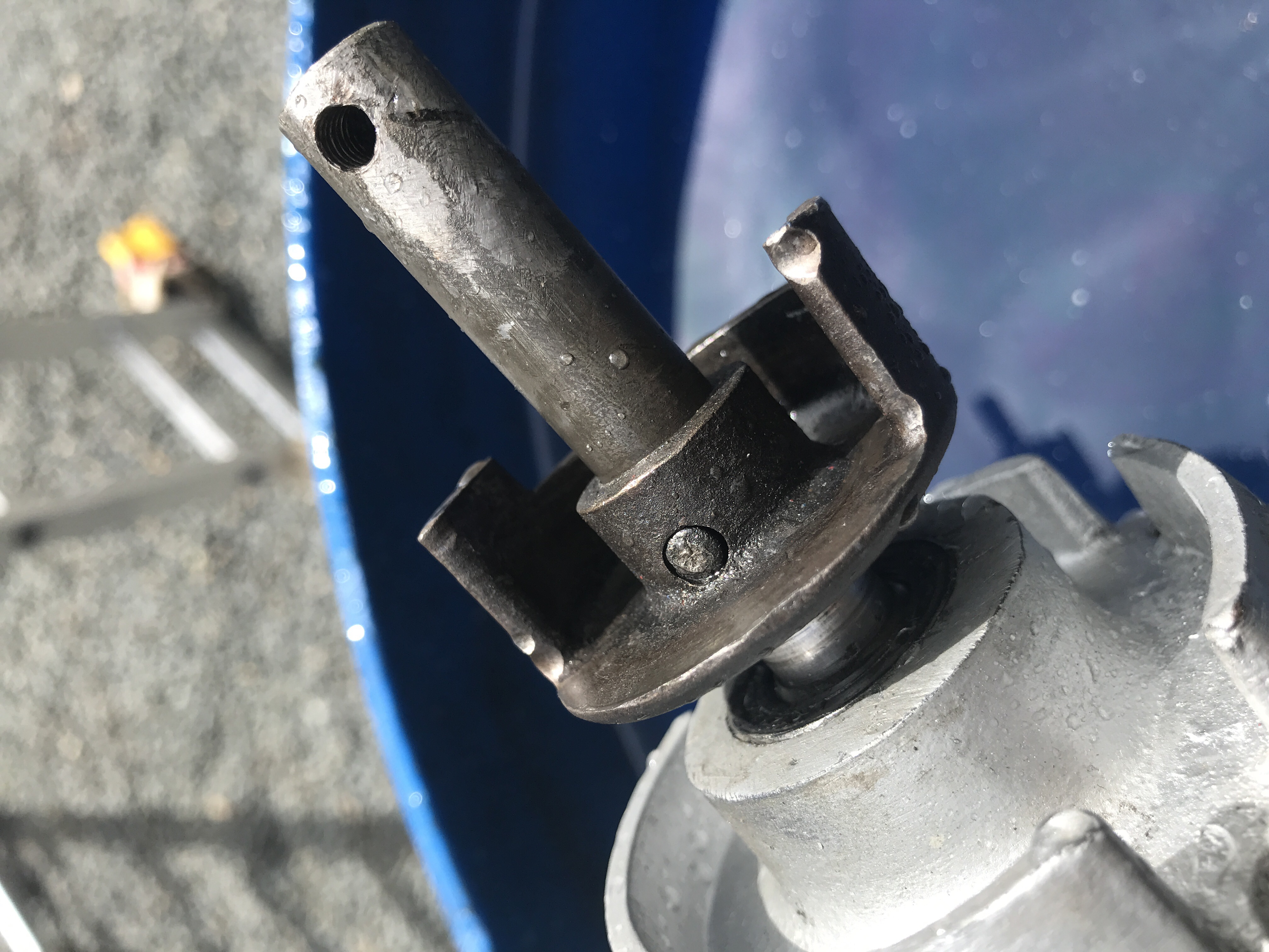

Well, before I took the plunge and stripped the gearbox again, I did a quick run through.
I have modified this engine to be 9” longer than standard.
It is now 38” (965mm) from the transom to the skeg.
This gives me clear water to the prop and keeps the intake under water if I move forward in the boat!
The result was too much back pressure.
Holes drilled in exhaust and now it runs sweet!
