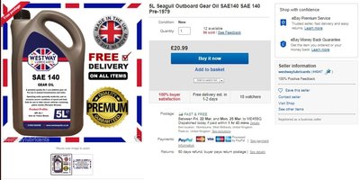

Re: Gear oil and two stroke
Has anybody tried this, not a bad price & delivered!
Thanks!

I have bought some but confess I have not used it yet. Give me your address and I will send you a free sample so you can evaluate it. You have my email address.

Martin and others.
Your link to westway lubricants is exactly the same stuff i use in all my seagulls. I've been using this for a couple of years now. Good stuff it is too.
It readily emulsifies with water as per seagulls specifications etc. and to date from using this oil i have had no problems. No rumbly bushes or noisy gears, and more importantly not much oil loss when my motors are in storage for months on end.
They do 90 grade as well for the newer type gearboxes, and for my money they're quite reasonable on price too.
