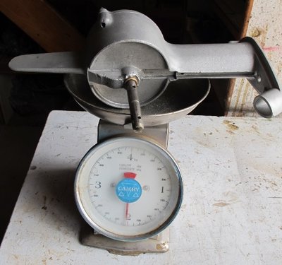

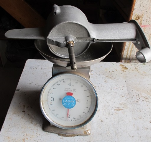

Thanks on the advice on the locating screw as I was wondering what the spare hole was for?Charles uk wrote:Cast aluminium is less brittle after annealing.
And make sure the pinion bush locating screw is doing it's job properly & the crown wheel thrust washer is in place!
In the Seagull Owners Spares book, circa 1980, page 40 and section 3 shows the drawing for the 12:30 gear box and item 25 is the screw your talking about?
It might be as well to check the condition of all of the bronze bushes in this barge pusher lower unit, especially now you've bead blasted them, something I've always thought was the kiss of death to bearing surfaces!
If this box needs all new bearings, thrust washers & even just a pinion it's probably beyond economic repair by a long way!

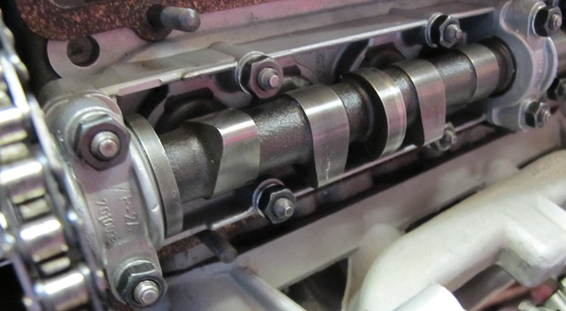

Check the R17 Rootes Hillman Imp competition camshaft in an engine that I rebuilt, the surfaces where cleaned with the same machine and came out perfectly.

Cleaning is the key, I have put just about every part of the Hillman Imp motor into the cleaning cabinet, many engines included, no issues.

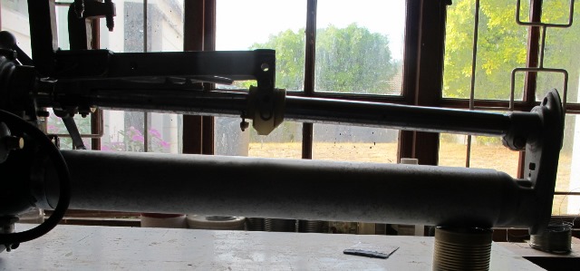

I will require a water pump body which allows the two down tubes to be parallel, is this possible?
