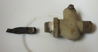

This tap was soaked for over a week in petrol but still remains blocked.
I thought to drill it out via the threaded opening but it seems the fuel drain hole is offset and near the back of the gallery?
I then made a pointed pick, that did very little?
Does anyone have a method to clear the blockage.
What about a small hole in the filter screen, drill via that then solder the hole up?

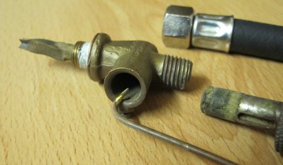

Re: How to un block a fuel tap ?
How about unsoldering the gauze filter and get in from that end then resolder filter back on..
- Posts: 395
- Location: Hout Bay
I did wonder how that filter was attatched?
If it is solder that is the way I will try it in the morning.
Right now the assembly is in a bath of Oxalic Acid.

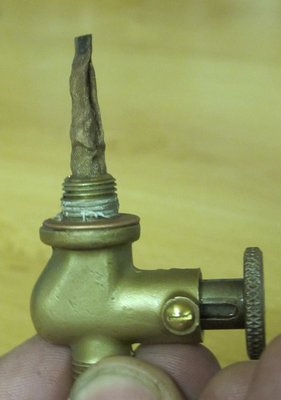

A gas flame from our kitchen cooker melted the solder, so now I can drill it clear, can I solder it back in ?

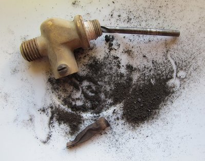

Blocked is not the word! how did this lot go past the mesh filter I wonder?
Check the angle of the 3mm drill bit.
JB Weld can be used on petrol tanks so I may fit the wire filter tube in with JB Weld epoxy?

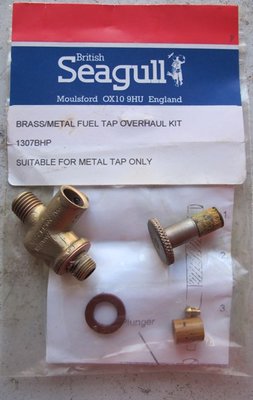

The brass body and the plunger have now been beed blasted clean, next is to fit a service kit to ensure the tap does not leak?
