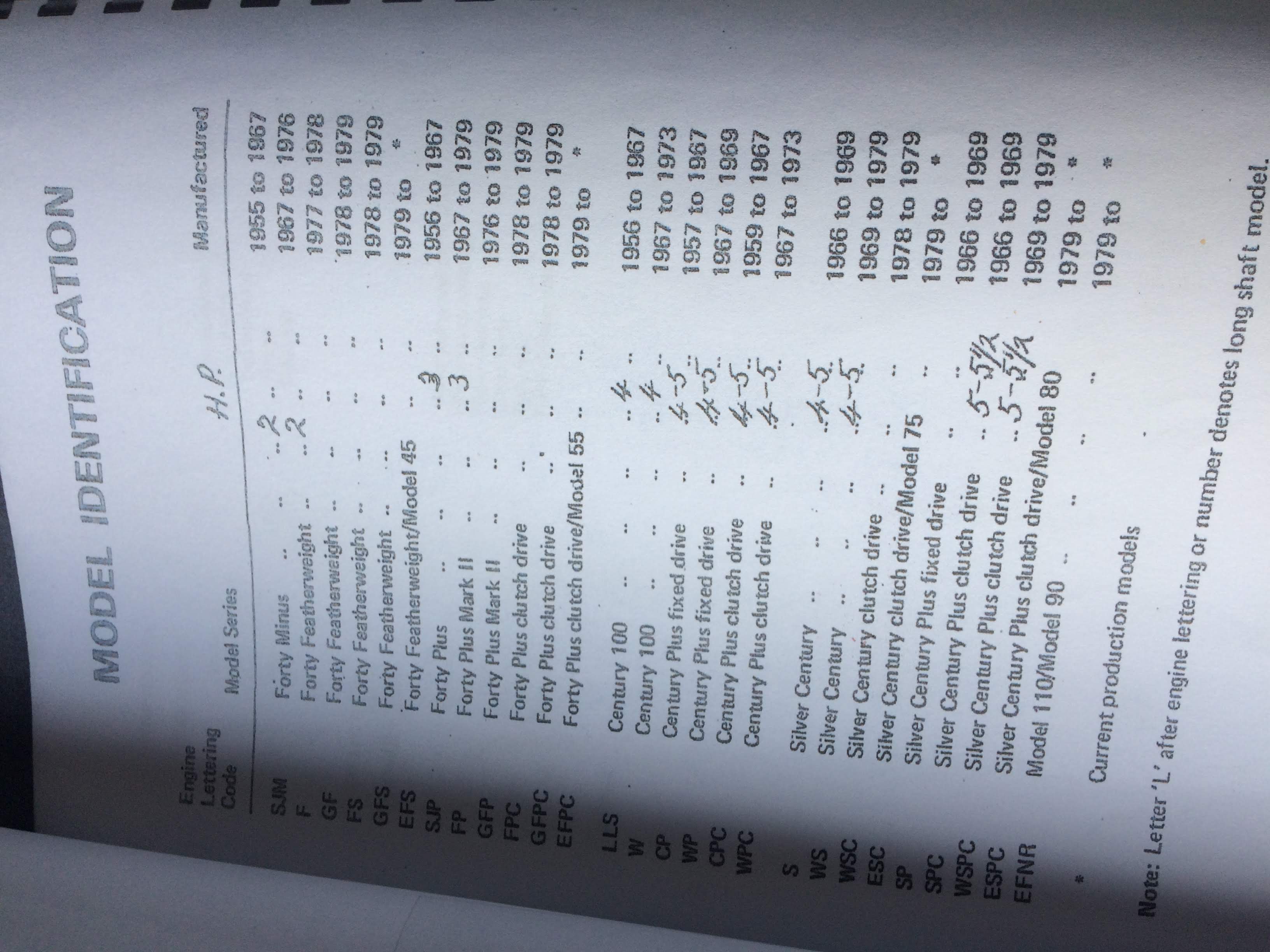

I believe this is a fourty plus (at least the prop says that) There are remnants of "gold" paint on the flywheel and was manufactured May 1973
serial number FPL 747EE3
Re: Found it in the River...
If I knew where the addition number was I would tell you!
British
Seagull
Service. Repair Handbook
2 to 6hp Models
I can only guess 1979?
British
Seagull
2 to 6hp Models
