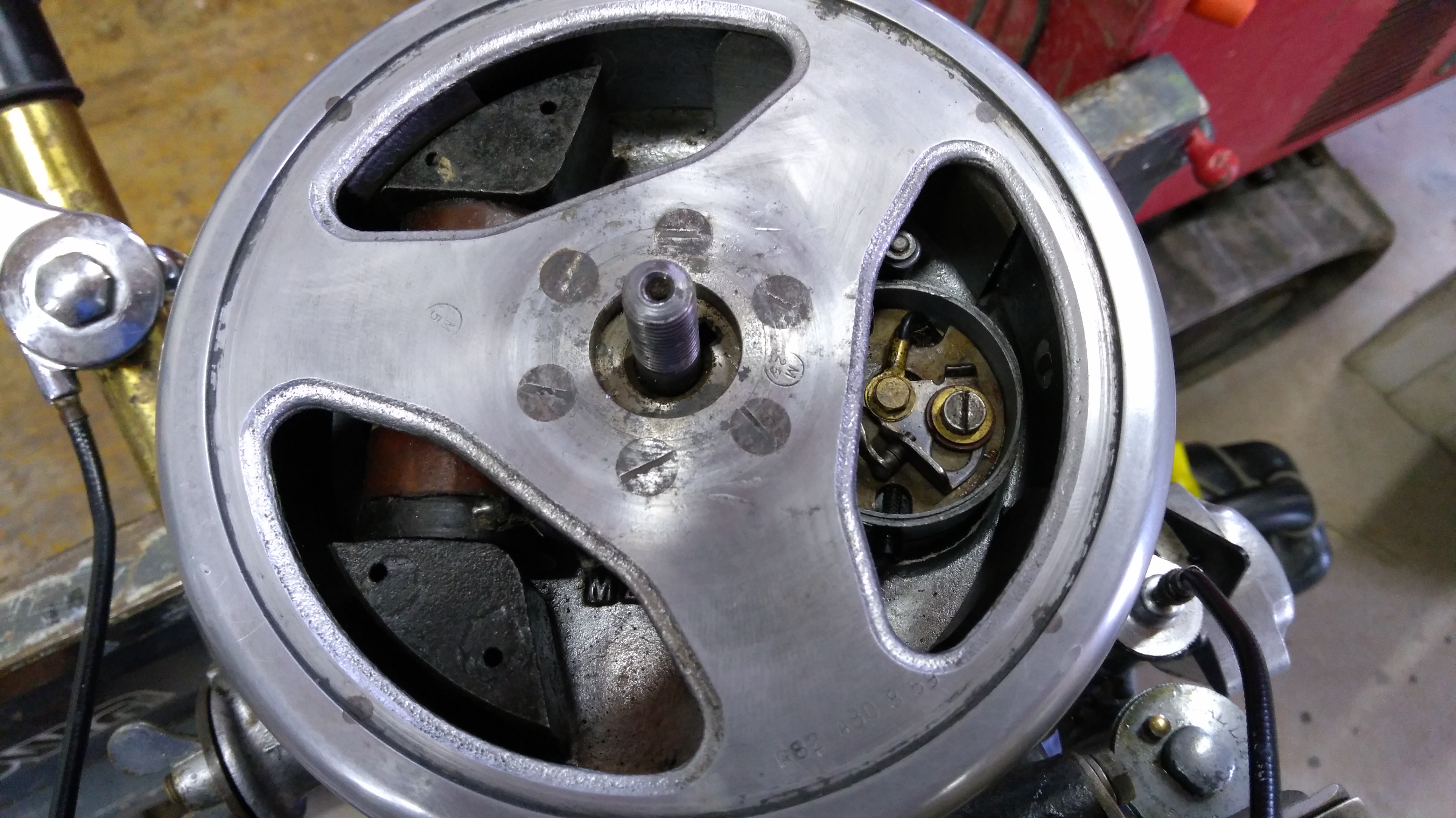

The wire from points to coil is almost gone, the flywheel is so stuck on that the hammer method doesn't work. Heating it doesn't does the job so I'm going to try a pulley puller.

If you use a puller tool there is a very good chance you will damage the flywheel, search the earlier posts!

Okay I will try again after a can of WD 40 thnx
Re: Doesn't start when warm
Kalkman007 wrote:Okay I will try again after a can of WD 40 thnx
Warm it up with a hot air gun, suspend by flywheel and use quite a big hammer, sharp hit don't tap it.
A spare nut is useful as you will damage it.
Give Tam a shout he has spare nuts, or even a flywheel.

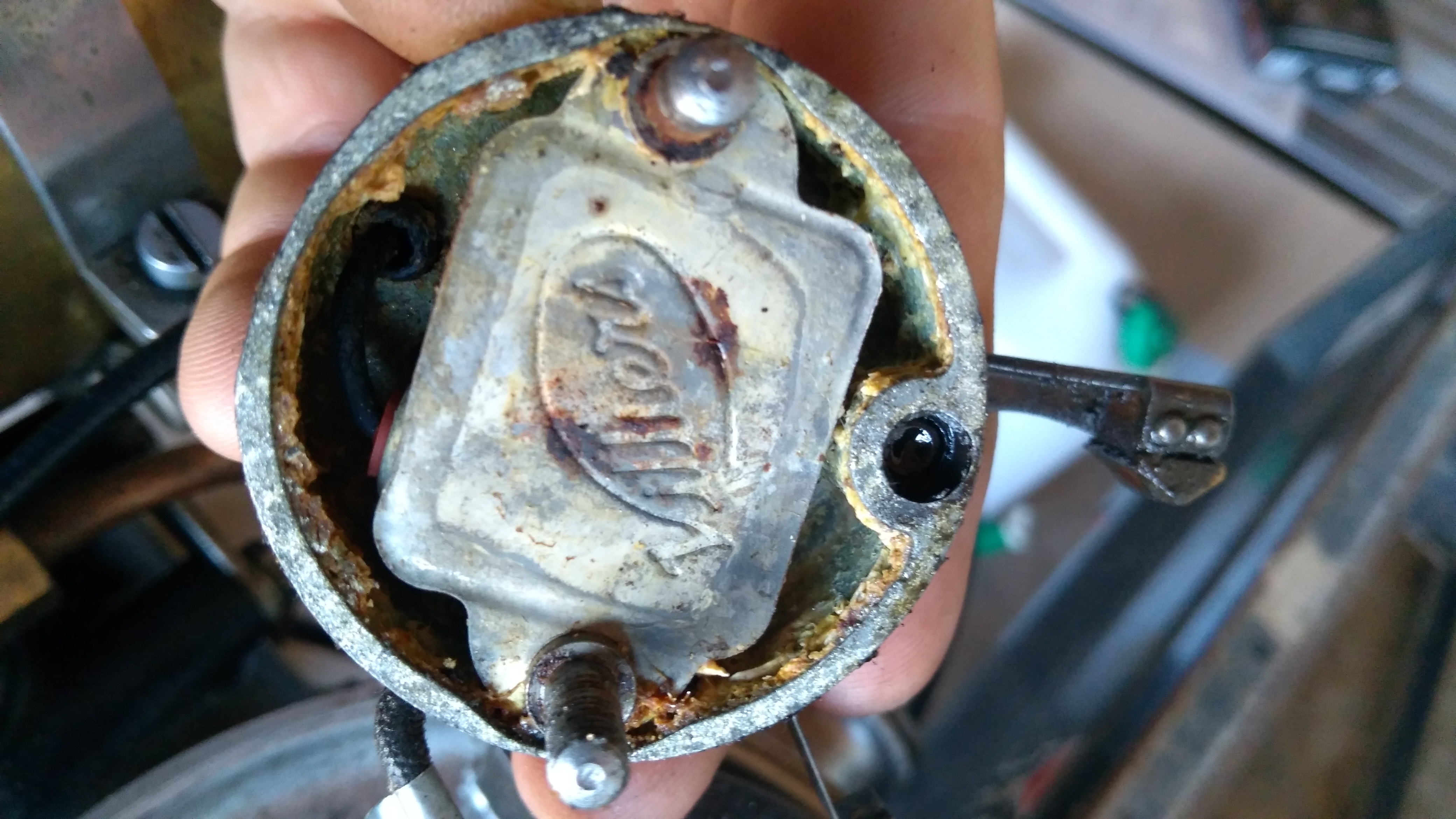

After soaking in wd I've hang it to the sealing and gave it quite a few bangs. It came off with a grunge. The resistor is corroded and the coil very old. Where do I buy a replacement??

Thank u, i bought a new coil and point box, the old one was really dessolved.
Yup! That looks a bit crusty!
