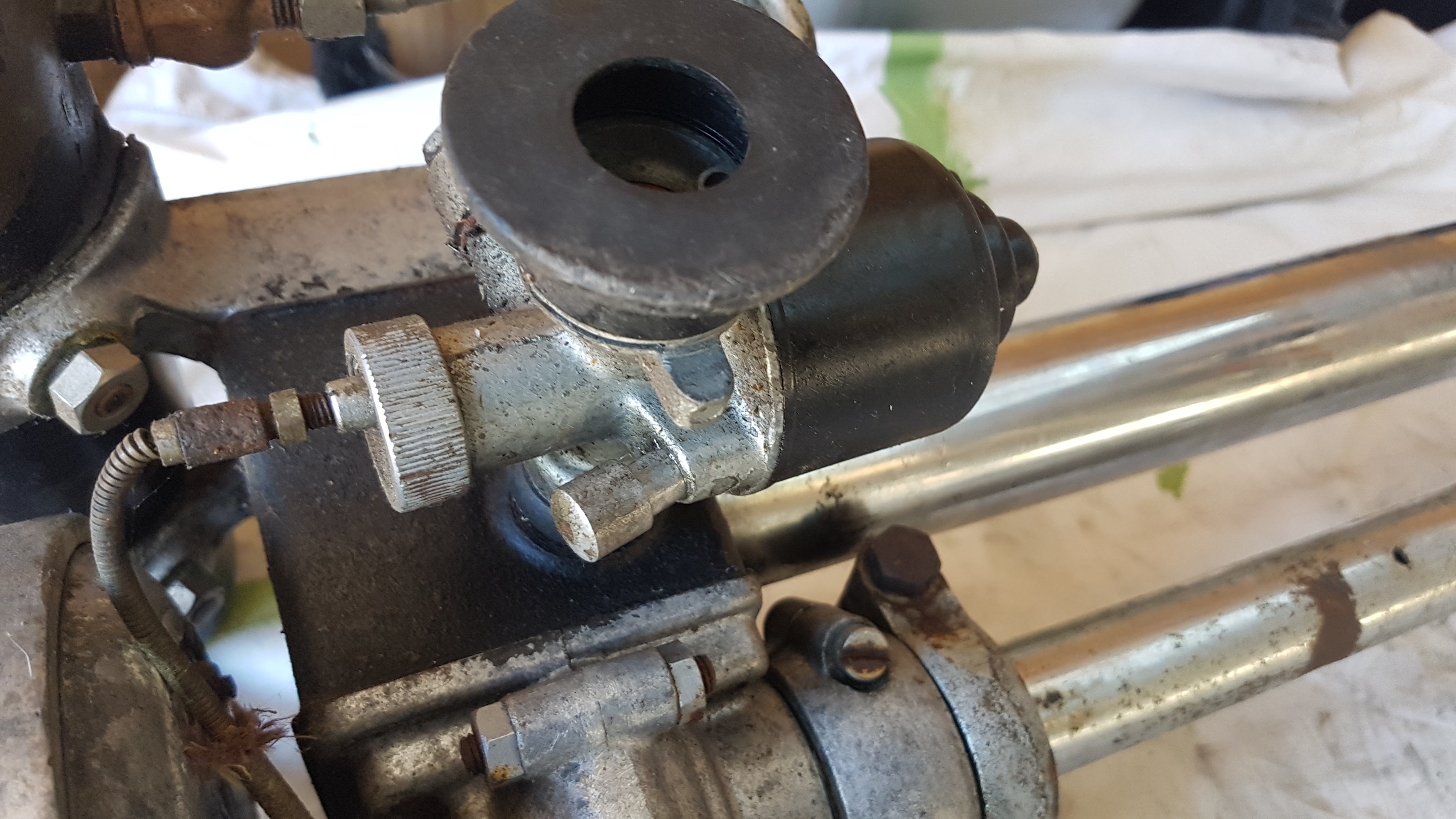

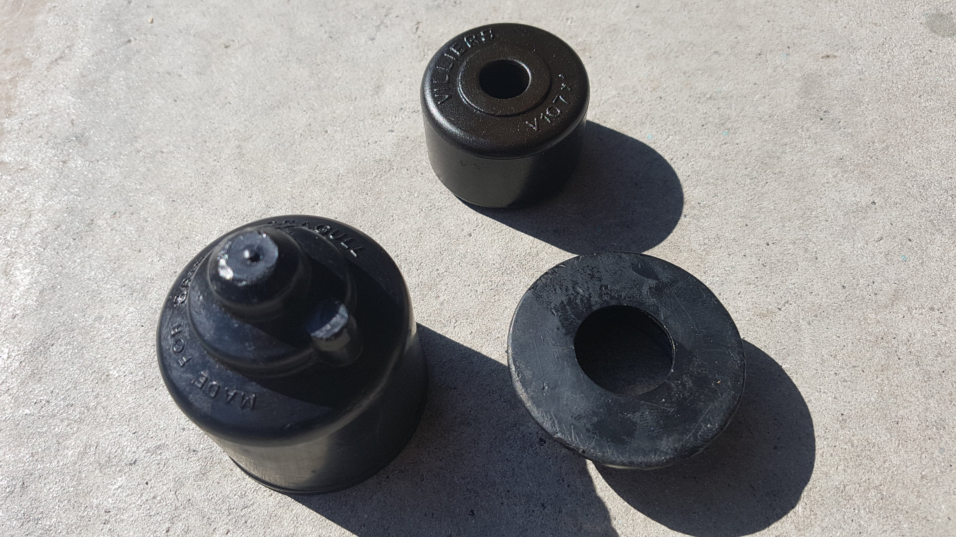

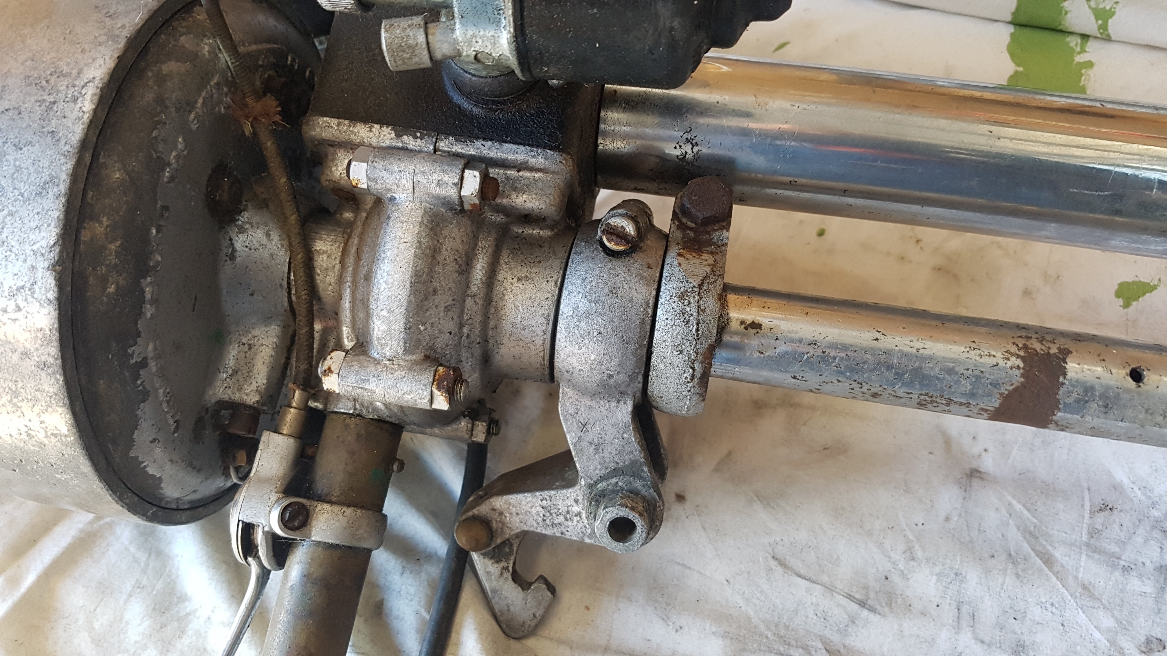

Some general pictures as the stripping down gets underway. No surprises so far. Gear box has turned out to be in good condition so the no turning issue is in the powerhead unfortunately. Flywheel came off without fuss but the ignition base plate needs careful persuasion. The carby plastic parts are rigid, like Bakelite. Does this look like a case of a much later Villiers Carb or was there and early type like this one?
Re: 1951 Little Forty FVP7383 manual or parts diagram
The carb is a much later addition. The carb which was fitted when BS produced the engine would be an all metal one, with a 7/16" venturi. The choke would have been on the other side. It would have a steel float chamber bowl (without the later drainage hole near the top) and would have had a throttle stop. Photos of these details are in the Notes to the data list that I will e mail to you. But here is one photo of the carb:-
