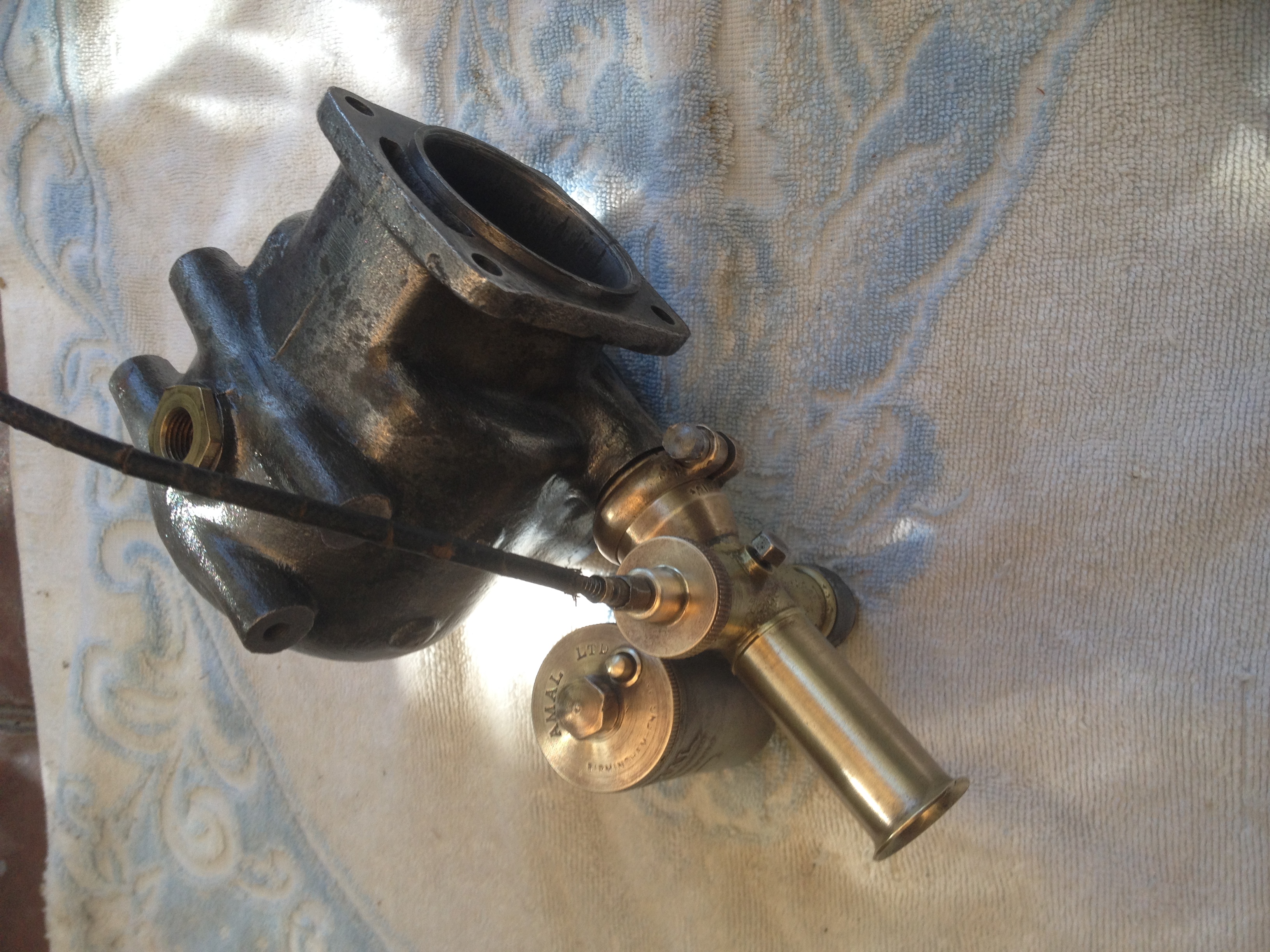

Attending to the carburettor and magneto.
First two image shows extent of the hornets nest, carburetor intake completely blocked up and amount of mud removed ie just from the carby.
And after a bit of a tidy up. Carburettor doesn't clamp up tightly against the intake, so will form some thin sheet of brass to take up the slack.
