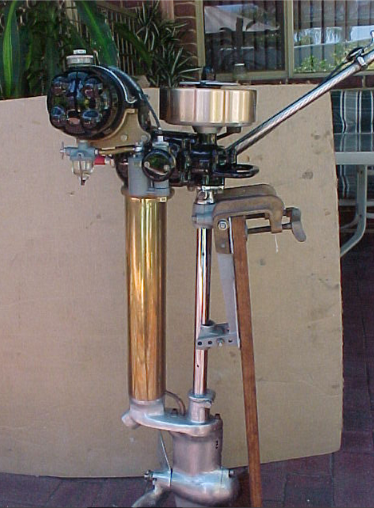

One inside the tank attached to the top of the fuel ewart fuel tap and one where the fuel pipe attaches to the carb at the banjo connection. I believe Rick and I thought that (at least some) the Curlew didn't have the tap filter (plastic tank). Other QB's?
Yes, I run a small lawnmower type plastic transparent thingy filter on a '47 102 with no problem.
Also the Australian Olympic Seagull had a glass bowl.
Courtesy main SOS site:
