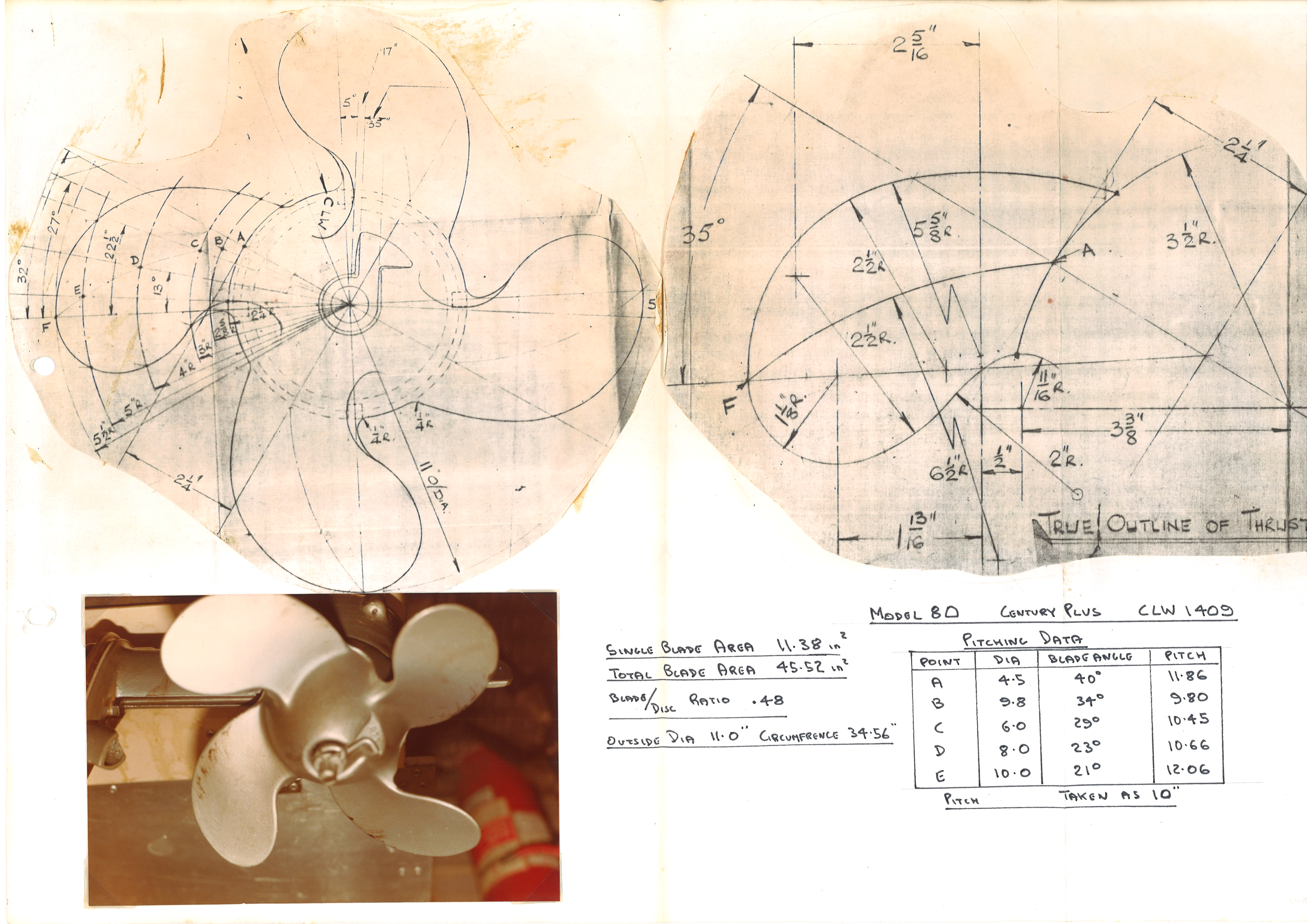

What is the pitch on those props?
Re: Not really the right seagull?
11" diameter x 10" pitch.

Charles, how did you work out the pitch?

I didn't Keith, both the other Charles & I discovered when you go to interview people about Seagull history you find some that will say "I was going to throw this paperwork away, but as your interested you might as well take it".
The moral of the story is, if you don't talk to people you get nothing.
This was taken from a report about a series of drawings of current Seagull props in 1986.
So I didn't have to spend an hour calculating it!

If you do the calculations from the data in the drawing I posted you will see that with zero prop slippage you would achieve 2.08 knots (2.36 Mph, 3.77 Kph) per thousand engine revs!
