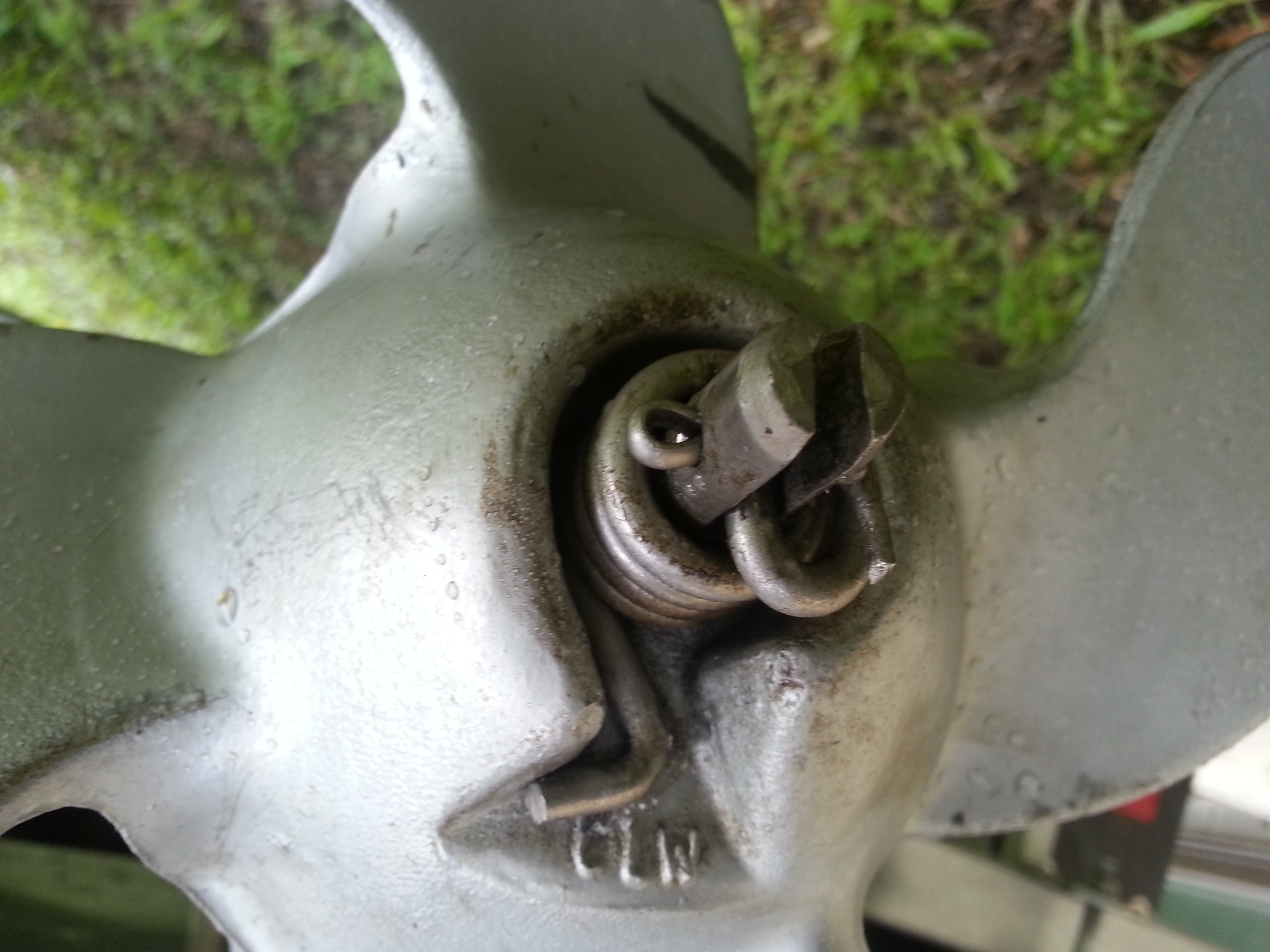

Can you post a picture of the propeller?

Charles uk wrote:Can you post a picture of the propeller?
Yes I shall do that in the morning :)
On the boat yes?
Re: Not really the right seagull?
No we need to ensure you have the right lower unit & the right prop, "revs it's tits off" is an unusual description for a Seagull.

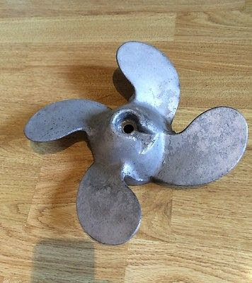

Ok. So I'm not at home so can't take a photo but a quick bit of research revealed this... (hope this works )
So that is what the foot looks like but not the prop.
The prop looks like this. ..
So I have a 'weedless ' on there? Is that 'wrong '
I will still snap that pic for clarification.
Al.
Your prop should have "CLW" cast in the spring notch.
I've had similar woes with my 17 footer. My wspc originally had a weedfree prop fitted to it which i thought was pretty well suited to my particular boat, but when i fitted a hydrofan prop to it MY GOD it was awfully slow by comparison. Nothing wrong with how my motor was set up on the back at all, but the prop i felt wasn't quite right somehow.To see if it was just 1 rogue prop i tried 2 other 5 bladed hydrofans with similar slow results. Switching back to the weedfree prop brought things right back to how it was, pushing the boat to near perfect hull speed. Never a truer word said about matching the motor (or in my case the prop) to the boat. Mind you my boat is fairly heavy so i don't expect to go very fast with even the very best seagull on the back.
As you've suggested i'd look for a nice 40 plus which might be better suited to a smaller boat like yours.
So Jon...
I'm just asking to get this correct in my own head.
Are you saying the weed free was better than the hydro fan? Or the other way round ... the hydro fan was better than the weed free?

Anyway. Sorry for the delay , my phone went for a swim. As promised, here are some pictures (excuse bad camera on phone )
Prop
Prop
Prop

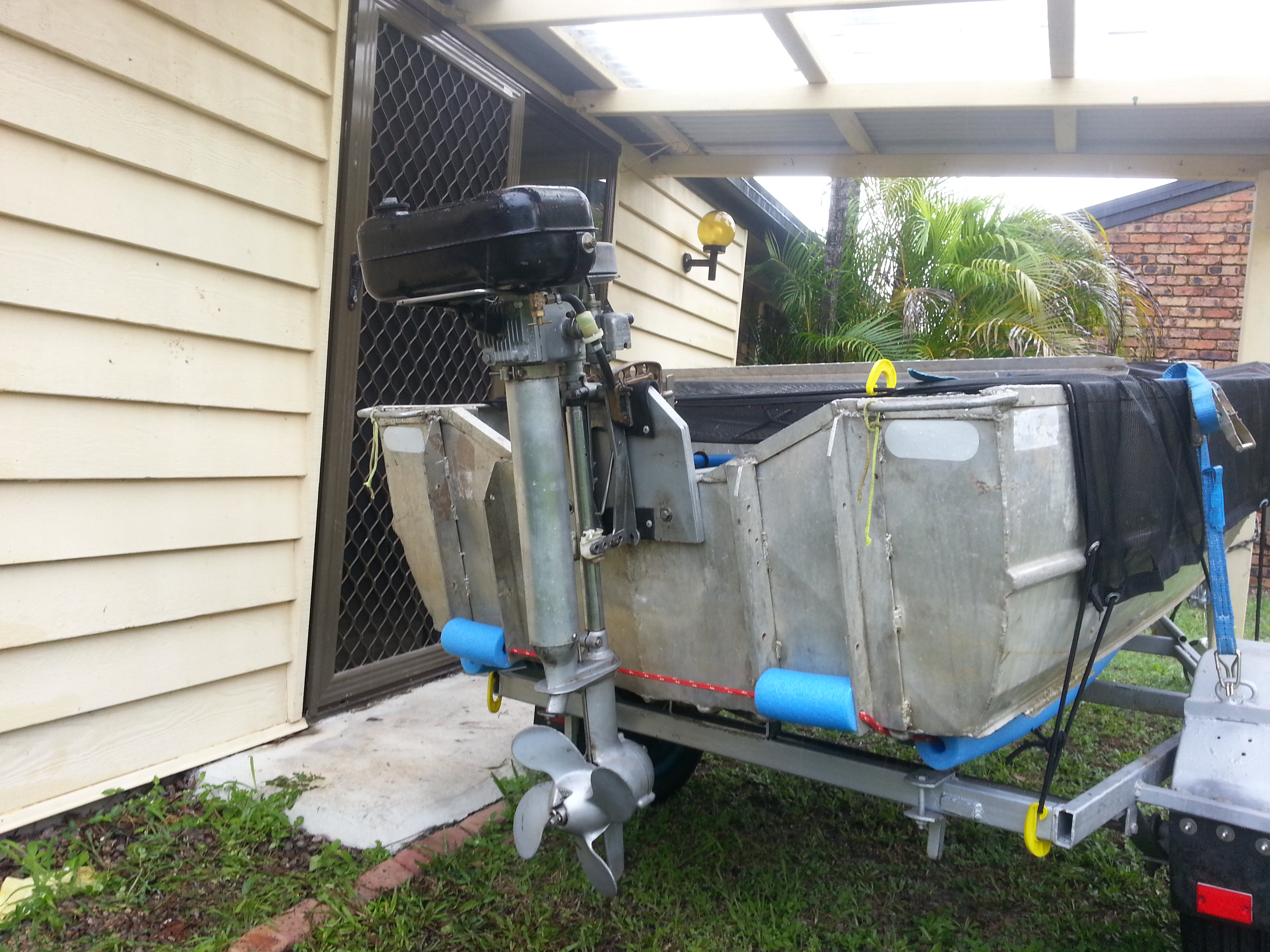

Current height
Current height

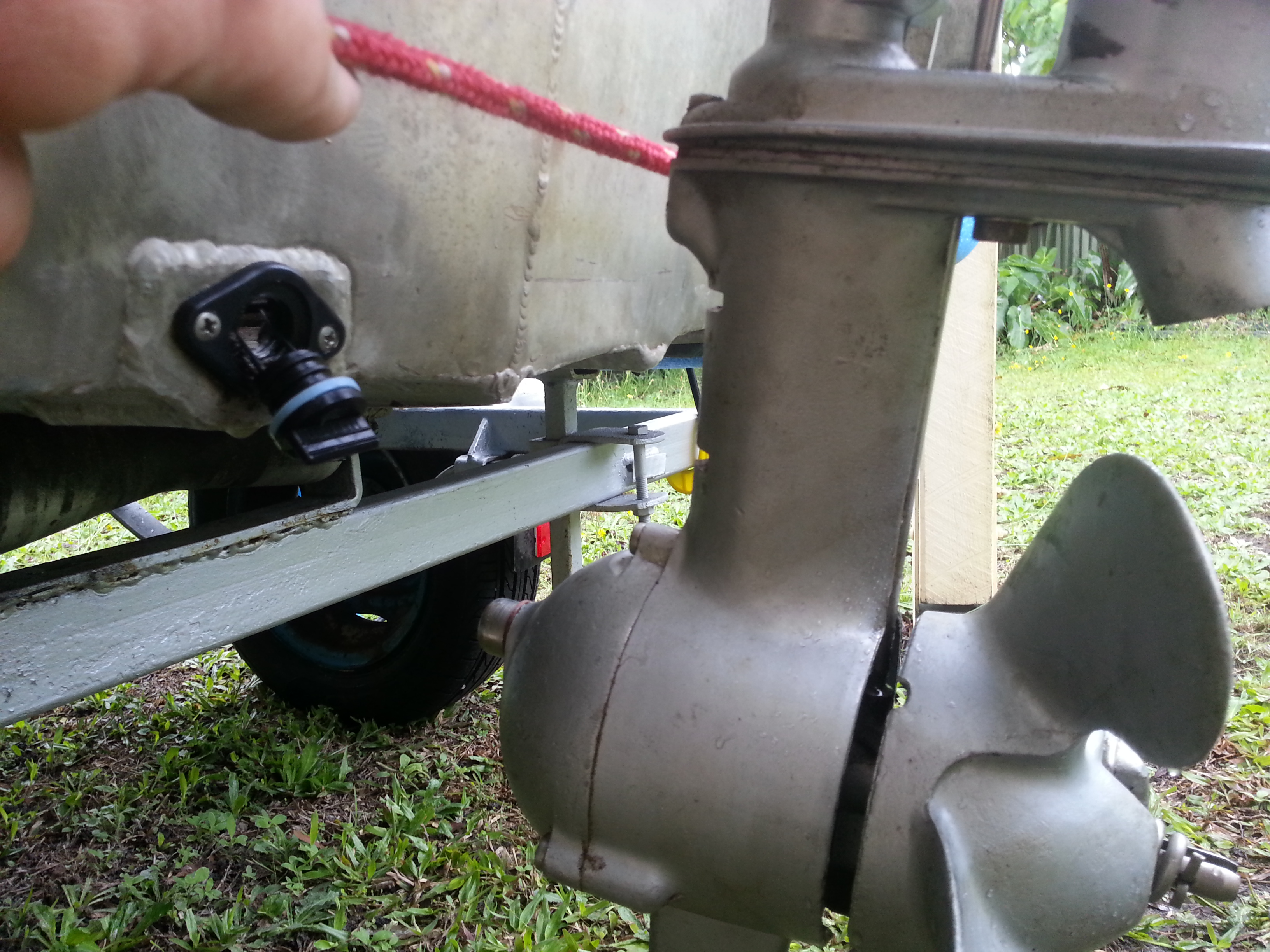

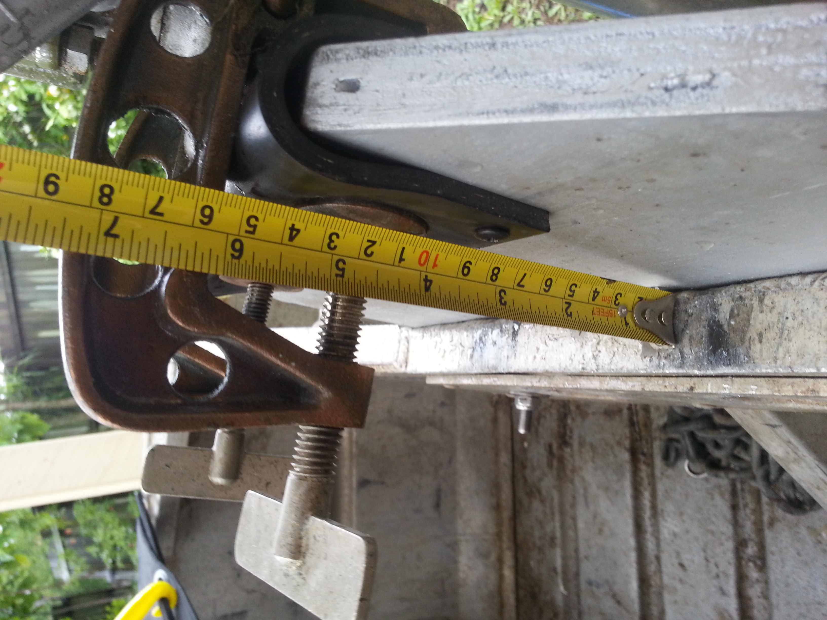

I have been experimenting with different mounting heights . This is where I am currently which might be a little high as...
Water inlet.
Water inlet.
The higher cooling water inlet is above the bottom of the boat (although still well in the water)and I am no longer getting my nice thick water flow right through the rev range.
As you can see though, this is a fair bit higher than I originally had it on the boat's standard transom.
Above transom.
Above transom.

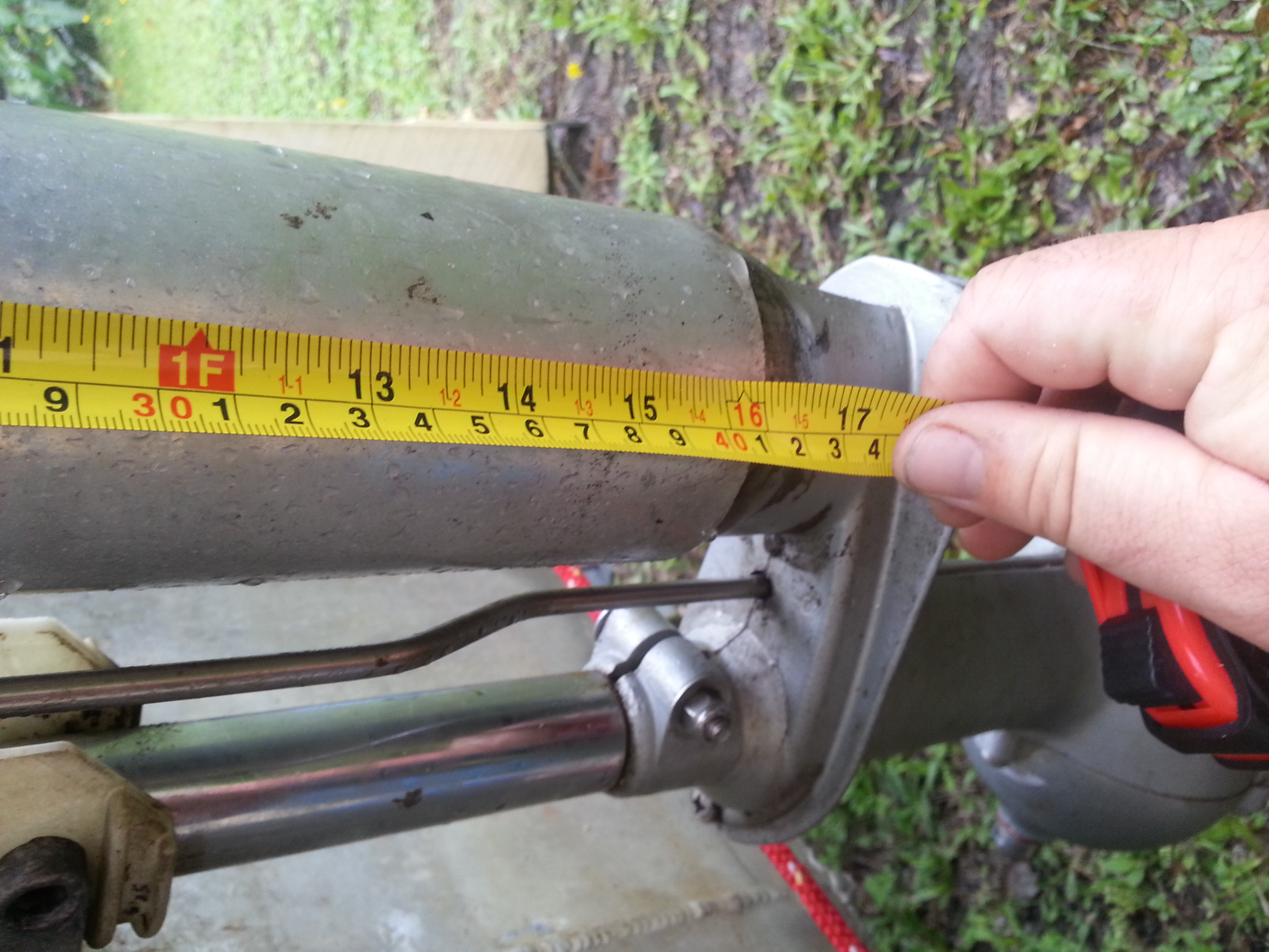

Also. Here is my exhaust tube length. Is this a standard long shaft or has it been modified?
Tube.
Tube.
Apart from seeming to effect cooling flow, where I currently have the motor will get me a choppy 8kmh one up in the boat. That's just fine but I want to fine tune. :)
I don't know much about boating but I reckon that even if I invested in a modern 3.5hp unit, I probably won't go much faster. Anymore than 4hp here in Queensland and the boat needs to be registered. Any more than 6hp and I need a boat license. These are both expenses I don't need for my tiny 10ft tinny fishing setup.
Also. .Thoughts on this.. I want to put a peice of air filter sponge material over the storm hood to reduce induction roar and also put a couple of hose clamps around those holes in the exhaust tube. I reckon that will make it quieter without much detriment to reliability or running? ??
Al.
Blocking the holes in the exhaust tube will make a big difference!
Not sure what putting foam in the carb will do.
There is a 5 blade hydro fan that will fit that gearbox that Might make it a bit quicker...
There is a pic of one in this thread. (first pic of a prop)
viewtopic.php?f=2&t=5592

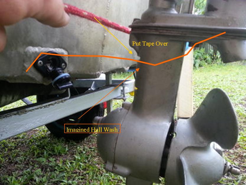

"The higher cooling water inlet is above the bottom of the boat (although still well in the water)and I am no longer getting my nice thick water flow right through the rev range."
Ok do as below and try again......
[/color][/b]
