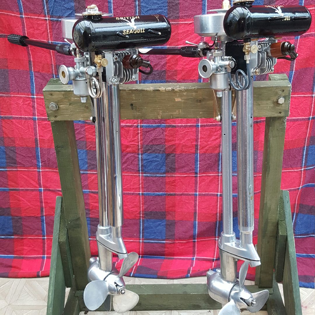

I Always used to forget to take a picture when getting another motor in the collection, its a good point to take a picture, especially before some big ham fisted Scotsman gets his hands on it.
Re: LS in USA
Re: LS in USA
Very nice!..... But I see a ding in the exhaust pipe... That will need fixing

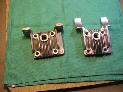

Well it has been a while, but the new cast cylinder head is now machined ,and the Power head assembled with new copper gaskets top and bottom of cyl.
Assembly can now proceed , with many details still to be worked out. Next will be assembly of drive shaft, water tube and exhaust tube, + Gear box.
More pictures to follow. Picture is of an LS head and an FVP head. machined. I have made one extra each , in case someone has a need. WB
