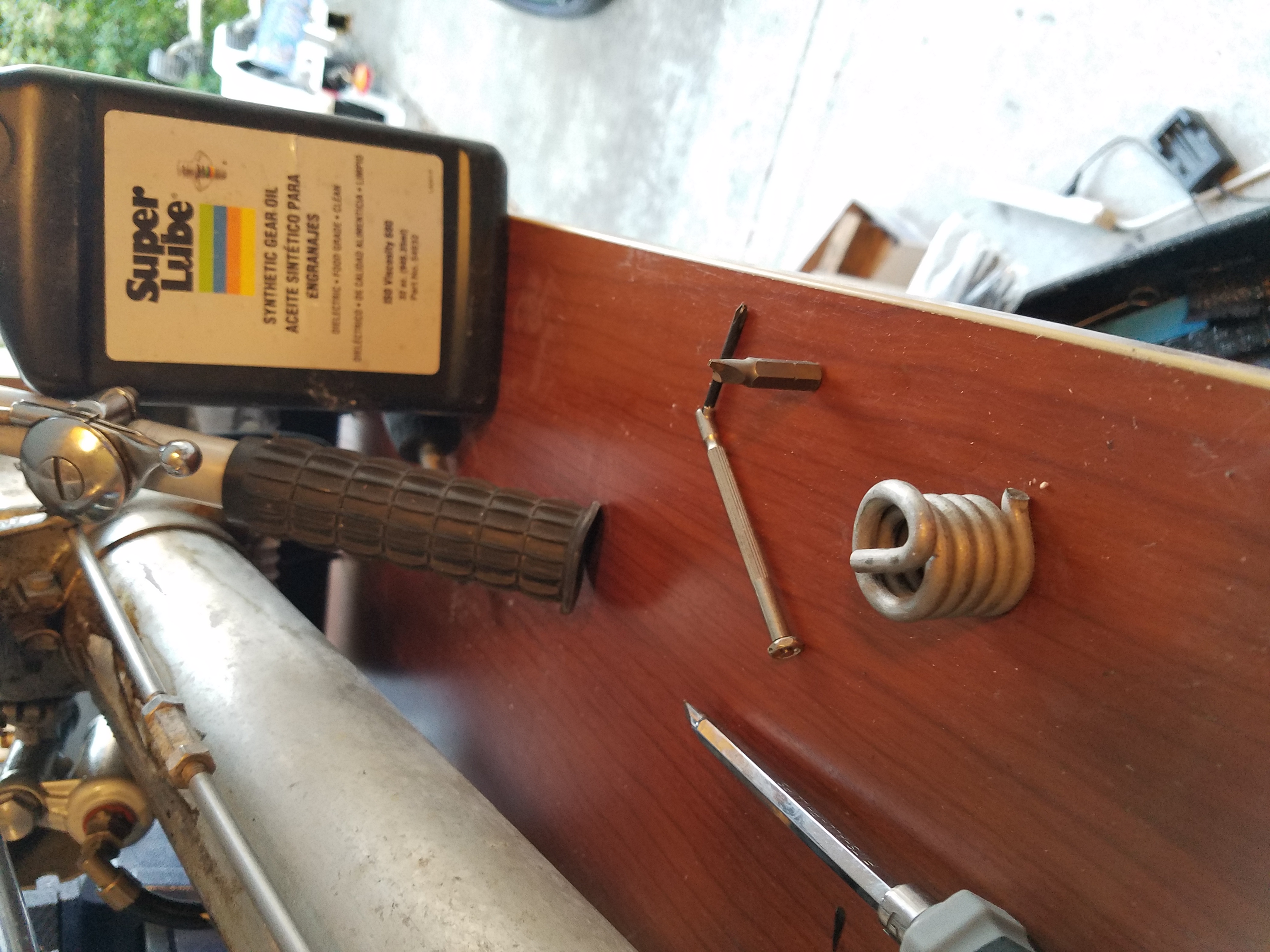

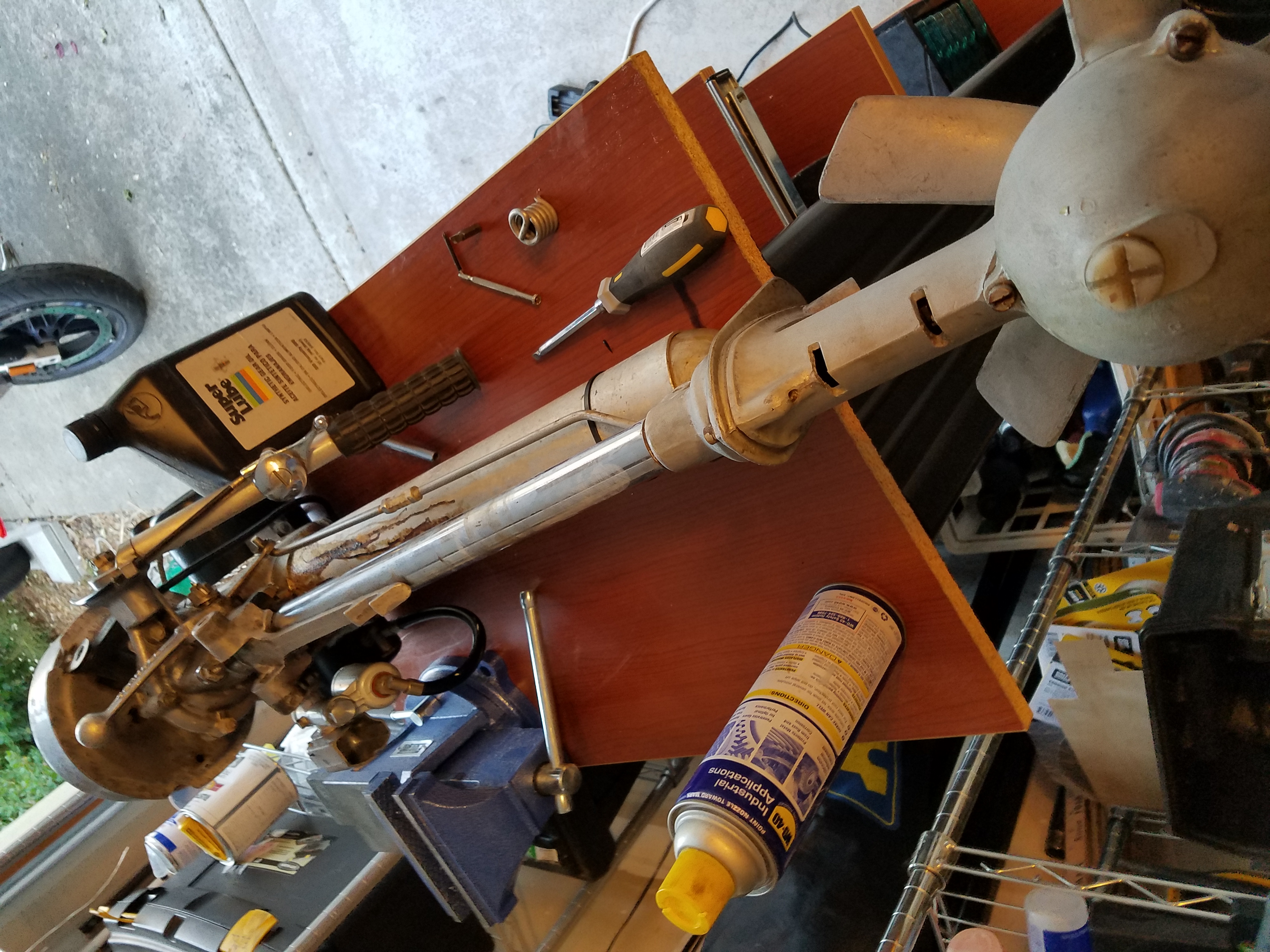

Thanks all, you can tell I'm a newb - it was the spring! Pics as promised, including my tool casualties (was going to take off gear box cover vut decided against it).
Also, how do i remove the prop (if i wanted to)? Just pull harder or is there a trick?

Same springs best ordering from John (s.o.s )then you know what your getting

The prop will slide off with a bit coaxing. Sometimes the slotted bit of the shaft widens and needs to be closed up a tad.
