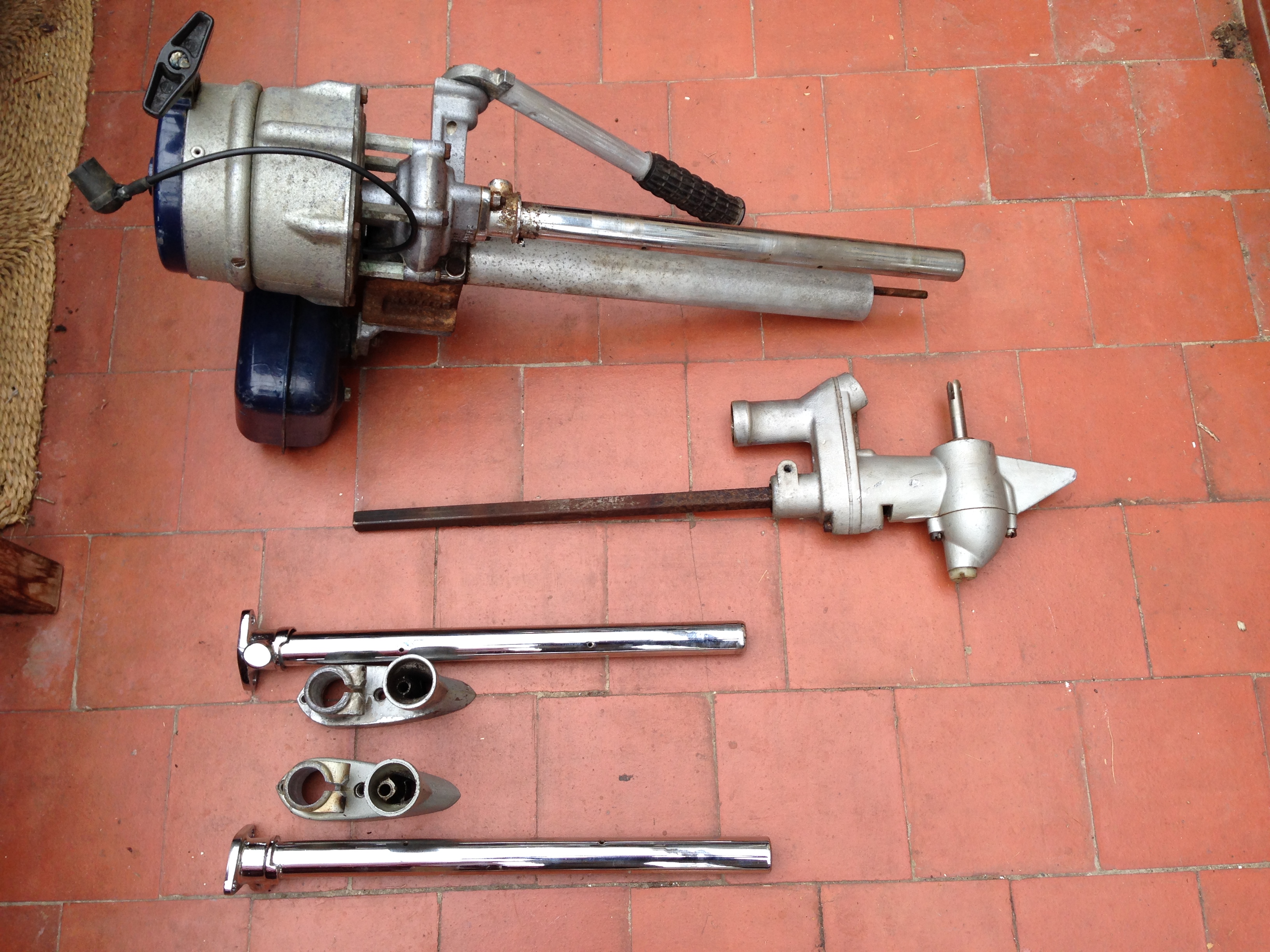

Photo attached. Engine is EGF 506FF2
Measurements
EGF tube still attached 1.123
EGF housing ditto 1.119 - 1.124
spare chromed tube 1 1.124
ditto 2 1.123
spare housing 1 1.123
ditto 2 1.132
Armed with the idea of the reversed bolt, and Charles's standard of 1.125, I think the penny might be beginning to drop as to how this was intended to work - correct me if I am wrong. If the tube and the housing are roughly the same diameter, and you then have a way of easily widening the housing (reversed bolt) then the assembler widens the housing enough to allow the tube to be fitted, then relaxes the bolt, which tightens the housing onto the tube, with no bolt present - the metals are then doing some of the work for you, by elasticity. Reversing the bolt to its rightful position and tightening then completes the job by adding more tightness.
Re: Drive casing into water pump housing
You got the idea 100% :P

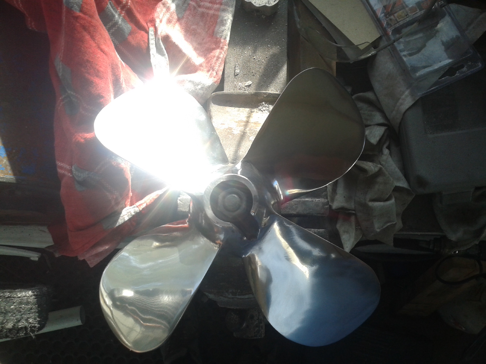

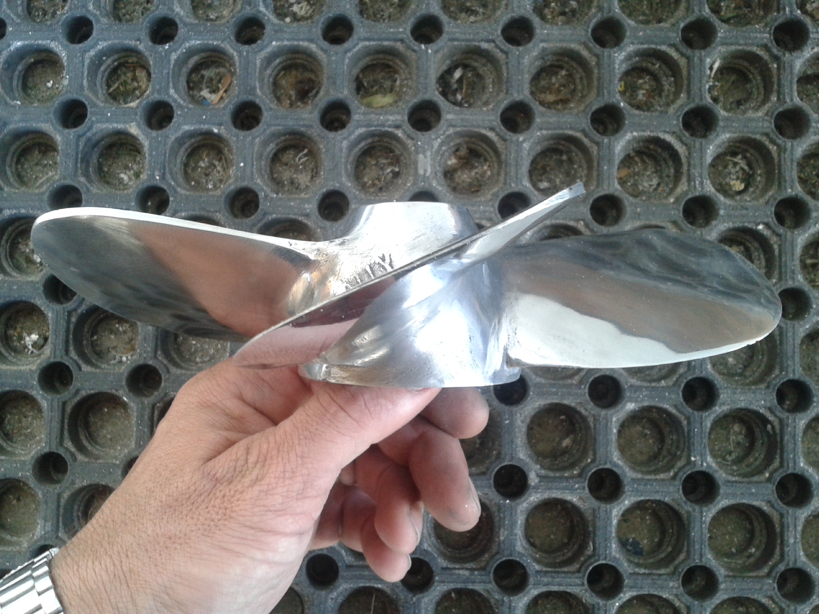

What a beautiful prop – what engine is it from?
My one!! :lol:
It is off an LLS. I use it on a silver century. It only took me an hour or two to clean and polish it up! :roll:
I could have got it shinier but I was finding it hard to see!
