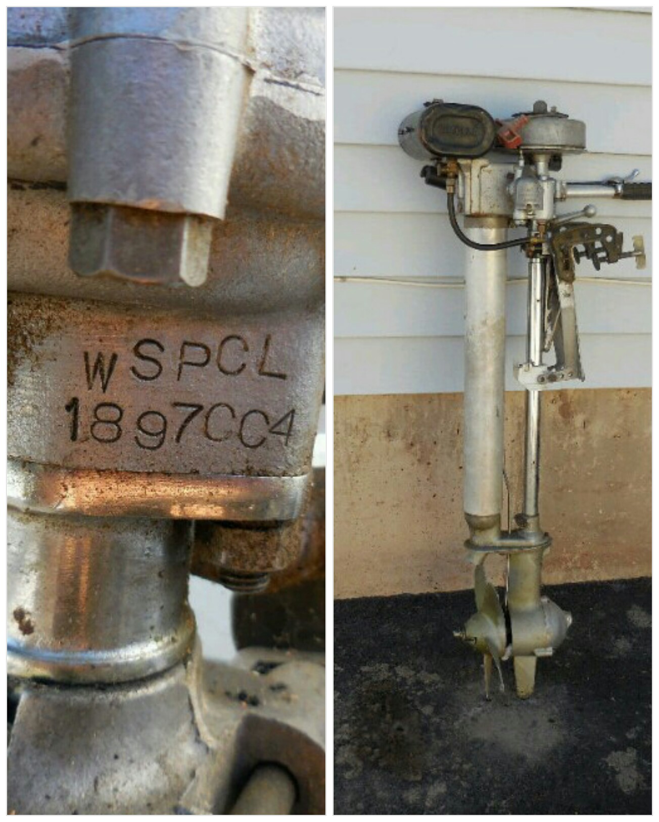

I just purchased a seagull outboard. It's serial need is WSPCL1897CC4. I think it is a barge pusher. It has a clutch that will put it in and out of gear.
Re: Bargepushers
Not a barge pusher, it's a Century plus, the same gear ratio but with an 11" diameter prop.
The Barge pusher is a nickname that's been awarded to a 102 with a 13 inch prop & a 4 : 1 lower unit,

Thanks good to know.
