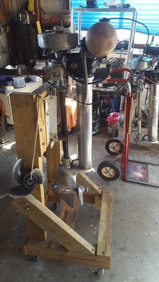

Hi I picked up a parts motor last Friday and then realized that I had enough spares in the shed to nearly make a complete motor from it.

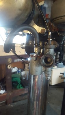

Spent a couple of days on it as I have the time being on Holidays and all :P . Anyway, There was no ignition system just a flywheel and base plate I had a complete spare Villiers ignition so put it on got good spark straight away very happy. Gearbox was soaked in diesel over night and came apart easily all the parts look in good condition. Stripped motor down all water galleries clean etc. Had a spare exhaust tube so I fitted that cleaned it all up bit of paint and polish and it has come up OK few irregular things on it that need to be changed i.e. throttle cable, needs a fuel tap can you find more? Like the silly looking fuel pipe :roll: If so please let me know :oops: cause I can't pick em all. Anyway. the issue is it came with an Amal carb attached which I have cleaned and it appears ready to go and I am wondering what the chances are of it running properly with this carby?
I am going to try and give it a run tomorrow in a drum and see what happens? Am I wasting my time?
Oh if your laughing at the mounting bracket the parts motor is mounted on I don't blame you its a bogie job I'll just remount it on the bracket the motor in the background is on if it goes on the tinny :lol: Pictures to follow

The Carby.........Closer pic and more detail.
It does look too "Thoaty" from a distance.

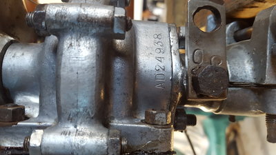

Hi here are some photos of the carb I cant find any numbers to identify it but then again I wouldn't know where to look :P

It will start in a tub but it is too big.
There are numbers stamped into it somewhere.......find them and let us know.
We can then cross ref and find out what the body was initially set up for.
What is the Diameter of the slide and what is the number of it. The number is the cut-out angle with the diameter you can now measure.
Re: Will this 102 run OK?
The number is usually just in front of the clamp ring that holds it on to the cylinder.
The throat diameter is the important dimension.
The only certain way to find out if it will work, is to put some 10 : 1 in the tank, clean & set the points & plug, check for a spark & wrap a starter rope around it!
It look like an Amal 361, but its not what is fitted to the little model F, Anzani pilot maybe.

Hi there are no numbers imprinted on the carb body at all. The twin jet villiers I have has the id stamped behind the collar that attaches to the block but not on the Amal anywhere. The carb slide has a diameter of 19 mm. Length at highest point 23 mm lowest point (angle) 14.3mm. Hope you have been practicing the hypotenuse algorithm. :shock: still a mystery?

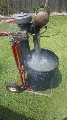

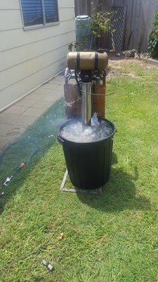

The answer is yes :lol:
With a lot of choke - hand over inlet rotating motor by hand - it started second pull but did not pump water :| whoops had a think and realised I forgot to flush out cooling pipe in exhaust tube anyway back flushed with garden hose and the crap and brown coloured water came out. Started it again and all good water flowing well.
Now the BSA Bantam carby seemed OK. Motor ran good decent rev range, smooth, standard amount of smoke no splutter except from me and shut down easily.
I suppose the real test is when it is under load on the tinny in the river to see if it operates correctly when on the water. Anyway, its been an interesting job I'll try and do a video and put the link on the forum when I get it on the water. Might help someone who has got an old BSA in the shed to put it to use :lol:
