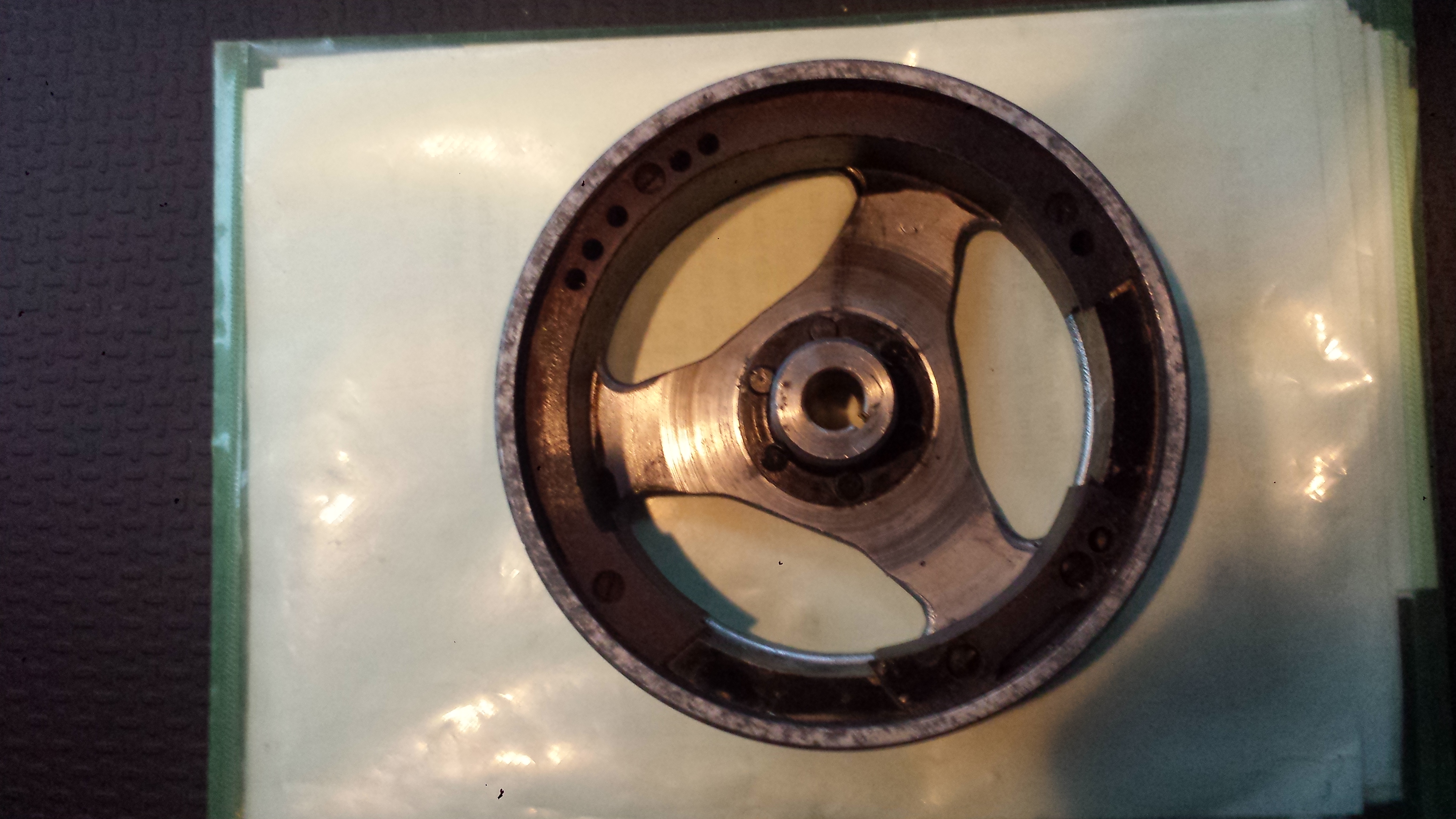

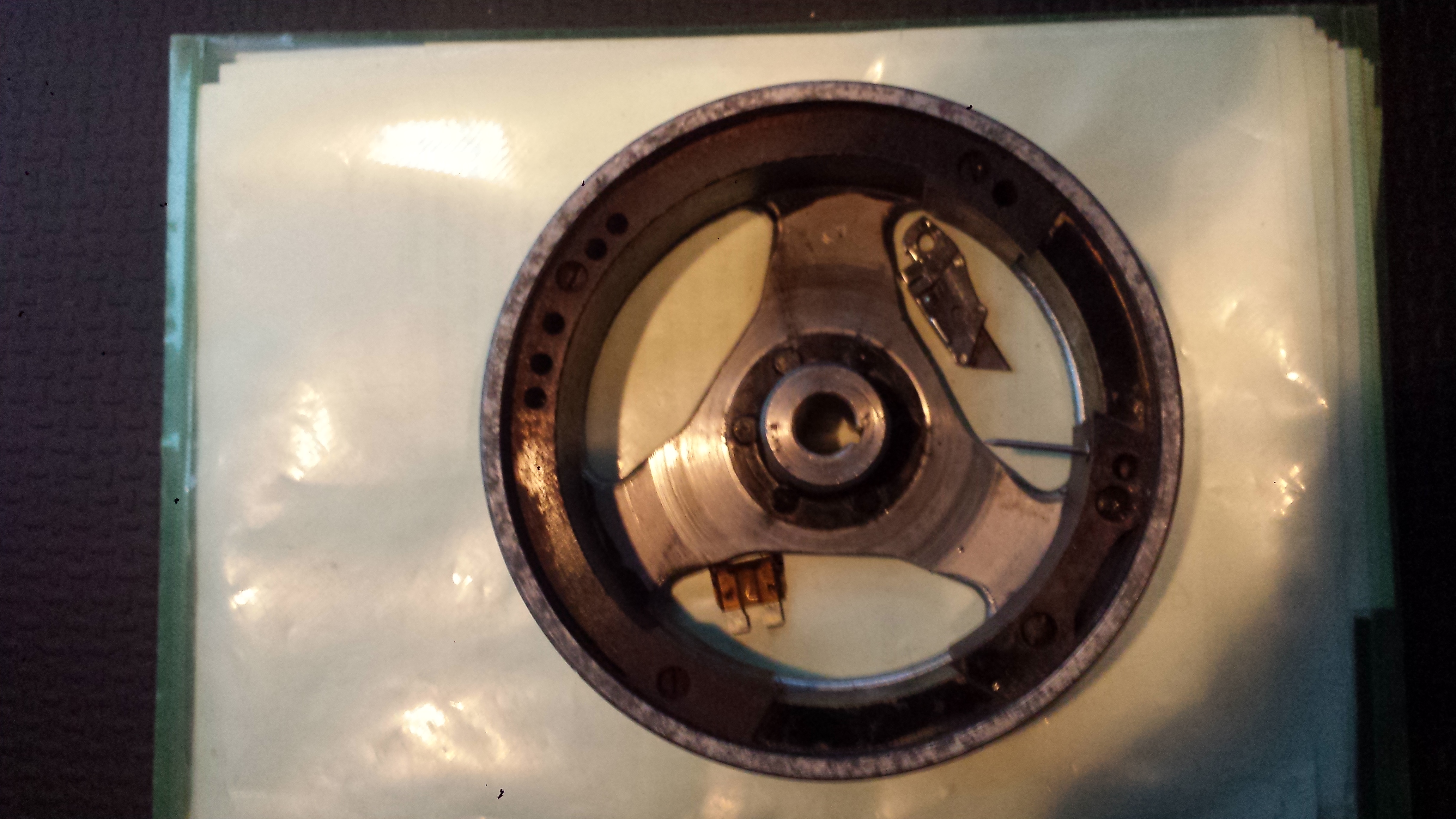

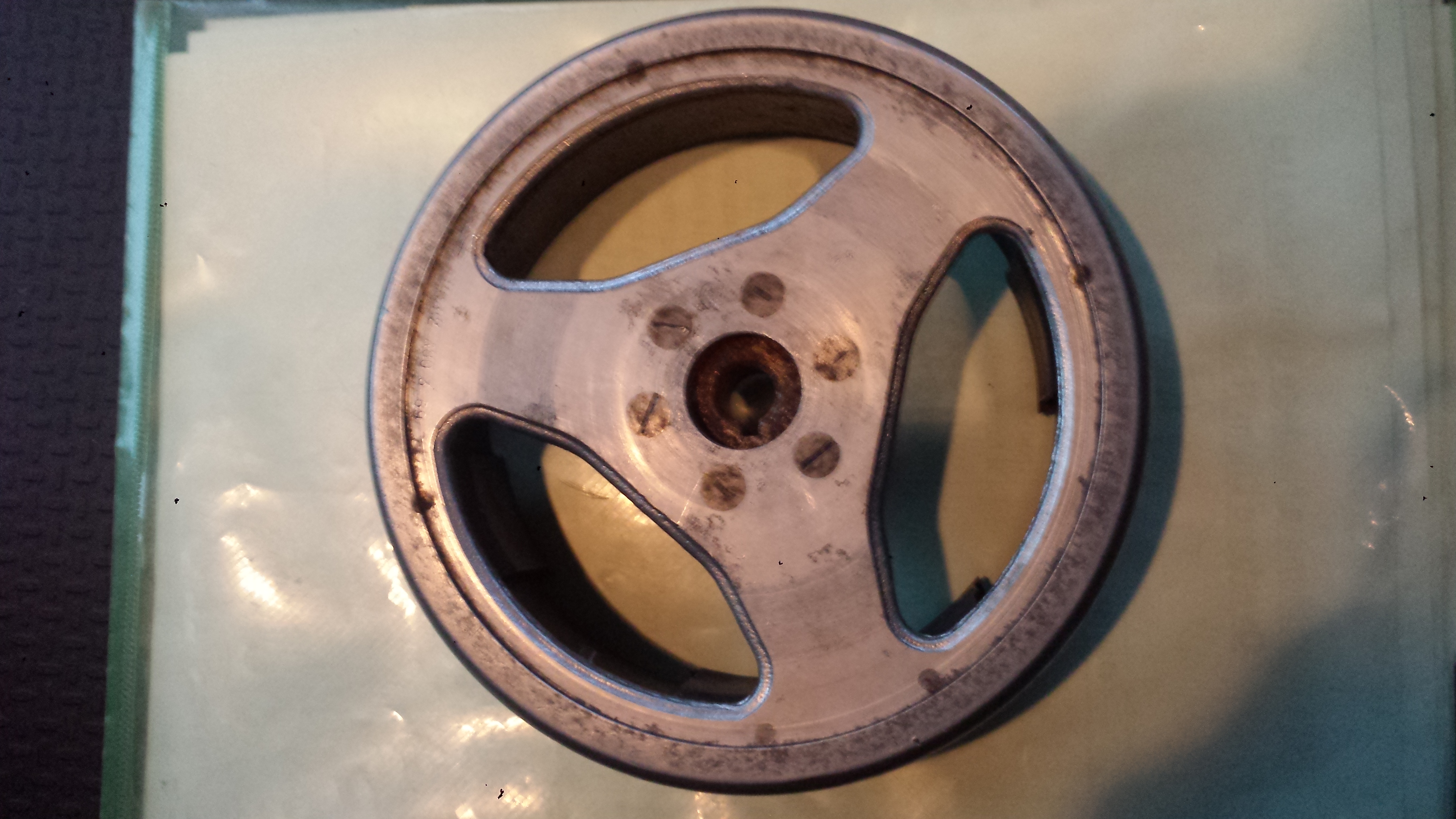

Well/well picked up the offending flywheel tonight as you can see in pics very little magnetism only managed to stick one panel pin to it reading back on this topic it clearly states that this worked last year me personally i don't think it is an outboard flywheel BUT I WILL LEAVE THAT TO THE MASTERS TO DECIDE numbers are as follows
R82 A80 3 59 and a few circled numbers M5 sorry for poor quality pics taken inside a 450bhp scania cos it's raining outside. ....cheers could it be from the dark side..
Re: 40+ won't start
Any sign of a cam in the usual place Tam?
