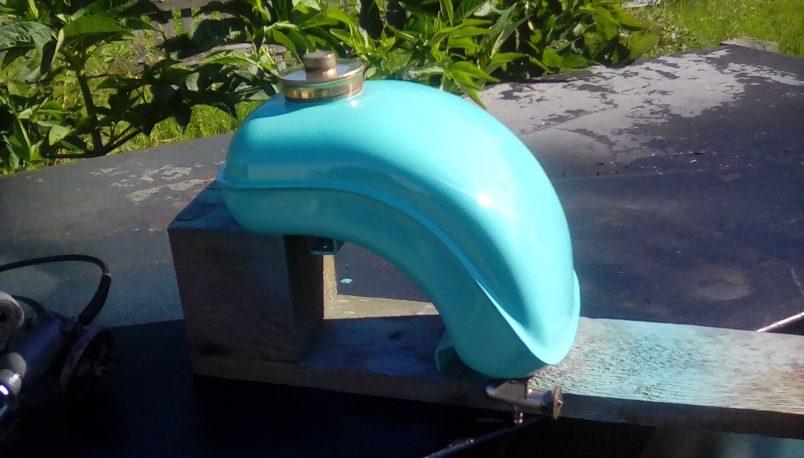

Here are the pictures, the colour is obviously not original she's getting some sympathetic tlc.

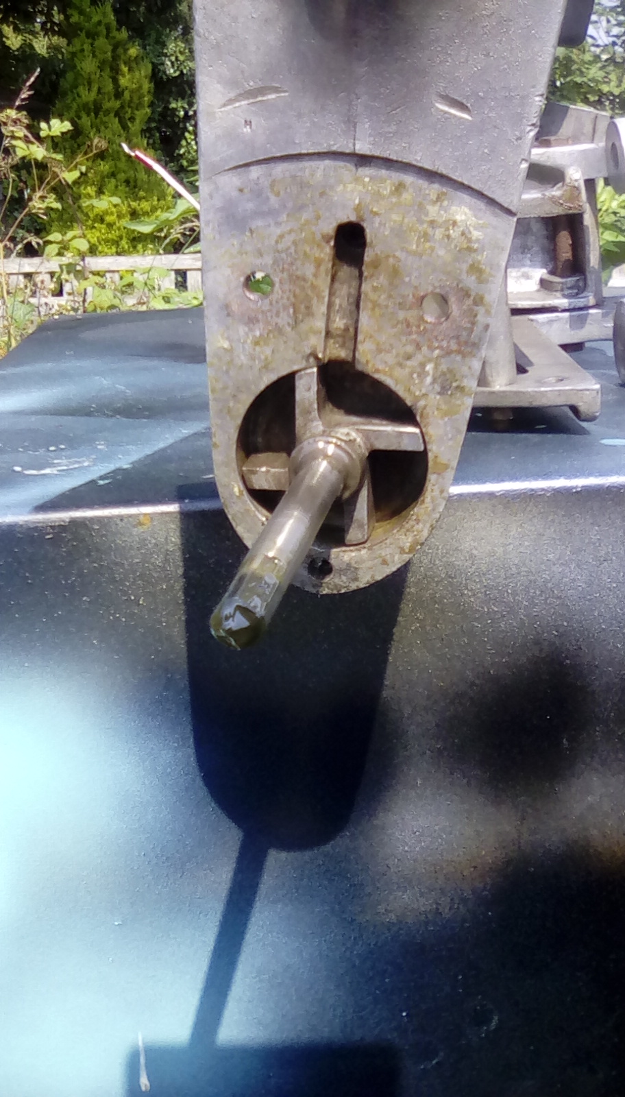

Re: Old J.A.P engined outboard, water cooled power head information needed.
Post by Seagullsicksteve »
Hi thanks for the reply the lower unit has a pump, and the crank cases are definitely jap see pics below. There are no marks on the cylinder however it runs well and pumps water from a hole in the cylinder jacket I made sure it was a runner before stripping and painting. Thanks steve.
There are several references to Water-cooled Sea Bee's on the net but no pics matching what you have there unfortunately.
It may be something ex-factory or a bitsa assembled by its previous owner. Either way, it's an interesting outboard and a cool addition to any collection.
I wish you luck with obtaining more info. I for one would be interested to know more about this little ob.
