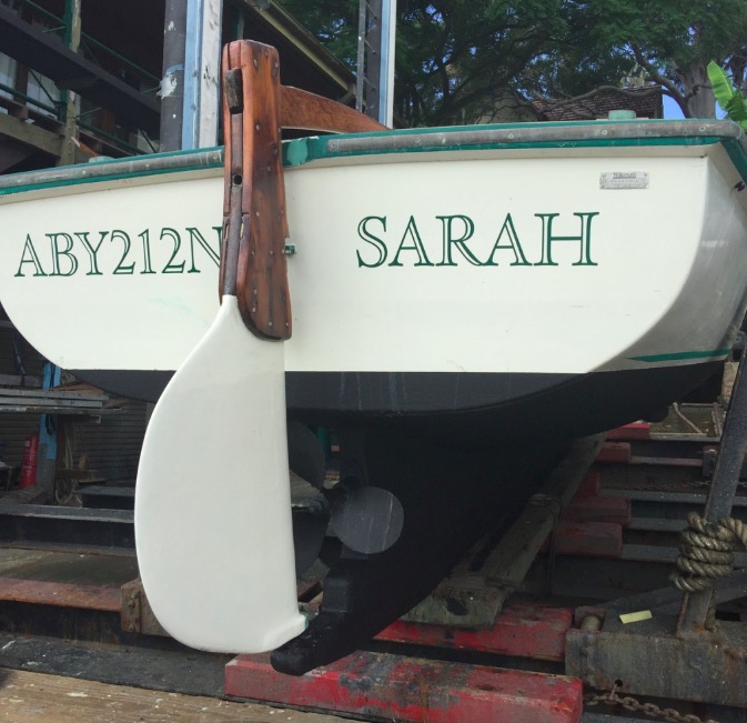

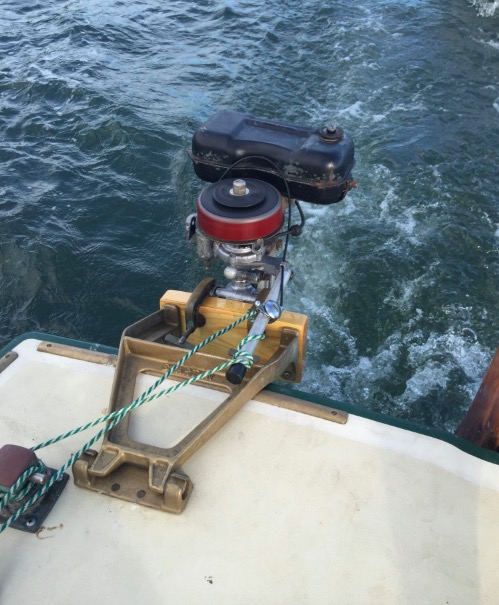

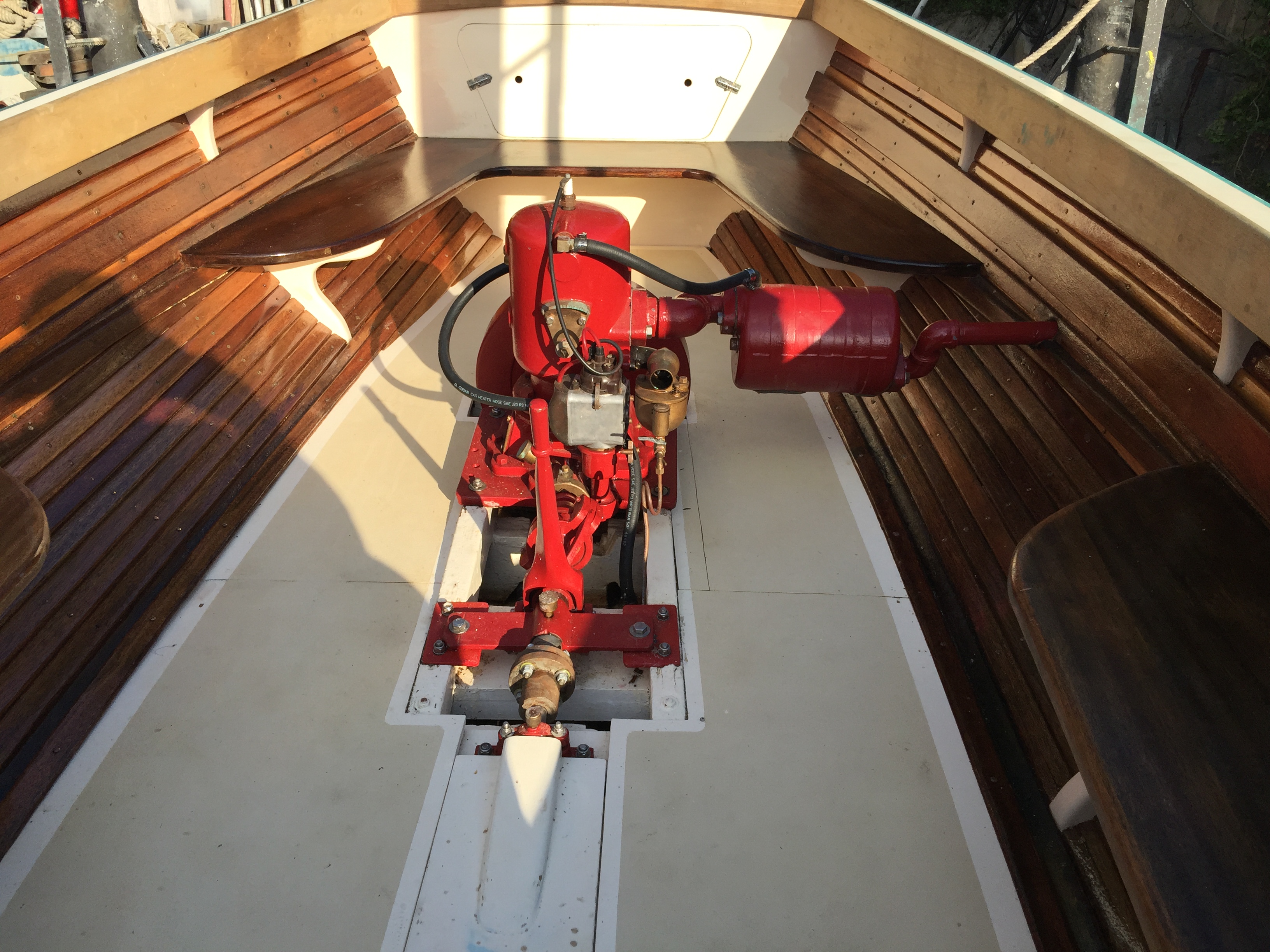

I have a SilverCentury Plus as the auxiliary motor on my 20' open work boat down here on Sydney Harbour. The Serial Number is WSPCL1378HH7. It is fitted to my boat 'Sarah' with a Spartan outboat motor mount. We tested it for first time on the weekend and was not overly impressed with the performance in the water. Currently the prop is a four blade rounded prop* and I see in all photos of Silver Centuries that it should have a 5 blade 11" hydrofan prop. Would the 4 blade rounded prop on the engine now give less performance in the water?
Silver Century on Spartan outboard mount
Interior of the work boat with Chapman Seadog Engine

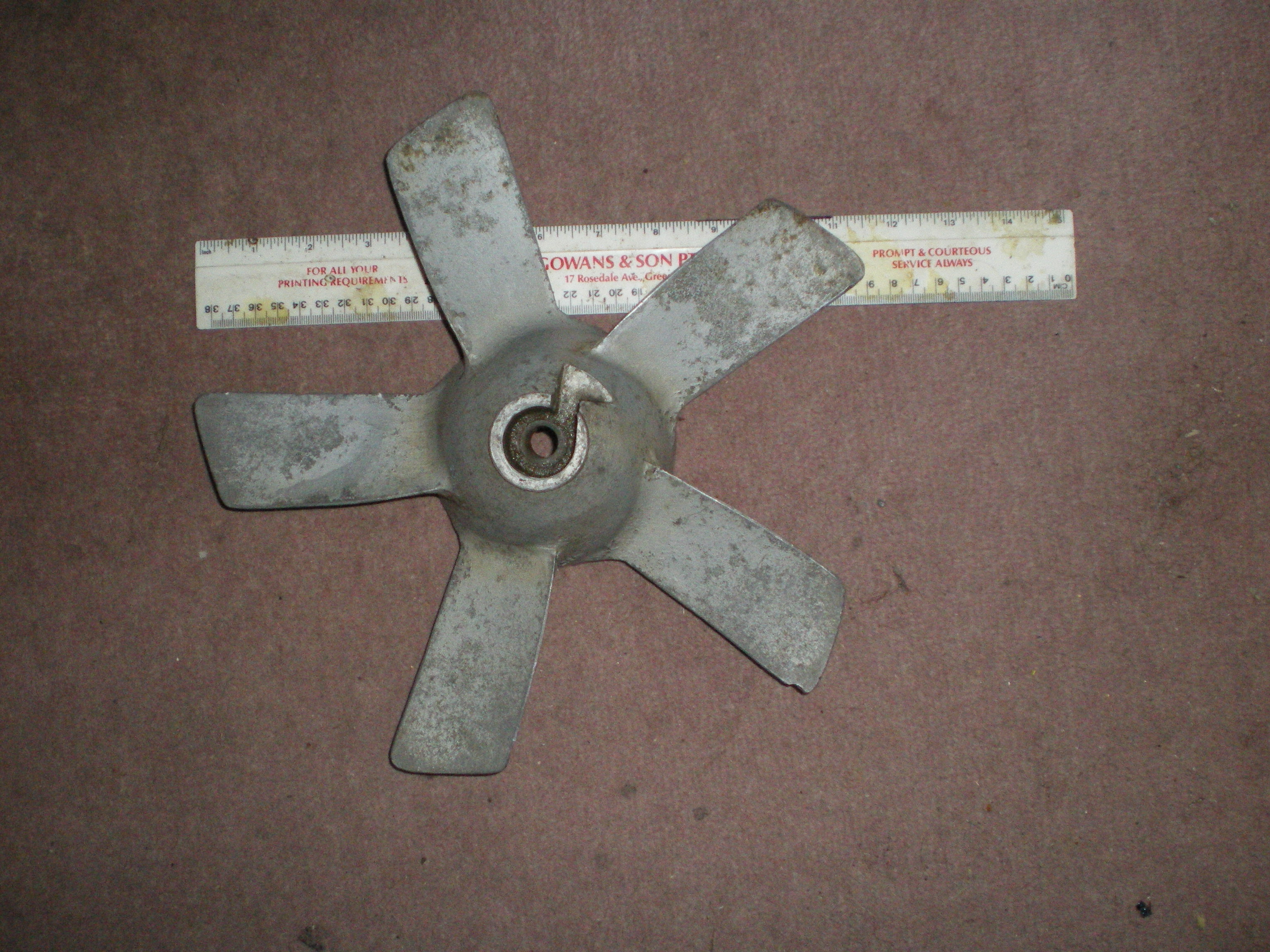

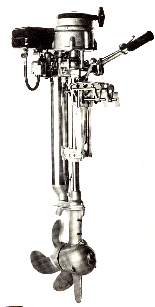

I have been led to believe that most, if not all Century model Seagulls are supposed to turn a five-bladed hydrofan type prop, not four blade or otherwise.
If some Silver Century's left the factory with four blade props, I'm sure someone will let us know.
BP
Again, thanks to SOS for the pic.
Member SOS, AOMCI,

Re: What is the correct propellor for Silver Century Plus?
Hi JTR
A propeller correctly applied will give the maximum RPM of a motor depending on what mass you are going to be trying to move regardless of external factors.
You have to start from there.
Your lack of performance was noted but was it because the motor could not reach operating RPM limits or was it because it was over revving and not actually having any effect.........
Start with the propeller supplied as standard for your Gull model is the best thing. Not that many choices I am afraid as props match gearboxes as a rounded rule of thumb.
Gulls push water.......volume and weight remember.
Yes, key thing to remember is as Bruce says props should be matched to the gearbox you have. The Centry plus is designed to push heavier boats along at a steady plod. I would suggest that the 5 blade hydrofan (Great description!) will be perfect.
Performance is never going to be hot though.
