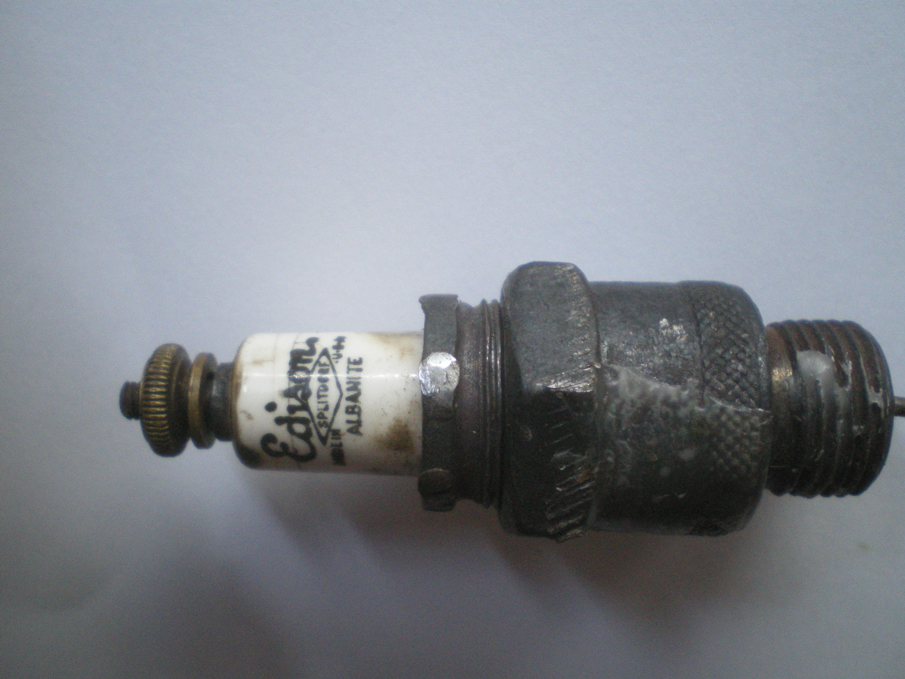

If you are worried about damaging the 18mm plug thread, why not use an old two piece spark plug, just the bottom, drill and tap a thread in the plug centre and use a threaded bar of the reverent size, it wouldn't take much to make one.
Posts: 3287
Re: Success rate in freeing seized motors
They have become a bit too collectible to modify :shock:
Its had a hard life
