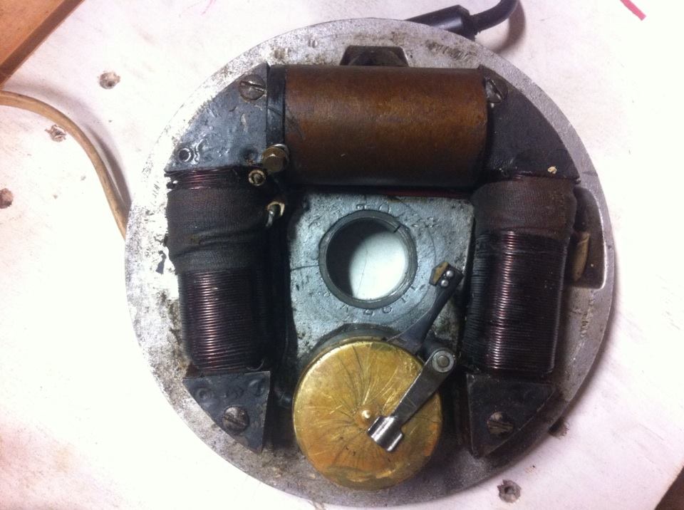

SOS can supply the washers to fit either side of the tiller, as well as the rubber bush that goes inside. Can you post some pics of the charging coils please?

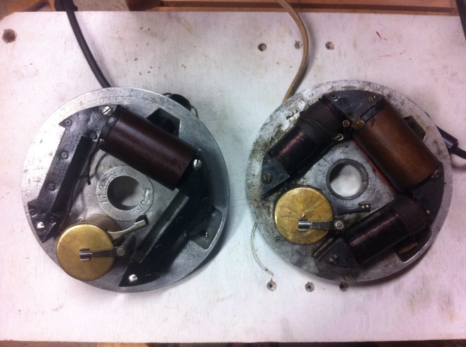

Baseplate on the SD
SDP Baseplate on the left, I've cleaned up & repaired - now has a spark

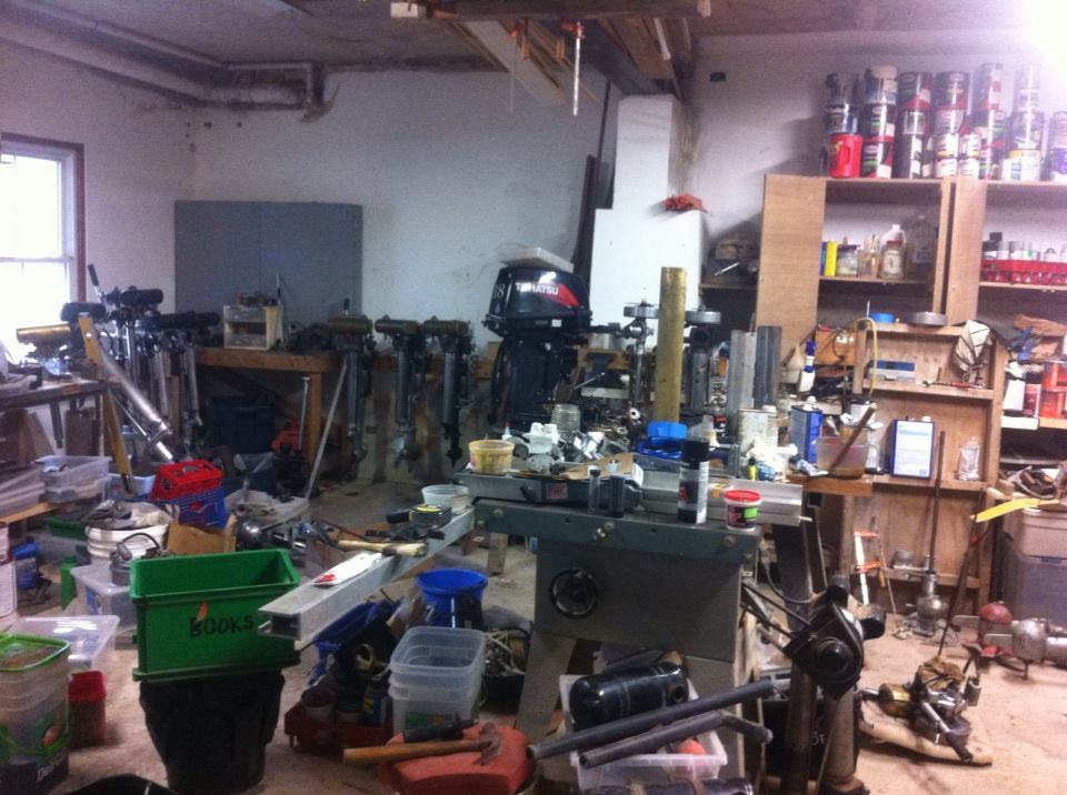

Obligatory workshop pic - Charles. it's gotten a bit messy since your last visit..

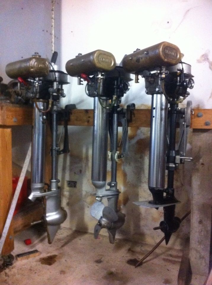

Current flock pic (daughter's motor on the right, son's in the middle - which my wife currently races until he's old enough, my father's & my race motor on the right) - Hoping to add the SD & SDP to similar usable condition...
