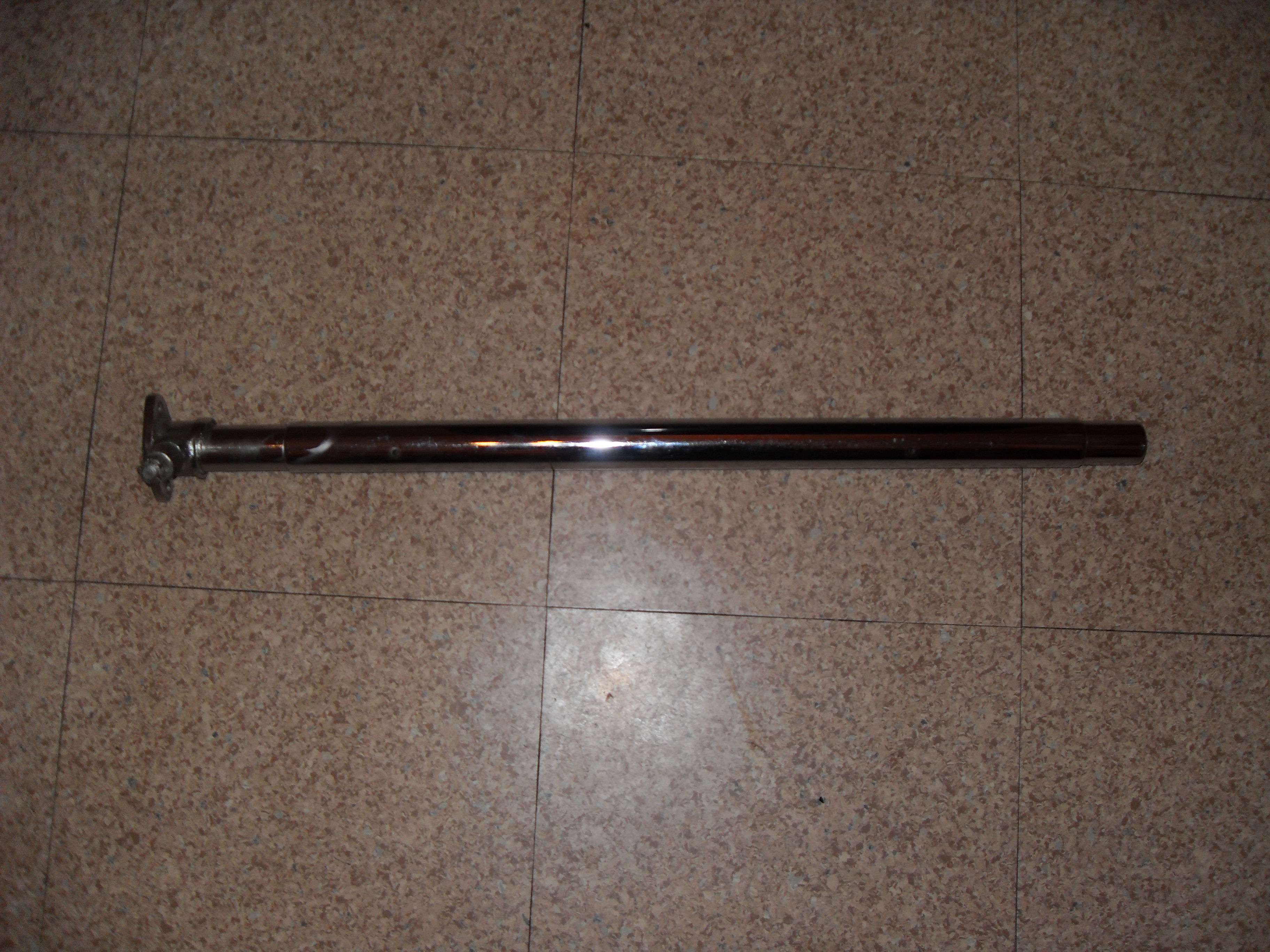

Not quite as easy as cutting to length as the drive tube is flanged at the top and bottom.
I had thought about taking the tube to a machinist to turn down in a lathe, but he's not really interested, plus i dont have a lathe or i would have done this ages ago so i'm sort of stuck at the moment.
Everything else for the conversion is a piece of cake to do except the drive tube.
19 inches (or there abouts) is more or less right for what i need.

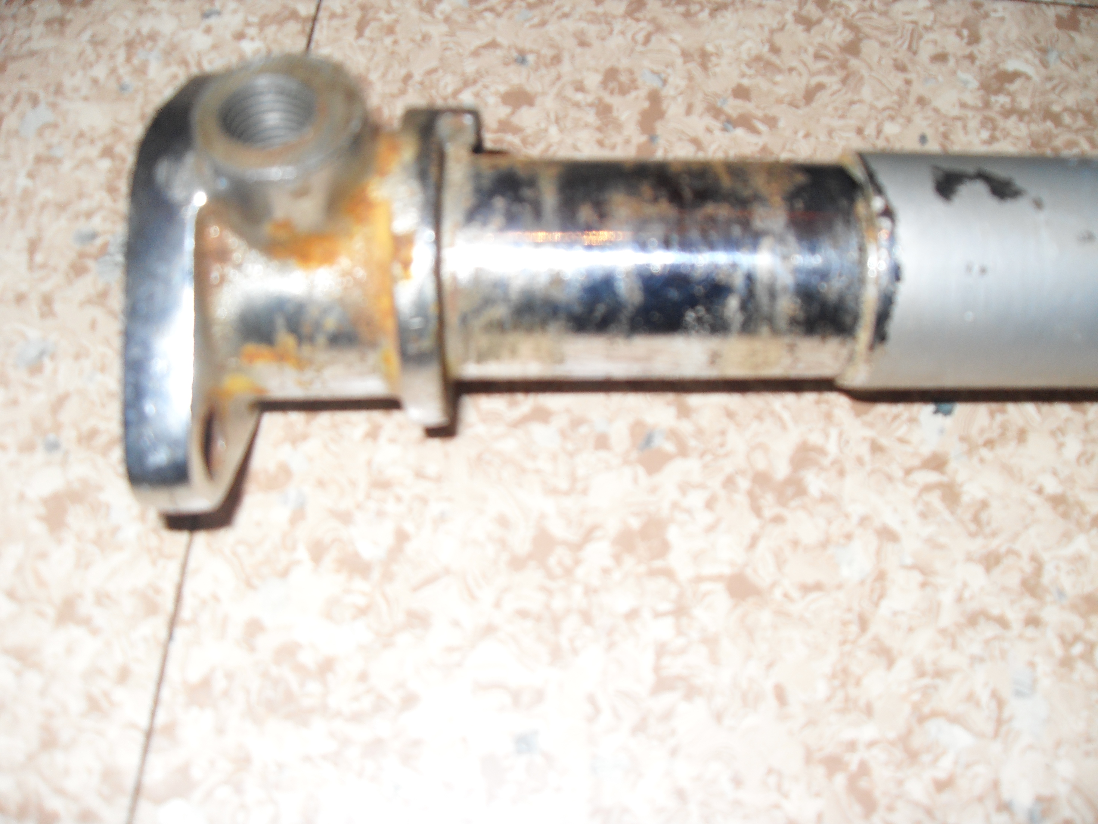

The other thing about these later tubes is the clutch pivot stud. It's much bigger than a silver century type, (it's actually a bolt that holds the lever to the tube) and the clutch lever with all the relevant fittings looks almost the same as a kingfisher version.

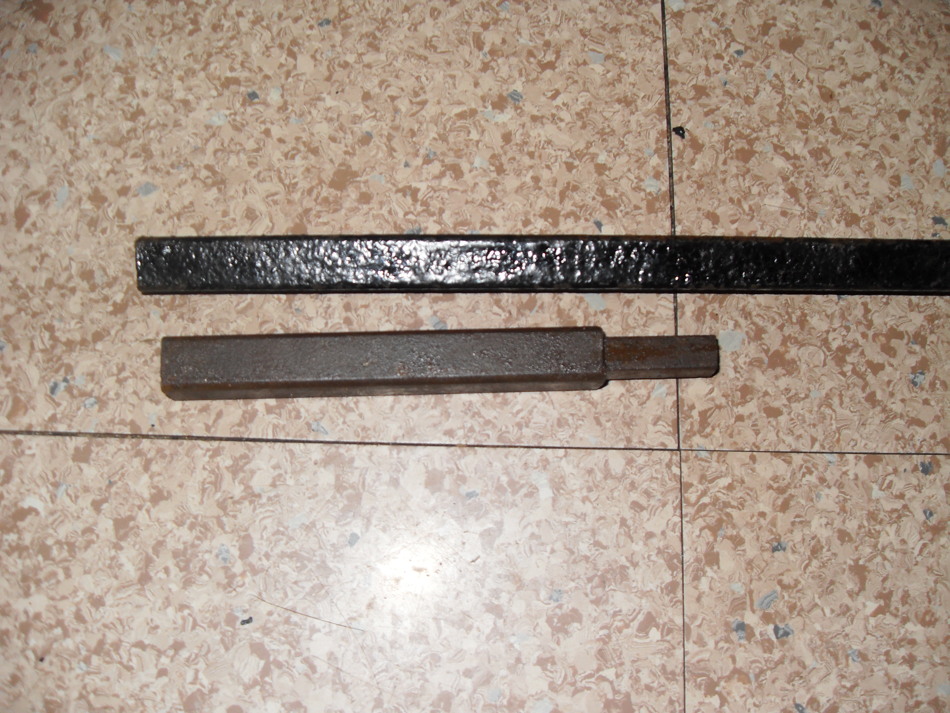

When i mentioned "factory fitted" what i meant to say was the square drive shaft has a removable section 6 inches long, which is the dimensions we're talking about here to convert from long to standard. Sorry for any confusion.

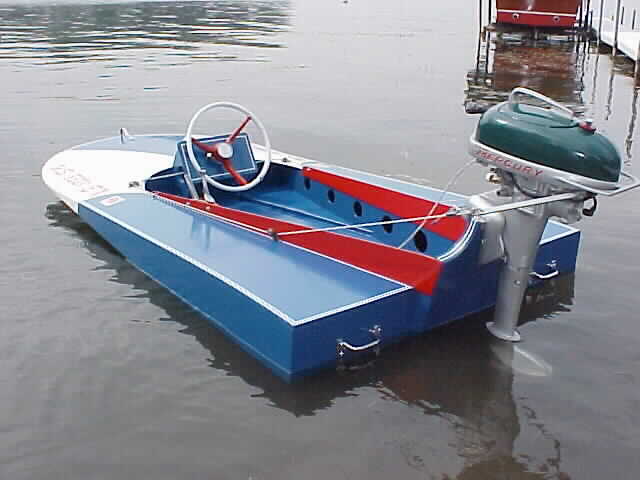

Re: model 90 conversion

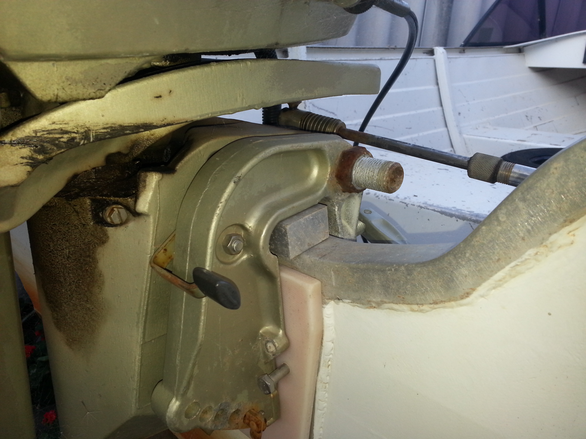

Im having the same thought, I made a bolt on pad out of Form Ply for a tinny years ago because he only had a long motor, its still in use.
What a about something like the motor mount on one of these 60's plywood hydro's?

If i were to go down the route of re-machining an existing tube, how easy/difficult would it be to get this done.Is there anything special i need to know about these later tubes i.e are they the same wall thickness from top to bottom? (except for the top and bottom flange)

Going back to tubes for a moment, the only real difference i can see between a late silver century long tube and a 90 long tube is the bore size of the clutch pivot stud/bolt. Is that correct?
Just thinking as i have a new old stock longshaft for a silv. cent. stashed away for something but never got round to doing anything with it. Looks to be in very good shape, no trace of corrosion inside the tube either.My idea is to cut to length and re-machine the lower flange, drill and re-tap the thread for the clutch pivot. Hey presto!
What say you?
