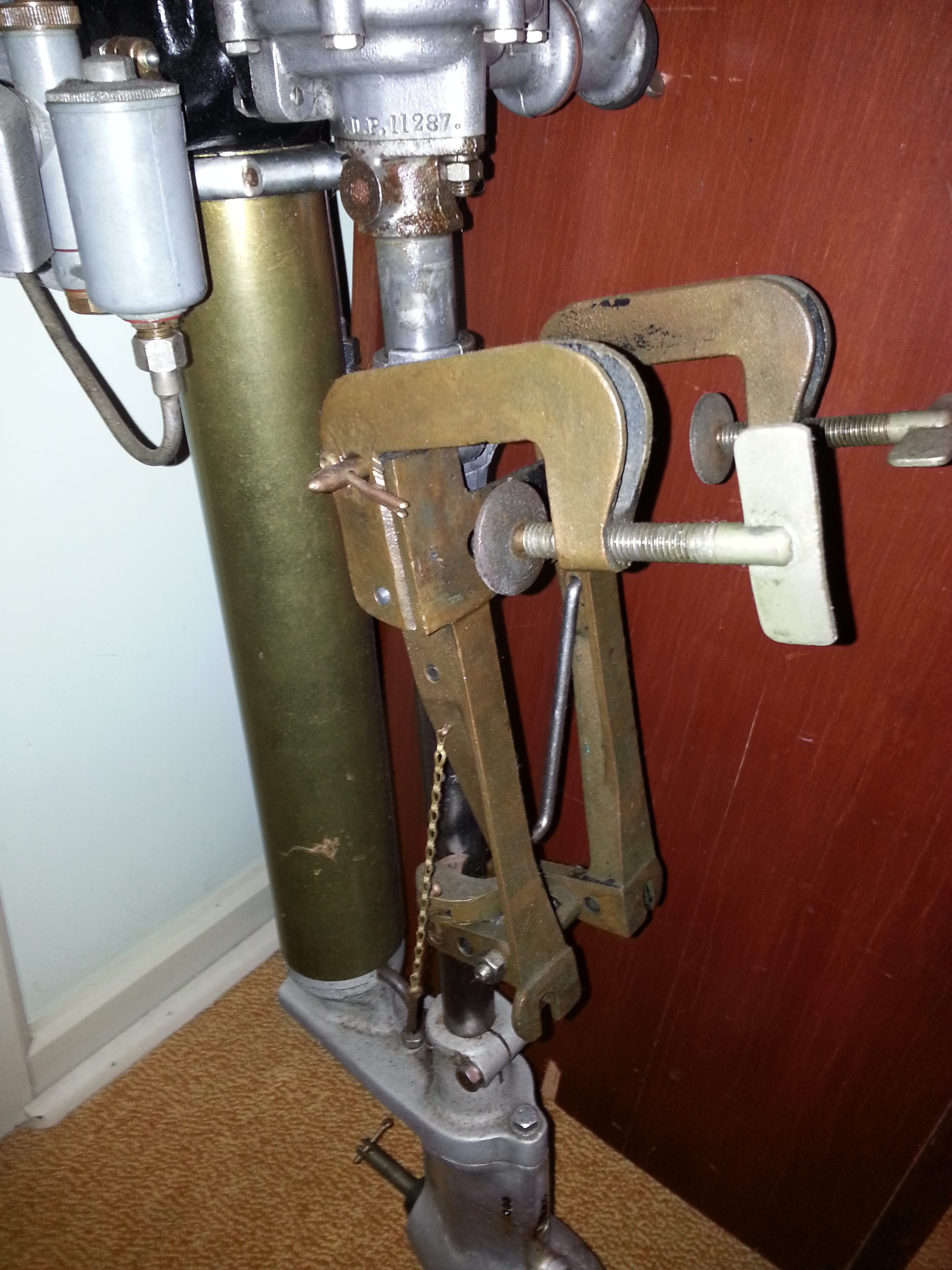

Hi Dave
This bracket I believe to be correct for my particular SDP.
It is firmly attached to motor so I am not offering for sale.
Is it something like what you envisage however?
Do you have any pics (We Love Pics) of your SDP and engine number? Never see very many aye.

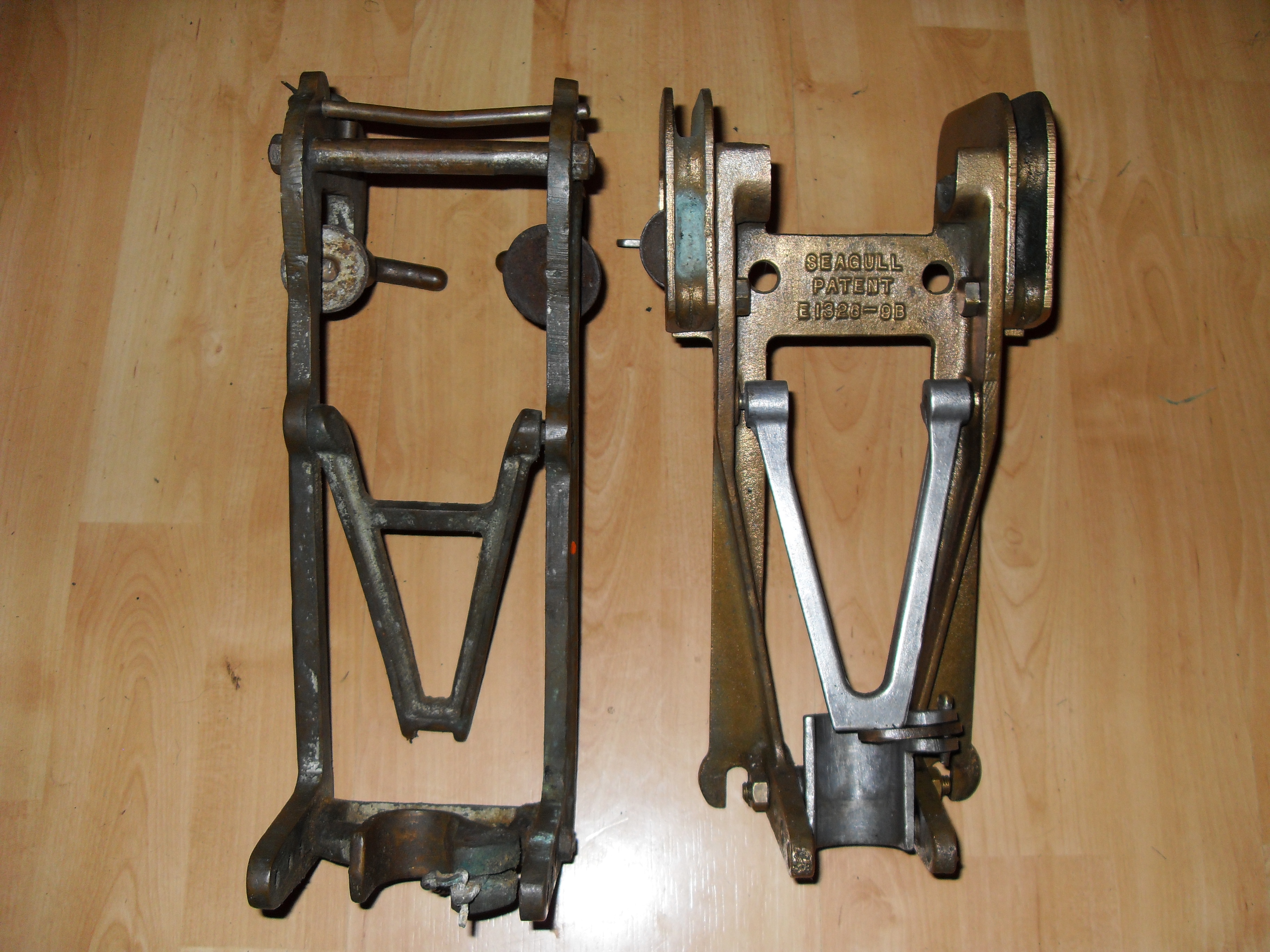

So that everyone can see the difference between a skeletal bracket and the more "common" hollow bracket version (still nice though being all bronze) have a look at the pics below. Might save some confusion

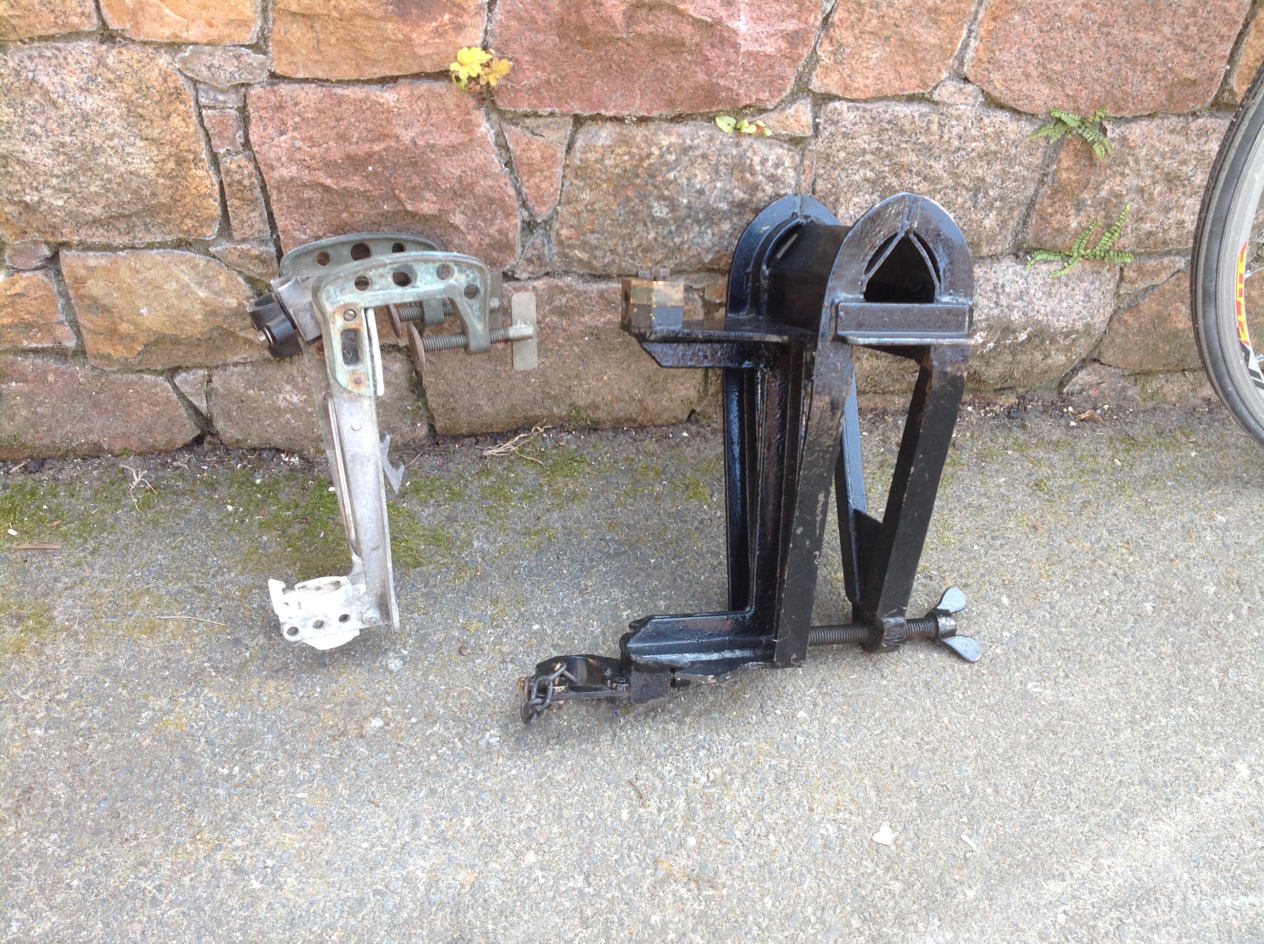

Very different things are the Military spec version.
(picture courtesey of Rene) Thanks Rene

That "military" style bracket looks quite different to the ones in the SD parts list paperwork.
A skeletal bracket without the engine support bracket & securing pin parts is of no use whatsoever as any of the later engine support brackets won't fit, so take care that you get all the required bits, so that you can avoid buying an expensive ornament, & they've very prone to breaking.
So it might pay you to buy a later one like Bruce's as they're much more fit for purpose, if you can't find one of those come back to me I think I have a spare one.

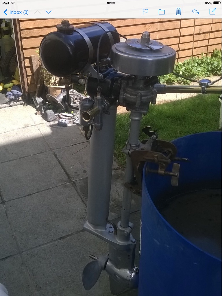

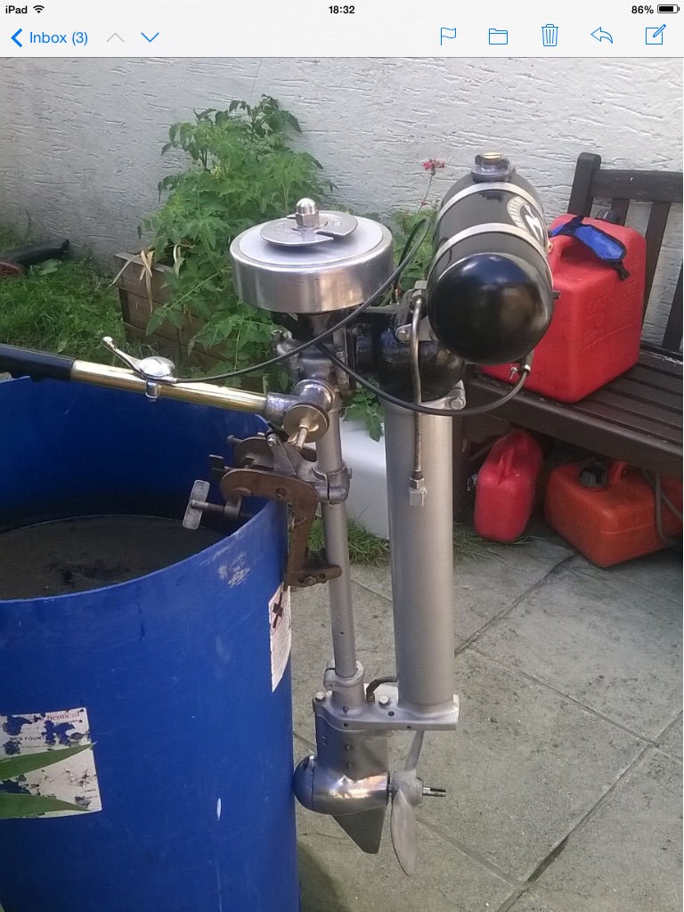

My SDP SO far !  I'm still waiting for my reconditioned ignition to get back to me, albeit two months wait so far   . Notice the powder coated exhaust and drive tube! Both were in poor condition.  As you can see, it's a work in progress , but enjoyable.

I've never tried powder coating seagull parts, but have done loads on my Triumph rebuild. It is a bulletproof finish.  The original would have been chrome on brass for the exhaust (Which peels off easily..) and chrome for the leg.
Where did you get the tank decal from by the way?

Nice fuel pipe.

I must say I'm not a fan of powder coat.
I had my kit car chassis powder coated befor building it, I now wish I had it galvanised.

As for the pics, this was something Rene sent me a while back now. Not sure how many variants of military bracket there were. (3 maybe?) Still going through loads of stuff at the mo.

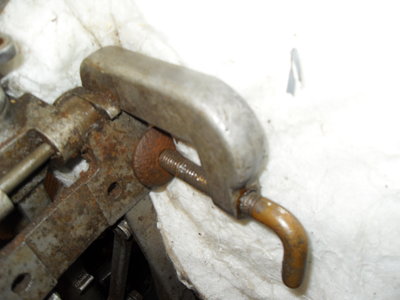

Hmmmm
where does this one fit into the mess?
All aluminium clamp with bent thumbscrews, all aluminium centre section (raised lettering in the casting) aluminium thrust block too.
Originally fitted onto an AC dated around 46/7
I can go to this any time as it's in the shed if anyone wants better pics of it!
