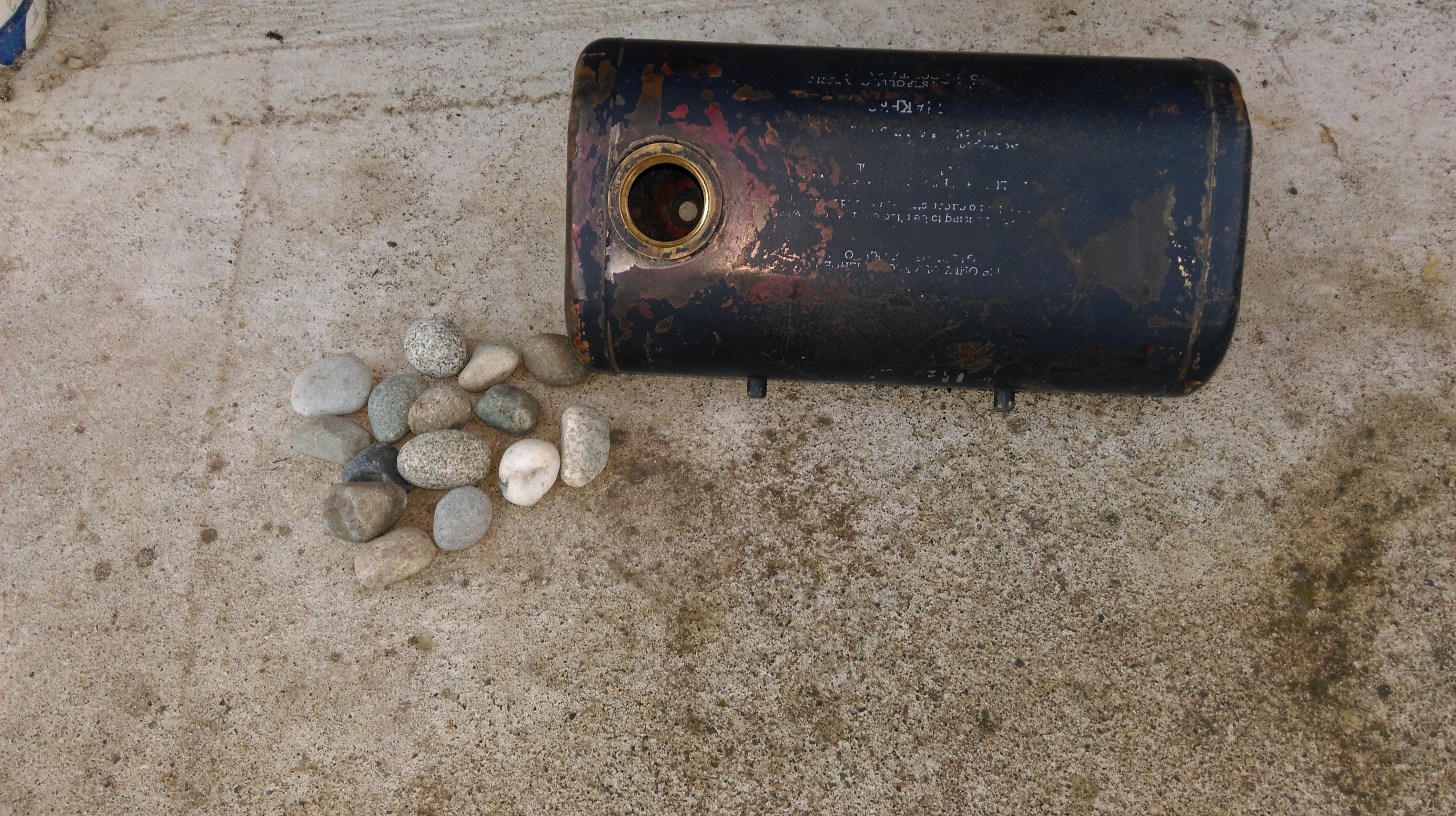

well....I do have some gravel, hot water and soap

I think you need smaller stones that have sharp broken surfaces so they will get into all the nooks and crannies. Actually I only use degreaser and then flush out, never seems to be a problem.

Would be good if at least some were sharper, the smallest 4 look the right size. They need to have good clearance from the filler hole as they need to come out of there as well. Could easily break some up with a 6 lb. hammer, put them in a strong but flexible bag and a couple of good shots with the hammer should do it.
Some use drywall screws or regular nuts and bolts.

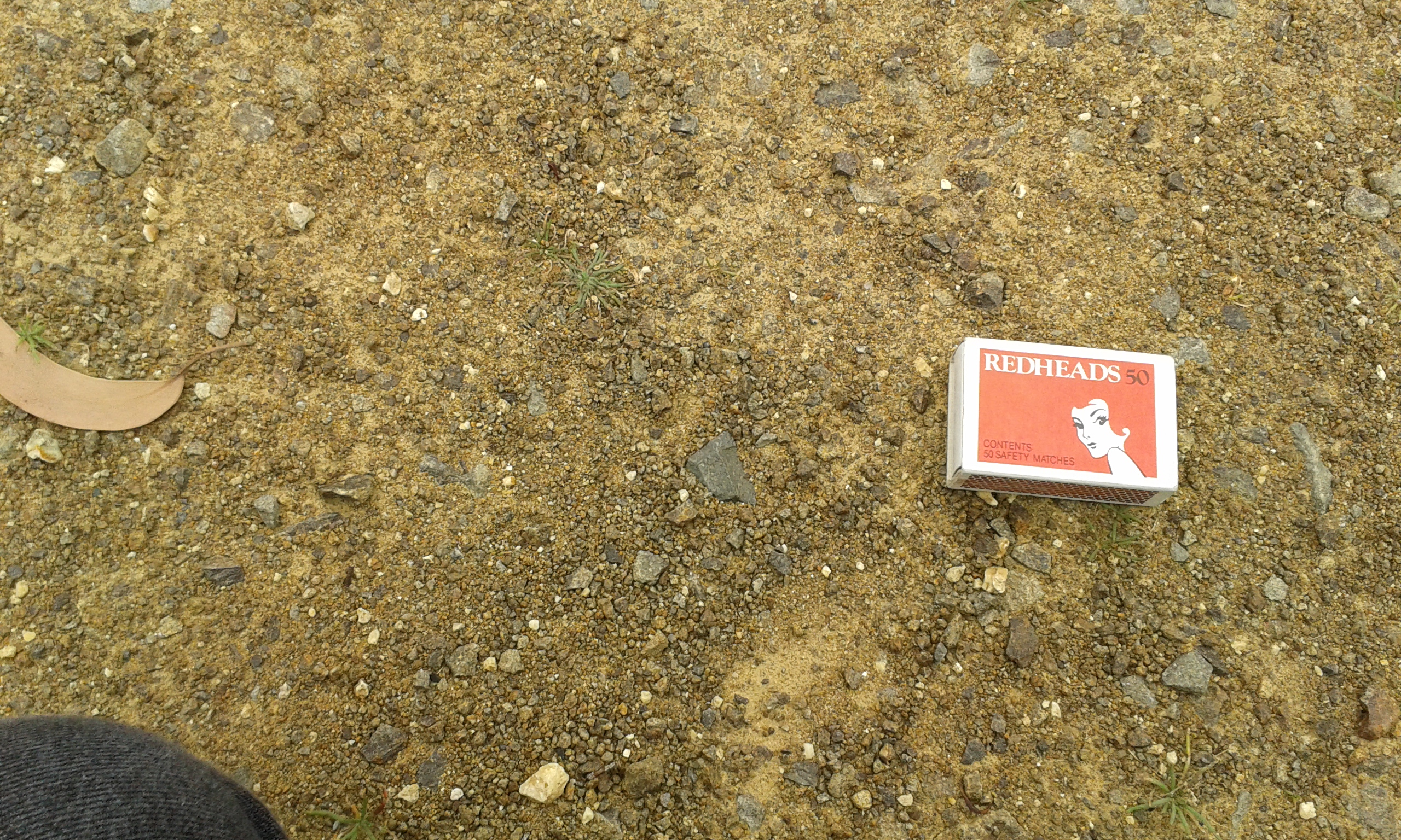

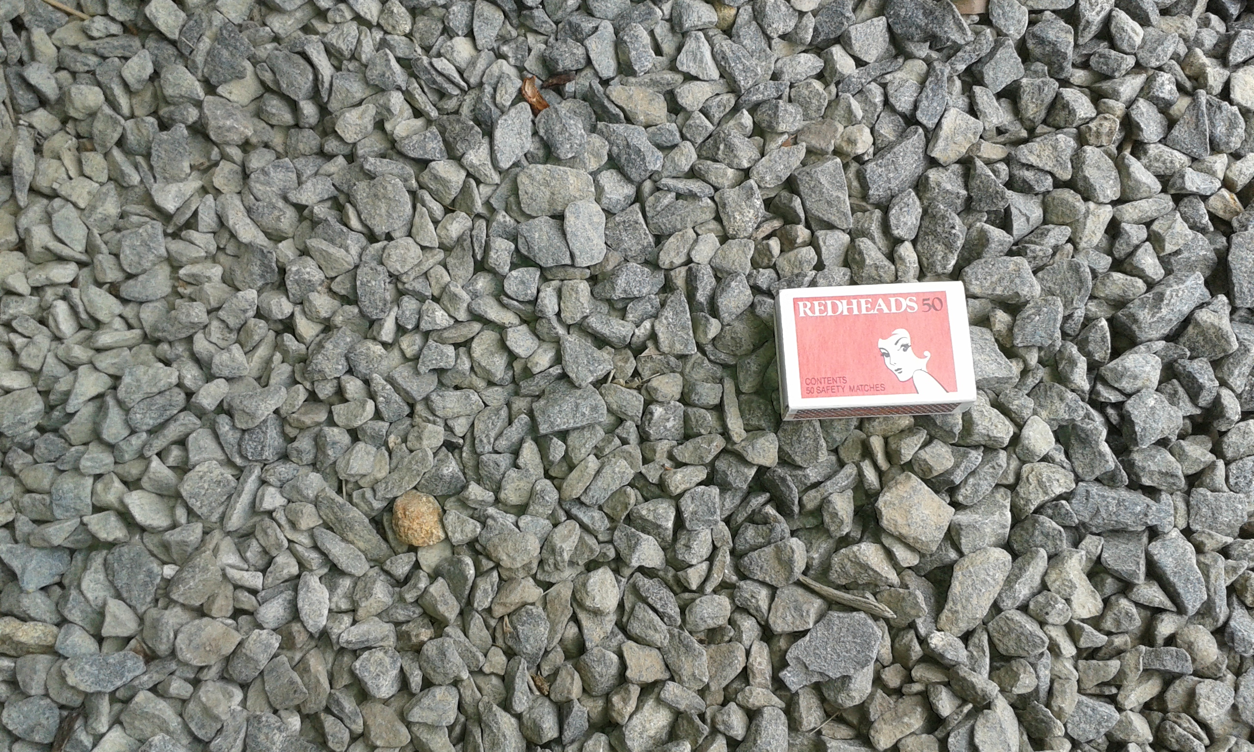

Took a couple of photos, first of blue metal and the second of gravel . The blue metal comes in various sizes all the way down to 5mm. The example in the photo is 25 mm.
The photo of the gravel is from a Tasmanian road. I have some 30 kl of this to drive to reach our house so I often have a grumble at the state of the pot holes and washout that need negotiating. About once ever 6 months the council runs a grader you and down the road to reshape it.

The " blue metal" you show is the size and sharpness we get if we order driveway gravel or drain rock ( drain rock for house foundation drains, goes around the perforated black plastic pipe.)
The stuff on your driveway would be under the gravel we use, it would be called pit run sand or pit run gravel.

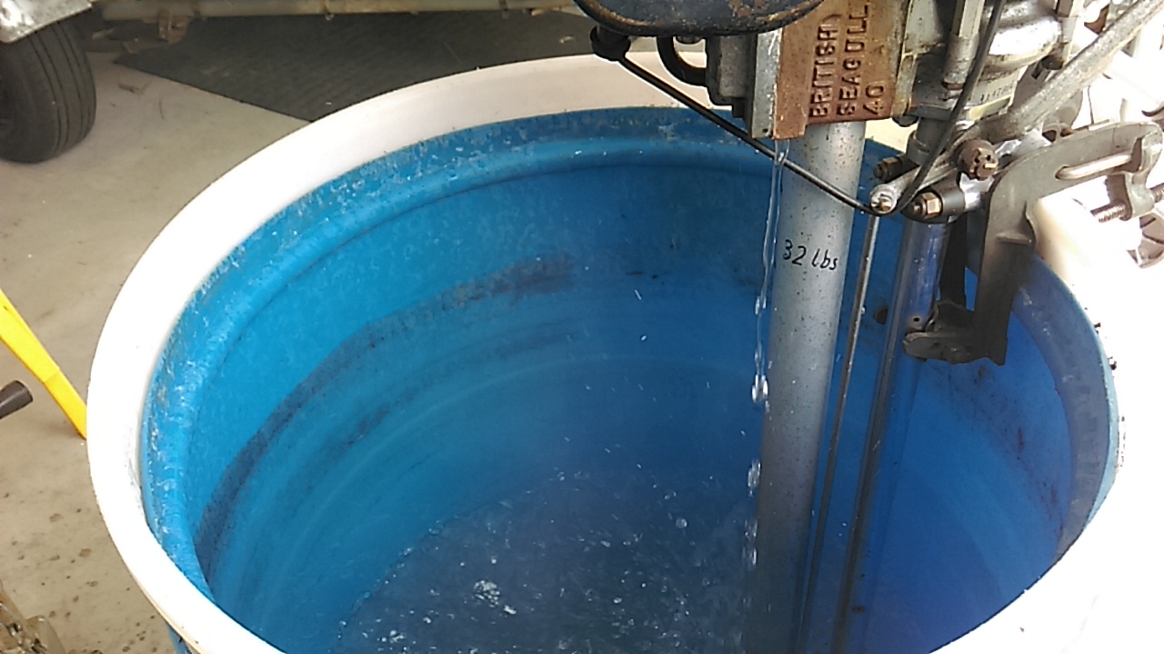

OK...I have everything back together, and today I started the motor.
Test went well and I am ready to install it on the boat.

I took it out this morning, added little more gas to the tank.....could not start for maybe 10 pulls...but finally did.
Did not try any close to full speed, but learned from this trial a lot. To start I need and extended tiller - and I standard extension will not be long enough, because I need to sit in the middle of the boat length.
