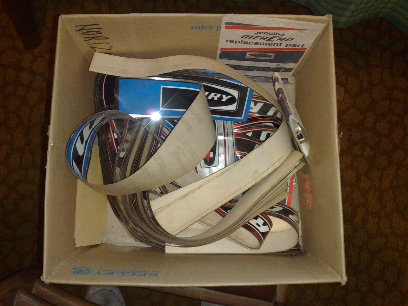

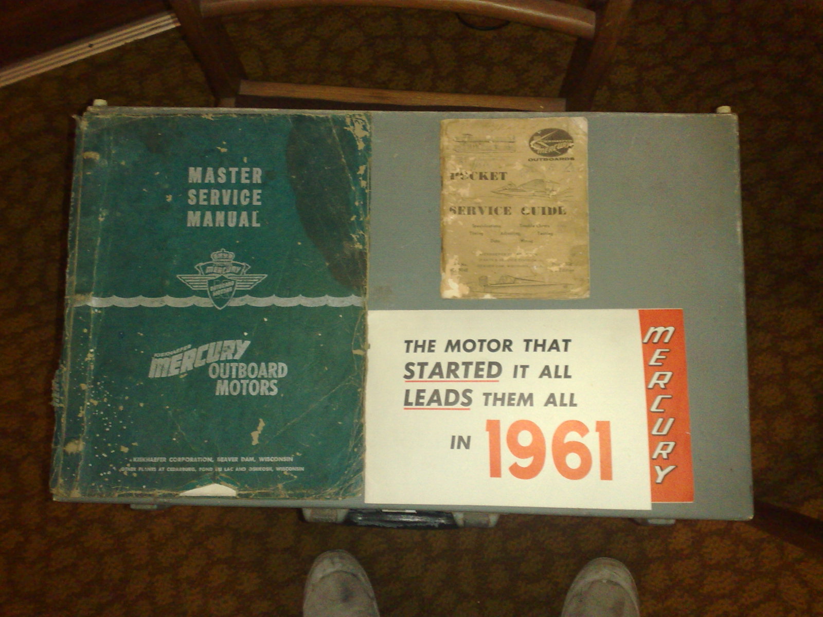

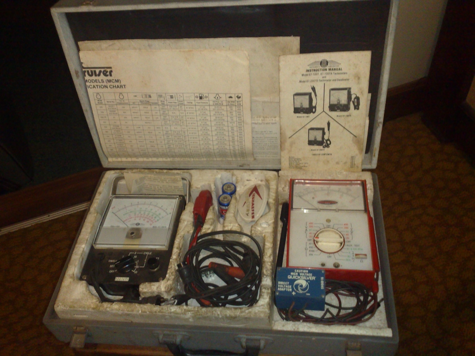

Bob's testing gear and odds and sods.

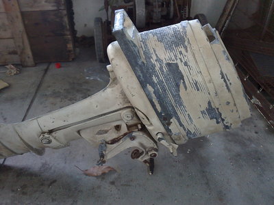

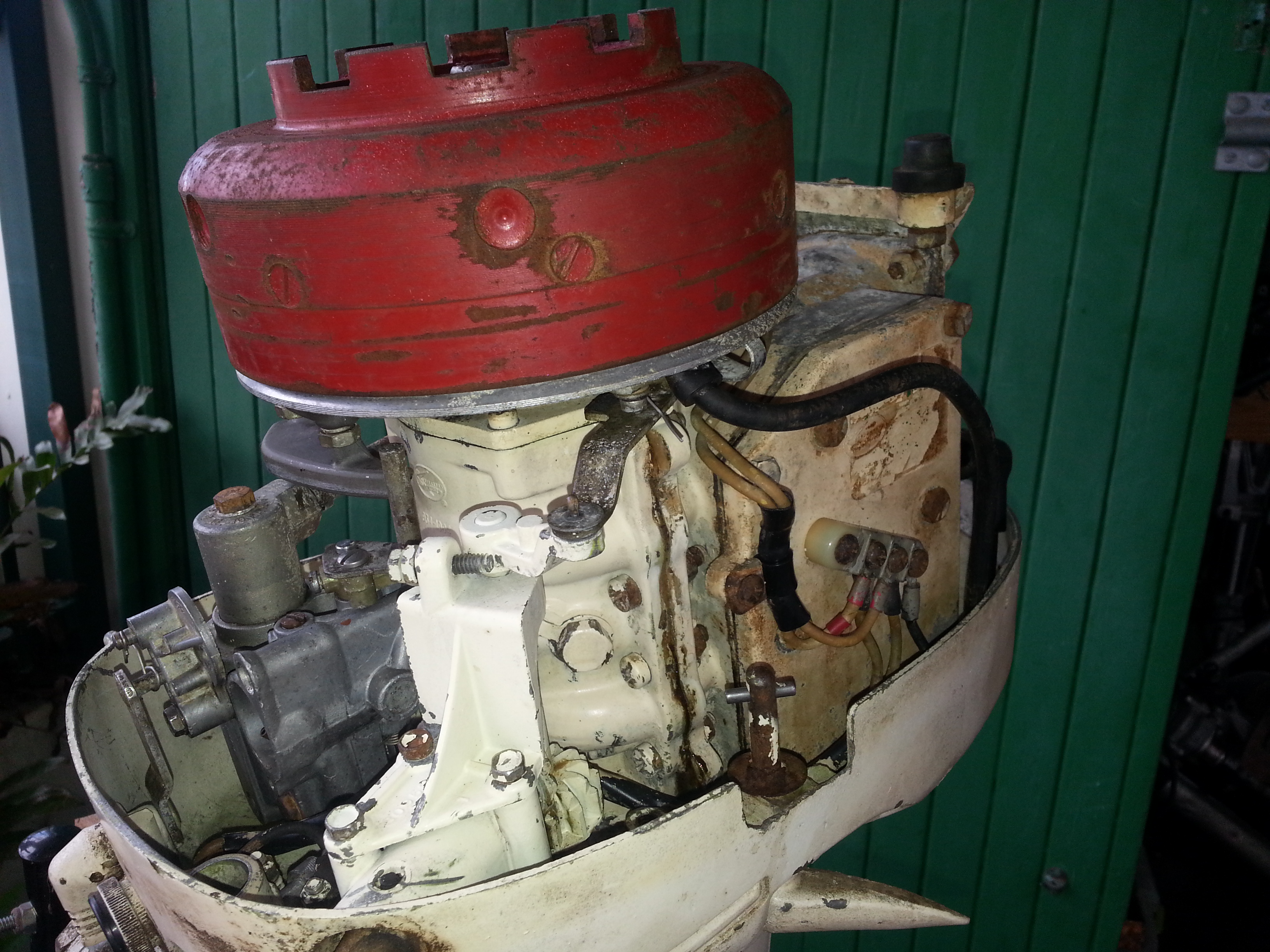

The engine has been laying like pictured for at least 25 to 30 years. Turns spark compression. Mercury unpainted metal bits locked up. Mercury paint is flaking.
I think that it will be OK when time for lubrication and freeing up.

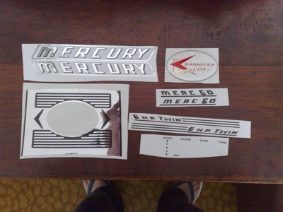

Nice decals,the red ones are '70-'71.Blue '72,depending if the blue faceplate with "Keikhaefer". If Mercury Marine,and from what I can see it is, '73 on.Worth a few bob as NOS on flea bay,number says it '63 but I think it could be older as I can't find a 6HP with a number close to that.Nice find,and this was before the dark side :lol:

Good score on that Merc, year of manufacture is early 1962, because of serial no.
check out this site for some info and parts if needed - http://store.oldmercs.com/category_s/899.htm
Have a look at my photobucket for stickers and what it originally looked like.
http://s375.photobucket.com/user/AusOB_ ... t=3&page=1

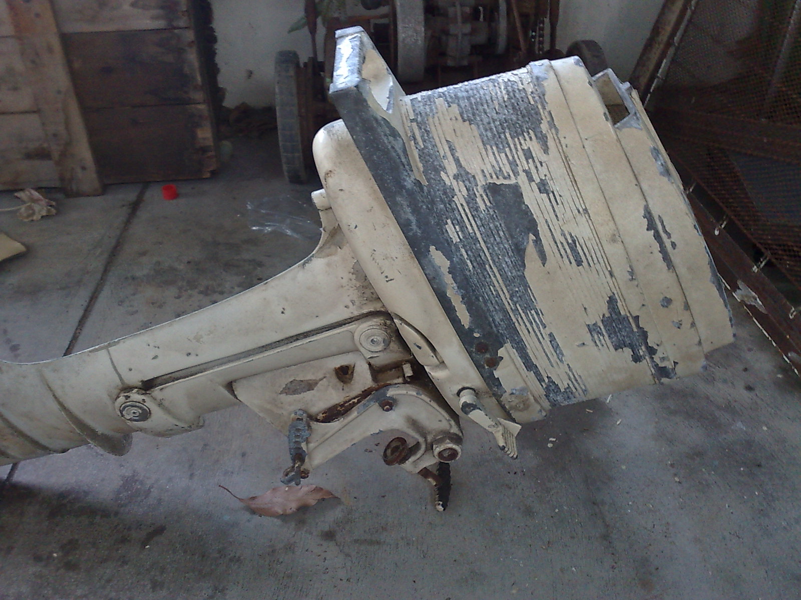

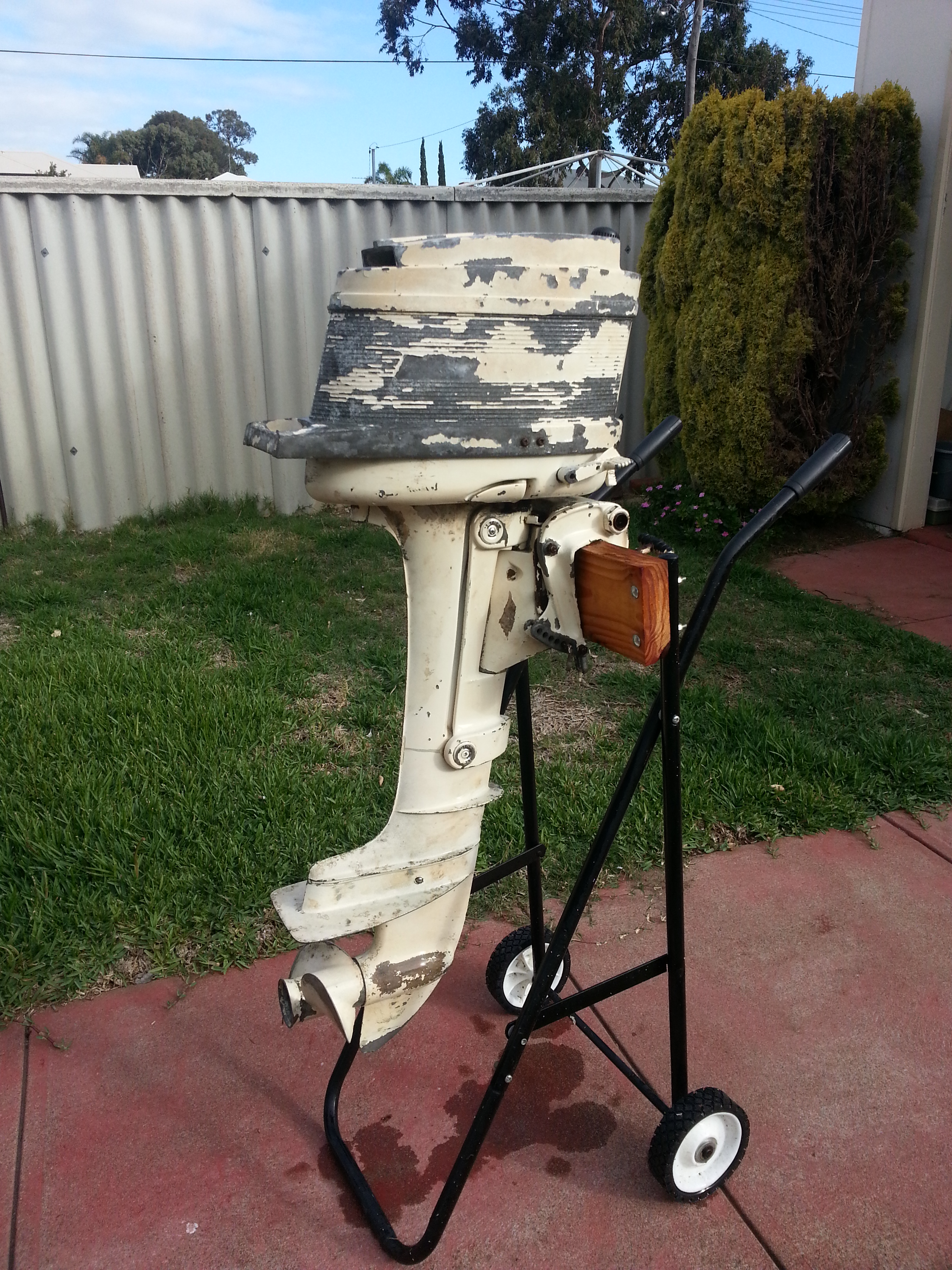

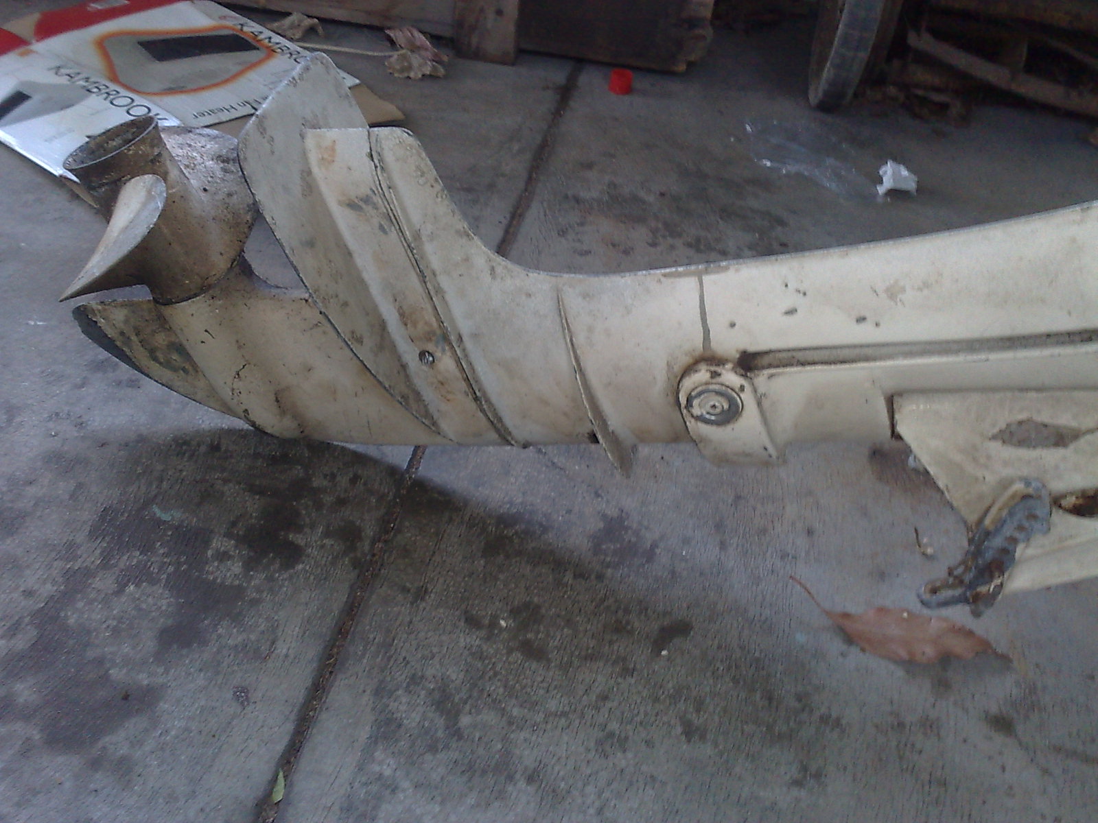

Had a peruse of merc.................so much paint flake and dust of ages.
Out with the high volume kero gun and followed by the pressure washer.
Everything wanting to fall off fell off! I will treat bare corroded metal and apply etch for the time being.
There is an issue in the gearbox.....................it is full of kero and auto trans fluid for a while..........maybe sticky forward gear locating to pawl spring etc.
No rush to make pretty...................useable repeatable reliably 1st. Gulls to attend to...............
Of note is that this power head is Hurricane while my other one is Comet. This one red flywheel the other I remember as yellow.
These are kinda cool............shame they painted them black and used cheaper metals where it counts :roll:

Problems pulling them apart yes. The one on Gumtree, over priced to Hell, shows the evidence of trying to get the gearbox off.......smashed up cav plate so basher was right handed with the hammer.
The problem was the drive shaft rusting on BOTH ends. It was common practice to drill a +1" hole in the leg so that a torch could cut the drive shaft inside. Then everything came apart to be sorted............................until next time :oops:
