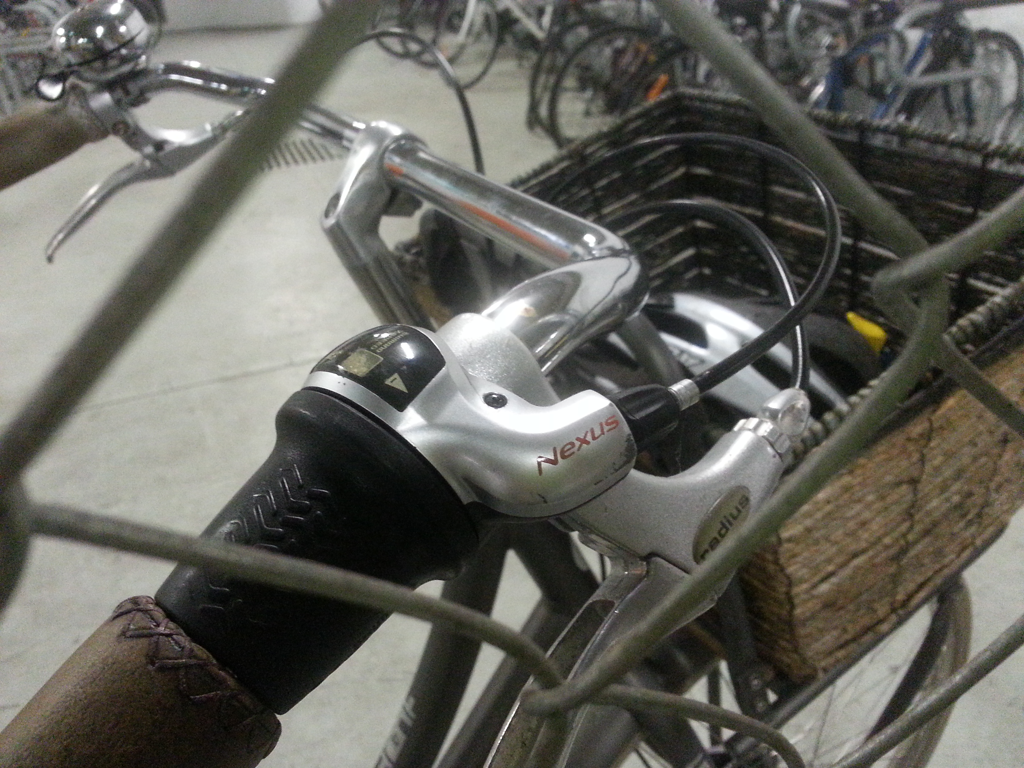

I chanced on this as a very neat option for a twist grip throttle controller.
Yes on a push bike and is for changing gears but at the end of the cable at the gear hub was the indexing for this application.
Logically the twist assembly will not have any index so it would be linear from whatever pull to whatever maximum cable travel.
I like it.
What do you lot reckon?

Looks good but i'm thinking it could be quite expensive.
I have seen indian made Royal Enfield twist grips on ebay for not allot, i mean cheap enough, to buy and try and not cry, when it don't work.
But if you investigate, please keep us up to date.

Re: Twist Grip Throttle
This is what im looking at;
Amal 7/8 twist grip.
Even the right make.
Now i need a bit of stainless tube for the new long tiller arm.
http://www.ebay.com.au/itm/AMAL-Type-7- ... 3aa7e6ebd9
Howdy Collector Inspector.
Now, this is what I am talking bout.
Took my boat out for the first time with my Forty Plus, and I knew that the tiller will be way to short for my boat....need a longer tiller - but what about the throttle - run back and forth from the end of the tiller to control the throttle...???!!!
What you come up here is a great idea.....I am really interested to see how you are going to make it work.
Would love to see pictures when you are done with it.
Good idea like the short shift drum the only thing missing on the Nexus is a damper.
Amal twist grip will need a 90deg elbow out of the drum or it will have a cable that's not in line with the tiller, look for
an OE unit some of aftermarket ones are not as smooth to use.
Having used Amal throttles for 45 years why bother the lever does the same job.
When I use my long tiller extension, I have a remote throttle adjuster too. It also doubles up as an emergency paddle!! Small nudge with the paddle blade on the lever does the job well enough for me.
Not a bad idea !!! Very simple.....but as long as it works I am all for it !
