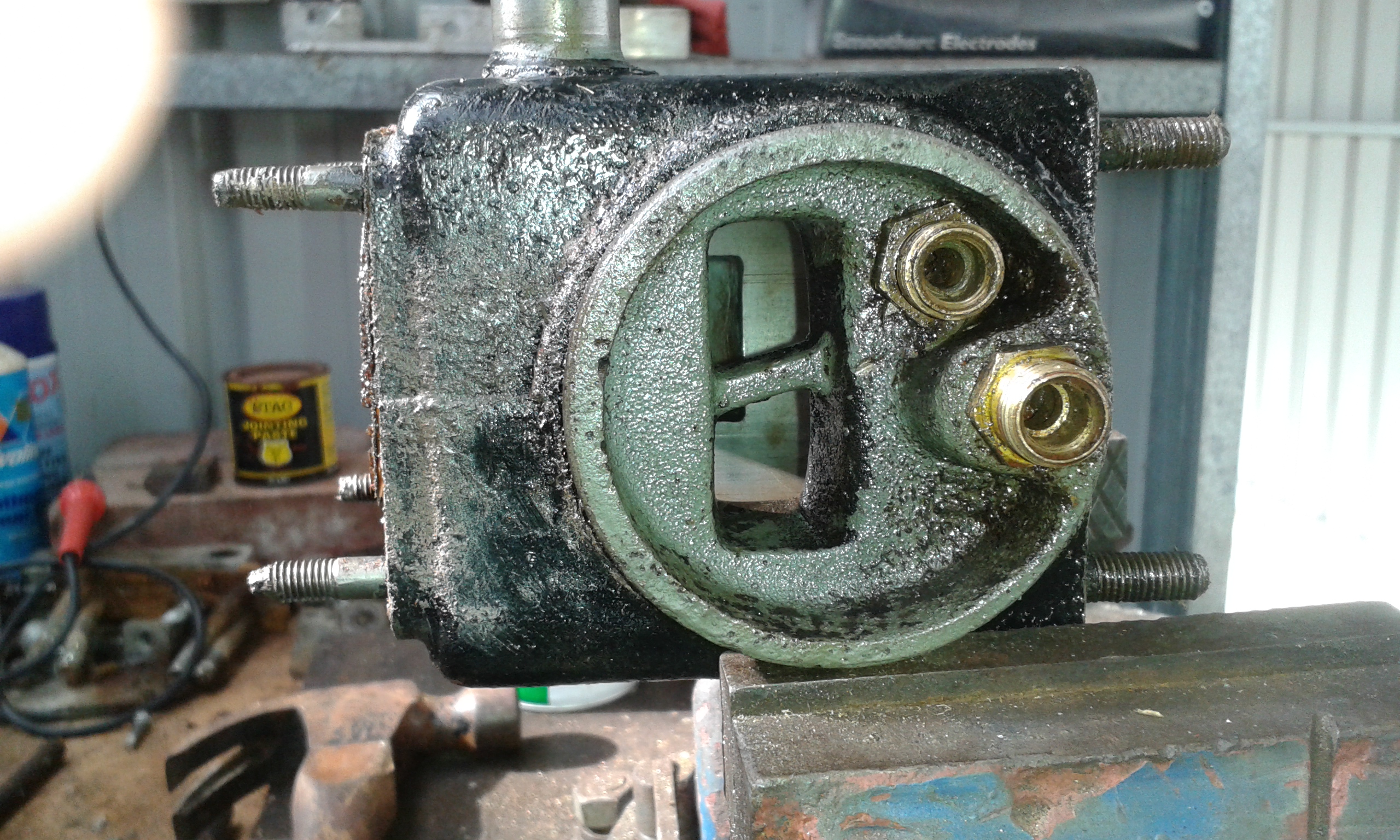

But is loud, boy is it loud. the two holes in the exhaust, are like another pipe on there own.

This is one way although I don't recommend it. Charles thought that the extra hole was drilled to allow water back into the exhaust for quietening, seems like a good way to starve the motor of cooling water to me. Interesting what you find when you open them up. Any one else come across this?

I'm not surprised....way to much water in your drum. Must be at least eighteen inches above the water pump. Think of those poor exhaust gases pushing through all that water to escape. They come out the holes instead with hell've a racket. Lower the level and let us know the difference.THCL500J8 wrote:But is loud, boy is it loud.
