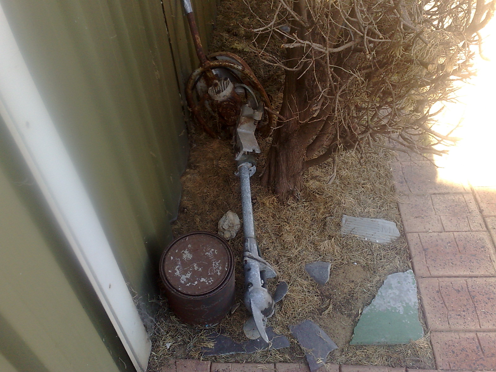

Parts only motor as block cracked but still no excuse aye.
Poor thing is now under scrutiny as to what is what.................................under cover.
B[/color]
