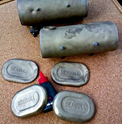

I attach pictures of my ends, complete with dents etc - I have tried the best I can, with the two on the bottom, albeit with simply a ball pein hammer, and somewhat predictably, they are still a long way from right. The photo on bottom left does not show the small dents which are there.

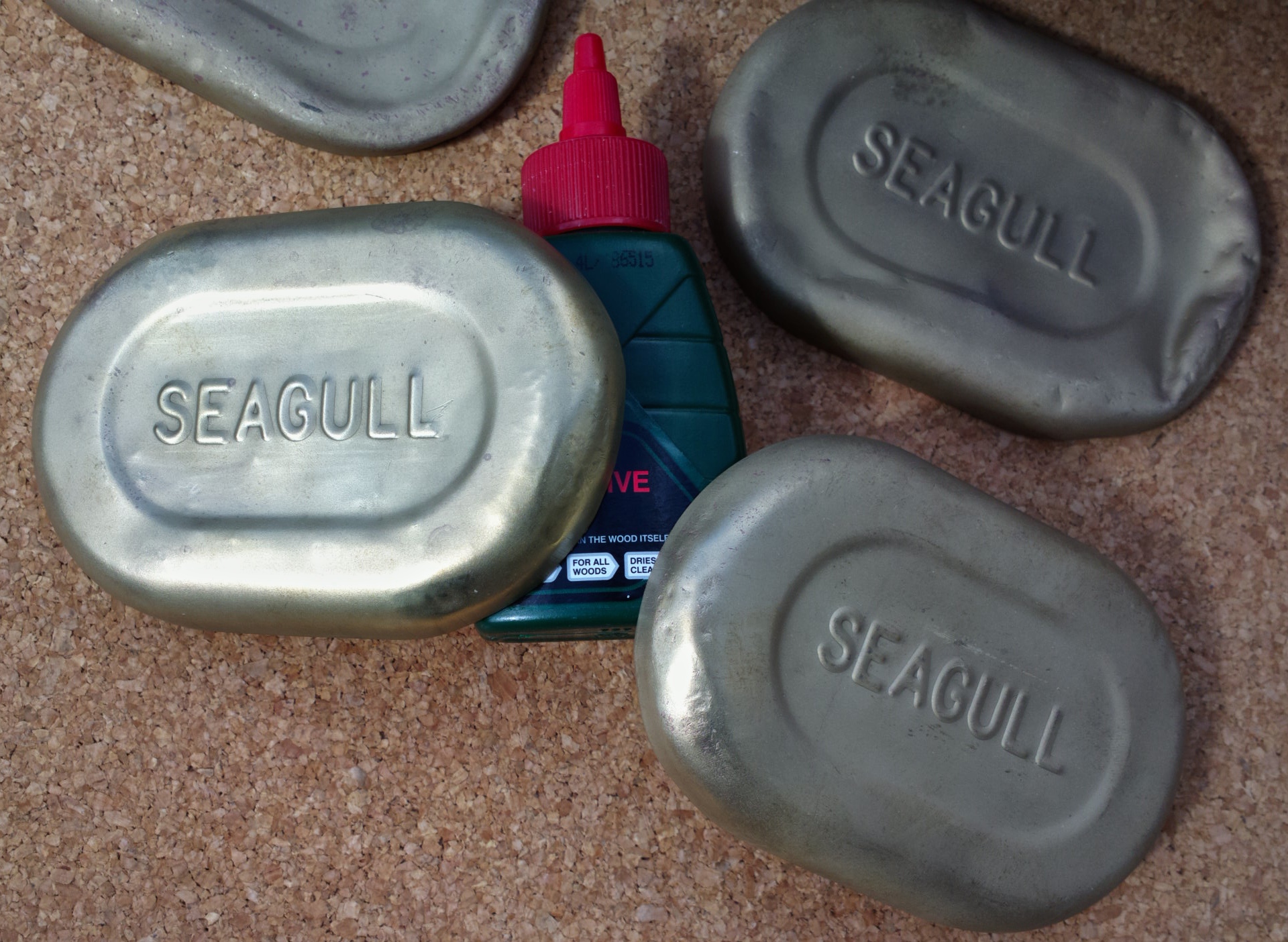

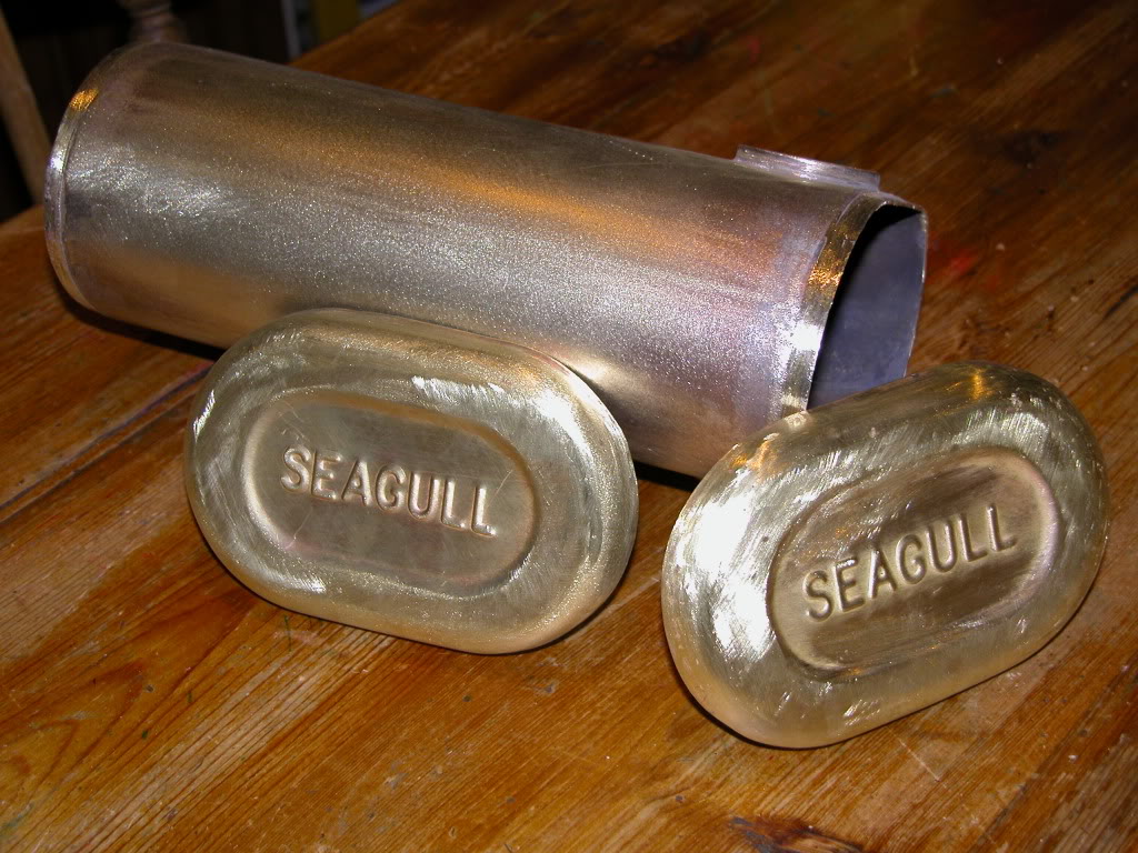

I attach H-A's ends from "102 slowly coming back to life", on 8/9/09 at 5.26 pm - they are beautifully perfect
How is this done?

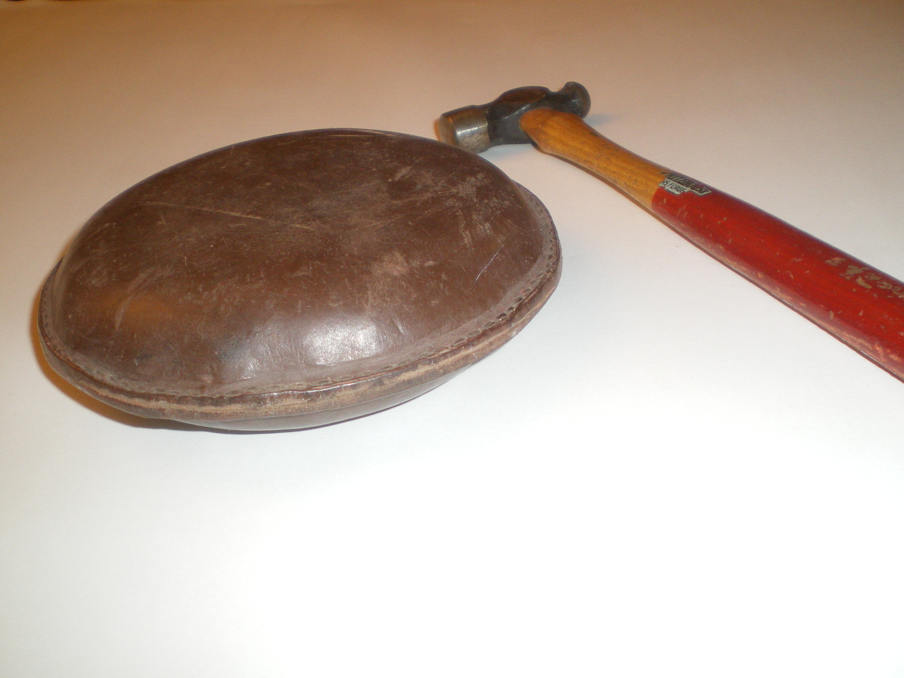

I've been awaiting a reply but alas none has been forthcoming. I recently took ownership of a jewellery making kit which included this old leather dolly. Soon as I saw it I immediately thought of its use in repairing tanks. I seemed to recall that a bag of sand has been recommended.

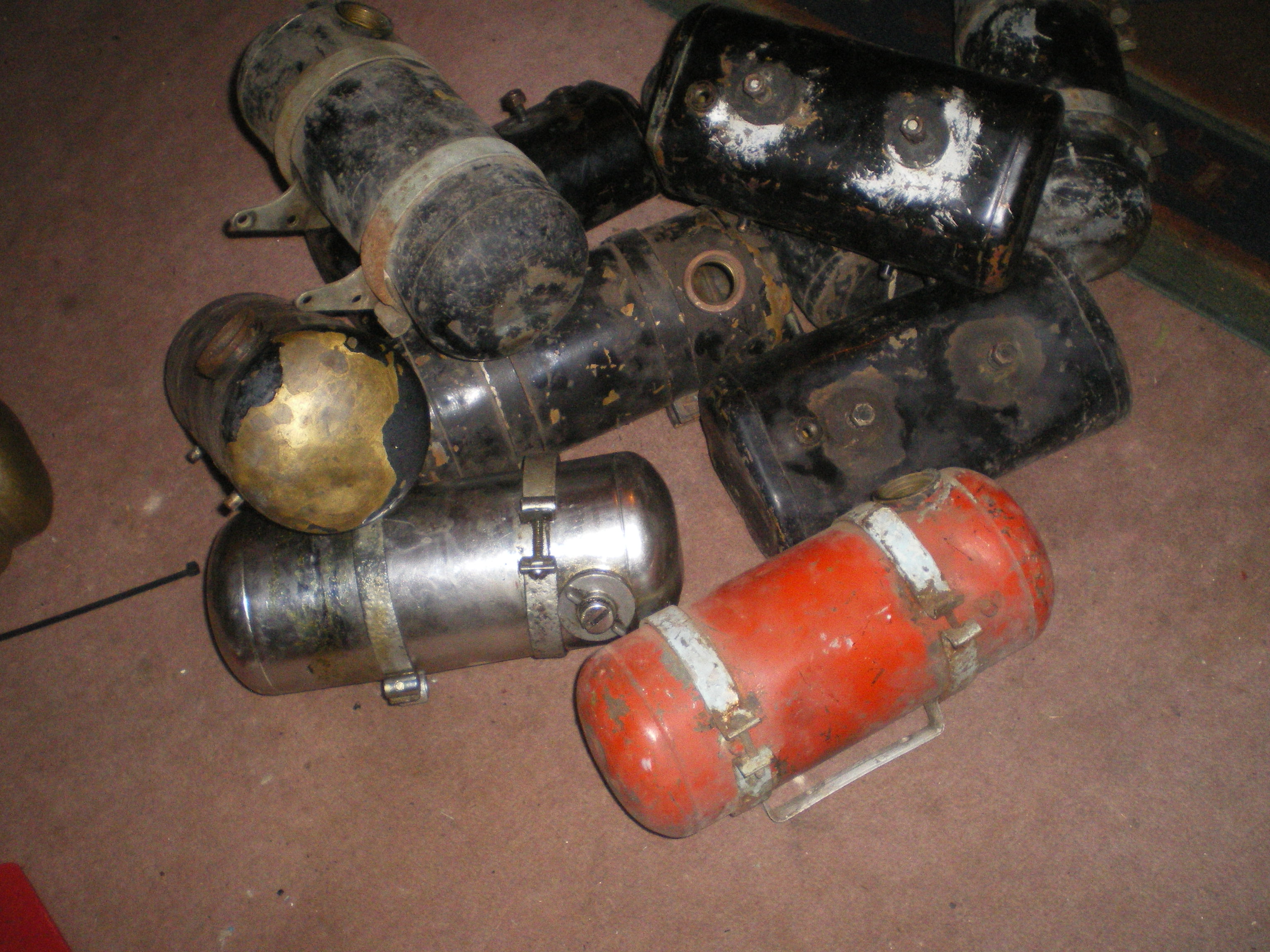

I have a few spare tanks that needs work and is something I would like to experiment with though the big bang does worry me. Maybe a male and female pattern could be made up that can be used with a press. One set in the world would be enough and ends could be done on an exchange basis. 102 and centuries.

My problem exactly - the trouble is that the ball pein hammer is not the right radius, so leaves little dents. Should I be thinking of a Sealey £77 set of panel beating hammers and dollies?
Now there's a question for the fully qualified engineers out there - how difficult is it to make up the male and female moulds, and how expensive? There would potentially be a large market, given the number of 50's, 60's and 70's open flywheel seagulls out there

I had a mate that was a guild trained boilermaker and alas I meant to get some tips from him before he died! One thing that comes to mind is that soon as a dent is created the metal has been stretched so bashing back in shape is going to be difficult as now there is a slightly larger surface are. How do we shrink metal? Even contouring with a ball pein hammer would be stretching the metal. Panelbeaters may have answer to this. Here is an interesting article which mentions stretching. Maybe a a set of correct hammers is more important that the dollies.
