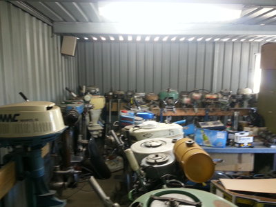

OK
It was actually in the North East Corner Inner Rack.........

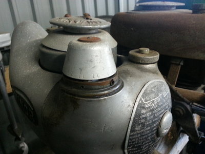

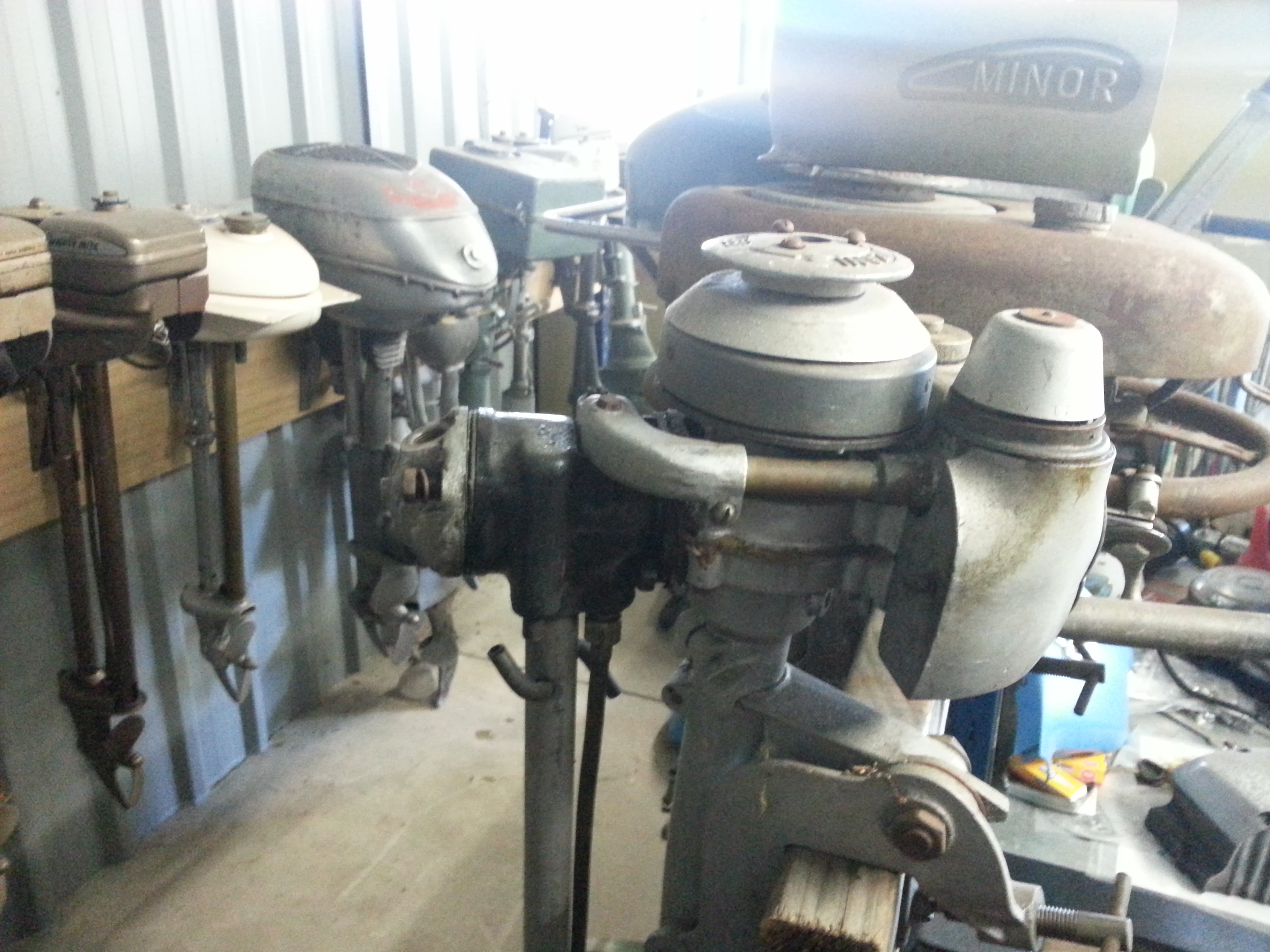

Re: British Anzani Minor help needed
Thanks Collector Inspector,
That is very interesting looking. Would it be asking too much to get some more pics of the head and that carb. Im guessing that it would be near impossible to get a carb off the shelf.
I am into metal casting (as part of the hobby) so with a few measurements and pics I will be able to make a better looking head than the one that I have.
Now that carb, That is different! Is it a carb or more of a needle valve?
I have had a good look on the net, so far I've come up with very little. You have shown me more with 3 pics than I have been able to find. Thank you very much.

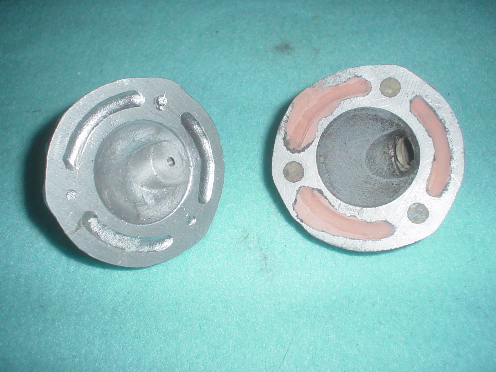

How about I lend you the pattern so you can cast your own head?
There is a jig for sparkplug drilling @ 14mm tapping size as well. I think it is 120 Degrees................Clamps into drill press.
Working pattern is on the left.
Important before you consider that offer you have to see if there is anything left of the mating surface of the barrel. The head "Land". If it is corroded from within and thin.................there is no point.
A problem area to consider. What looks OK on the surface may not be useable.
This one has corrosion under the Land so no "Meat" for clamping.
It does "run" but not for actual use.
The "Carb" is an air valve/mixer. See the pic with reading instructions on the front plate then everything will be clear.

Shed looks good B 8)
You've been a busy boy.

Just a few things from me - see if the y make sense! On my Minors, which are Mk ll's, the carb. inlet is on the port side of the motor, and is a 'U' shaped casting bolted to the to of the cylinder, and terminating in a vertical position with a flange. A proprietary little Amal carb. is bolted to this flange - this carb was fitted to lawn mowers of the day, but having a bottom entry fuel feed.
Your aluminium part of the carb intake looks original, but just fitted to the wrong side of the cylinder!
The carb has no speed control , - speed being regulated by an advance and retard lever mounted on the magneto stator plate.
The little aluminium saddle bracket on your petrol tank is where a choke lever and cable were fitted, which was routed around the flywheel in a rigid aluminium tube.
