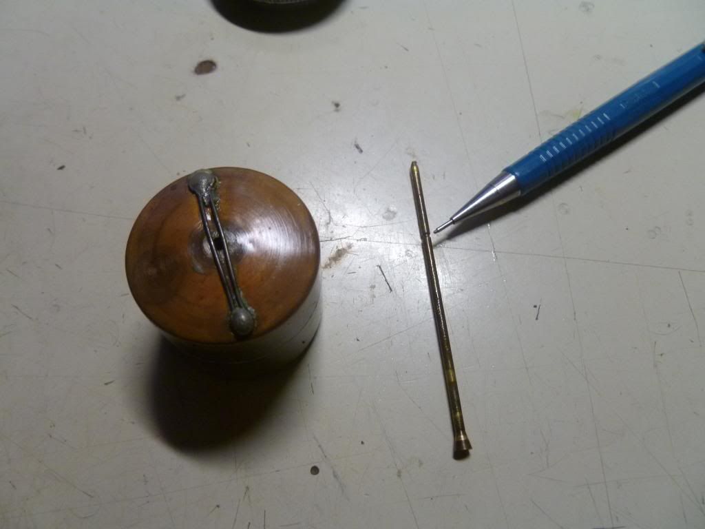

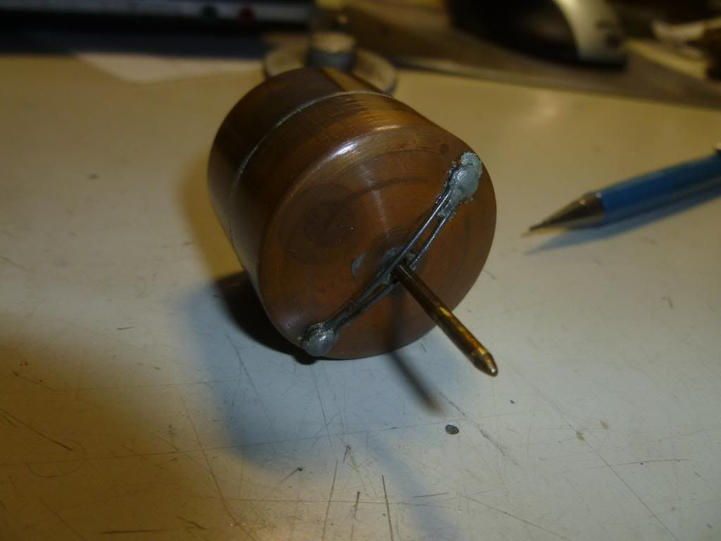

In the float bowl there is a needle that gets through the floater. On the needle where the floater is attached there is a gap. You could check this if it is standing there correctly. The gup is there for the wires of the floater to mount on.
Please see the pics, I may not describe it in the correct way. Where the pencil points is the gap.
About the orientation of the float bowl I don't think there is a matter. It has happened to run my engines trying both orientations and there was no difference.

Say, that's a nice float. Mine's a nylon one. And lovely clear pics.
The floats located on the needle ok. That's the thing, everything looks good and seem in order, only the results are disappointing. Starvation is certainly the issue though, tickling the carb while on an open throttle lets the engine pick up. Tomorrow I'll try having the float a little above the needle notch. Thanks again for being so helpfull, it's great having other gull fans to bounce off :)
