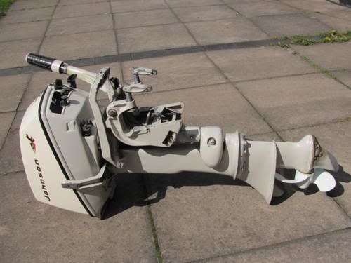

Have had to make room in the shed, bought 2 more today.
Dirty and local, has a spark and fires 1965 Evinrude 6 (Canadian), this one has the remote brackets that I need.
Very clean, dry stored in house for 40 years in the spare bedroom, Johnson 6 1966.
(not picked up yet) never seen the salt.
I must sell some others, or get a cat :wink:
