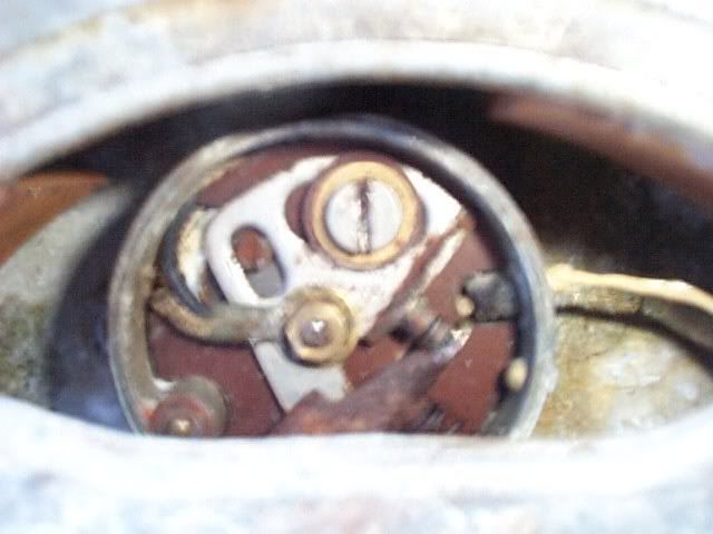

Hi I'm trying to get a spark on this thing:)
any advice?
can someone tell me what points gap to set?
where can i get a new points spring?

In the meantime start with a 20 thou gap and make sure that the contact faces of the points are clean and well polished. Whatever abrasive you have used to clean the points it is always a good idea to close the points on to a strip of thin card and then withdraw it. Repeat this several times. This clears away any grit and dust. The slightest speck will be enough to prevent a spark in such a low voltage circuit.
I doubt if you do need a new points spring unless it is physically damaged. John Williams , who runs SOS and hosts this forum, will surely have a replacement. His details are on the home page. And his phone number is in the logo at the top of each forum page; useful if you are in the UK .

The spring is almost broke due to rust.
20 thou=what in metric please?.....oh i see its 0.5 mm:)
