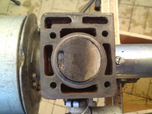

Well i went for it this afternoon the bolts came out easy would the clogging in the first picture have caused my problem? i cleared it with a small tool then flushed it with fresh water and a large capacity syringe hopefully the second pic shows how it should look. I have used the original gasket as it looked fine.
Before will this have caused my problem
after

Re: cooling flow
Perfect.
Let us know if it has worked.
I think having a look in the waterways will ensure that there is no problem there for a good few years.
P.S. the only other thing that might be worth doing is to drop the leg and exhaust off an make sure that the water feed pipe and union that is screwed into the block are clear. But this is just belt and braces.
Looking at the general condition of the engine it should all come apart quite easily, so if nothing else you will have familiarised yourself with some of the other parts.

Re: cooling flow
Took it out for a run today and all fine loads of water coming through now it started second pull as per ran a tad lumpy for 5 mins then the revs picked up and it ran perfectly. thanks for the help

Your water jacket before cleaning, is not what you'd call a bad one, unless the tell tale area or the inlet water tube fitting had a blockage, you wouldn't expect any major problems except a slightly reduced flow.
A bad one is when 80 to 95% of the water jacket is packed solid with a rust coloured concretion & compressed air will only just pass through. Yours looks like 10 minutes with a 6mm bar & it's almost ready for reassembly, I think Ha means by bad is one, is one that you have to start cleaning with a masonary drill bit in the cordless drill, just to find where the voids are supposed to be, then another 2 hours sculpturing work with a long electrical screwdriver & a toffee hammer.
