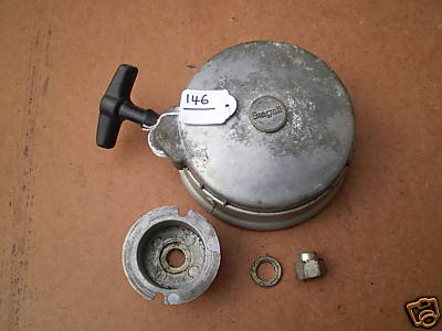

Does it look like this ?

As per H-A's picture, bottom left is the "cup" that those flaps engage.
Basically it's a metal on metal contact that allows you to spin the flywheel.
You can use wd40 inside the "wizzy" bit where the clock spring will be, but as Hugo mentions try to keep any lubricant away from the cup.

Thank you very much for your help! All is revealed - the picture of what I thought of as the starter pulley cracked it.
When turned upside down the "pulley" becomes a cup and the inside edge showed a lot of vertical score marks - from the flappy bits that emerge from
the recoil mechanism when pulled. When assembled in the right order and the right way up the puzzle was solved. Motor now back together.
Thank you for the tip about the WD40 ... gave the inside of the cup a going over with sandpaper to improve grip. Recoil works like a dream.
