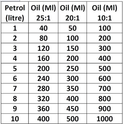

I'd recommend TCW3 because its biodegradable. The brand is irrelevant unless you intend to go racing, and only then if you supe up your engine, and even then any synthetic blend will do. Here's a cut-out-and-keep handy-dandy table for the use of...

Re: Idiot's guide to fuel please
That makes it nice and easy.
Thanks Martin
Thanks Martin

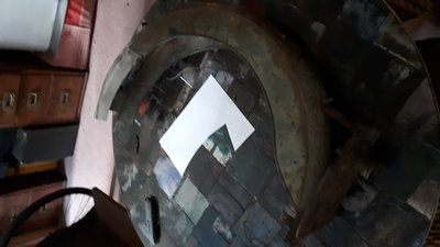

This might look familiar to you John. Was doing some patch welding yesterday.

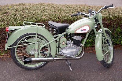

Bantam?
Yup. 1950 D1.
Did the post office use them there too!
SOS
SOS
I don't think so but what l did learn was that UK industry was directed to produce goods for the export market to increase the coffers after WW2. Excellent record were kept by BSA and this one left the factory on 24th of October '1950 and was freightered to a dealer in Melbourne. We have a lot of early 102's in Oz and we were probably targeted as a prime market for gulls as well. Lots of books on BSA Bantams but not so for Seagulls.... l find that surprising.
I do like the Early Bantams
I was very tempted to buy one, but have not passed my bike licence, had to stick with mopeds.
Yep, that is the same as mine except I've got a pillion saddle instead of the rack. Just need to collect a few more parts and reassemble. I need to get a bike licence too. I used to ride with just an 'L' plate but they are stricter 40 years on now..
