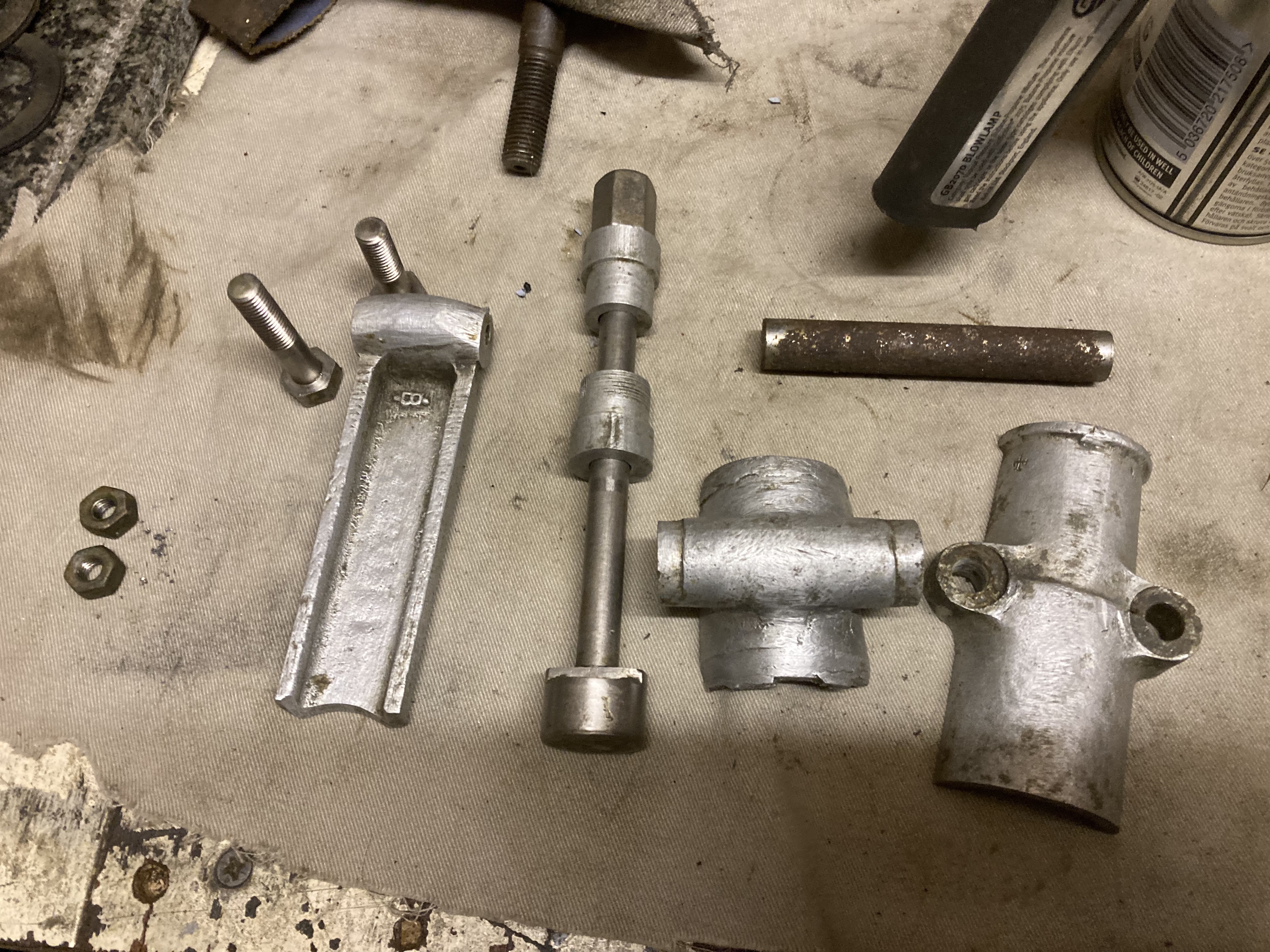

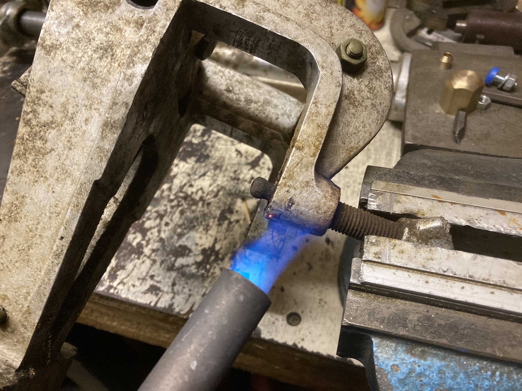

I've had this engine for quite a while, but have finally got around to doing some work on it over the last 2 winters. So I'll show the work done bit by bit, and the issues found.

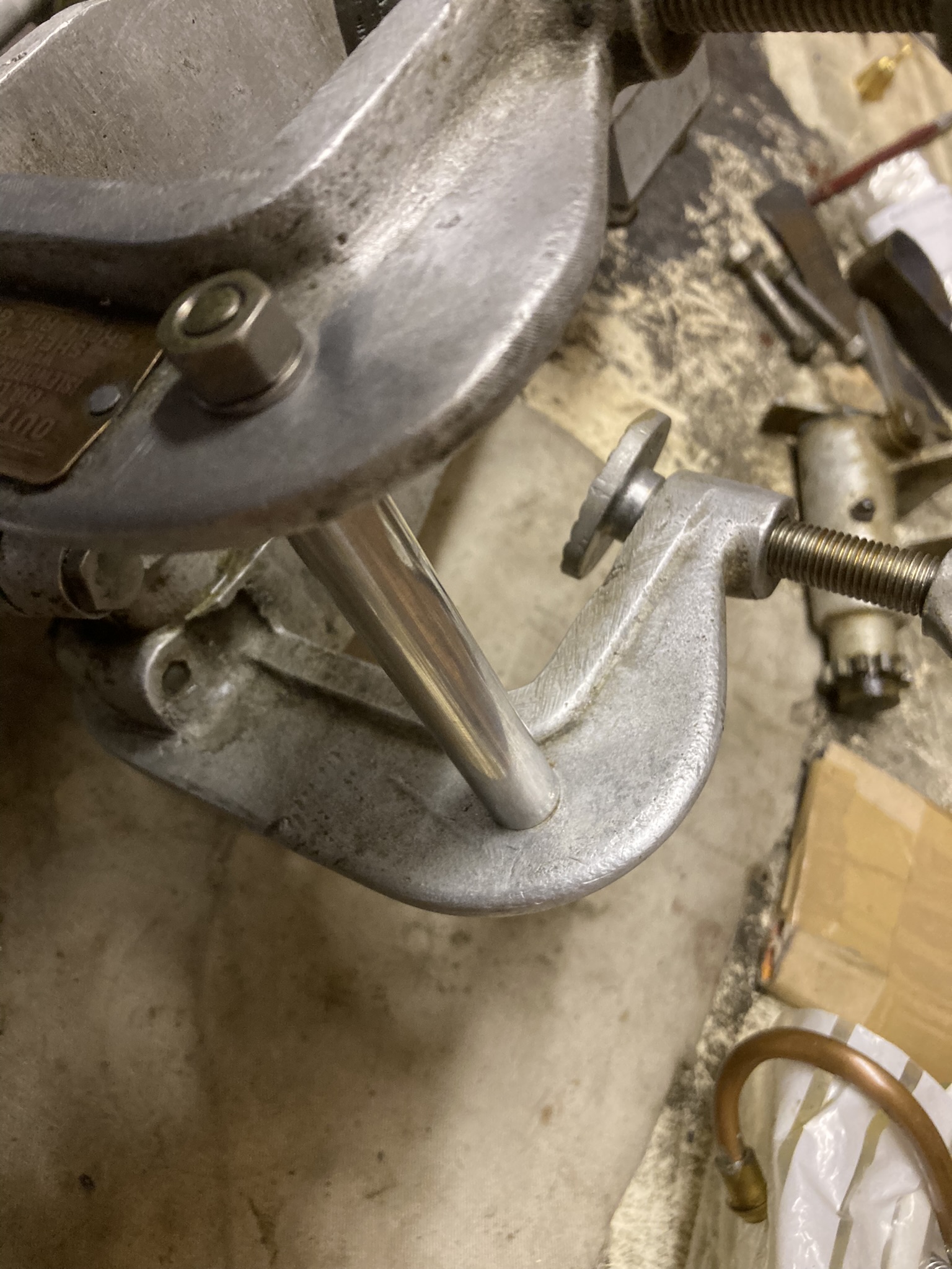

First job was to do a general clean and check over, followed by taking a close look at the transom bracket. It was mostly all there, but several seized up fasteners to deal with. It had a broken and seized screw in place, which came out with a little heat and gentle persuasion, followed by re-cutting the threads and fitting new screws, I had obtained replacement transom screws and pads from the Marston Register.
The corroded cross brace bar on the transom bracket was pretty nasty and corroded, so I made a new one out of stainless, which polished up close to the original chrome.
Then a general clean and scrub of the bracket body, before reassembling, all threads freed and threads chased, and greased.
More to follow...

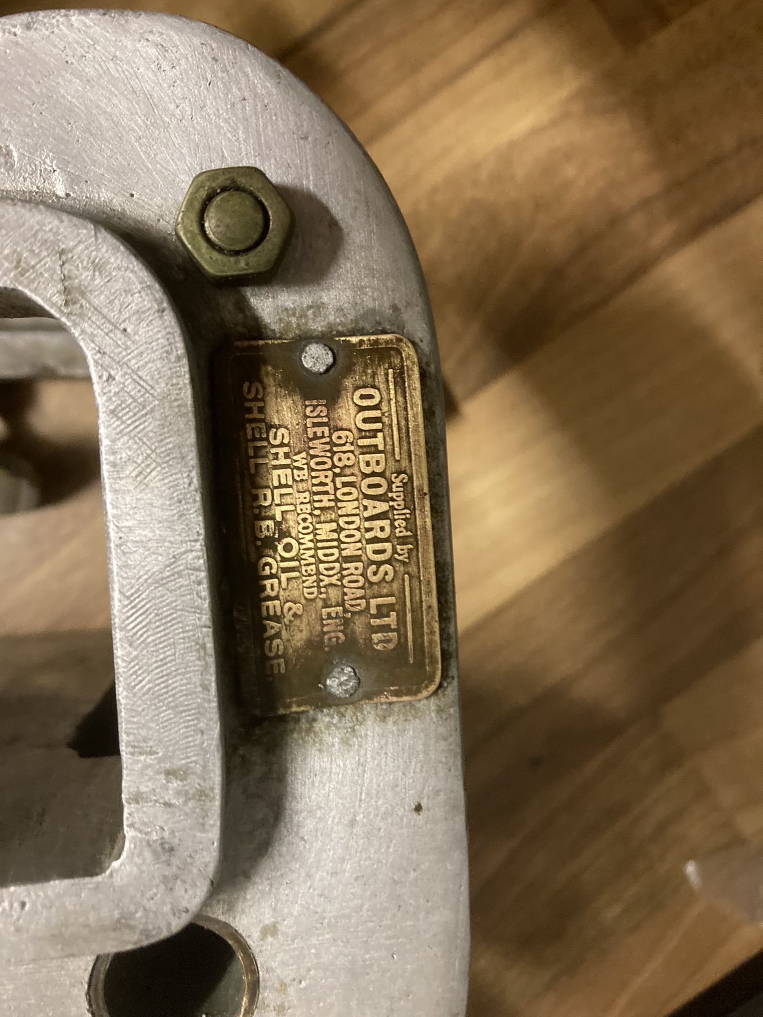

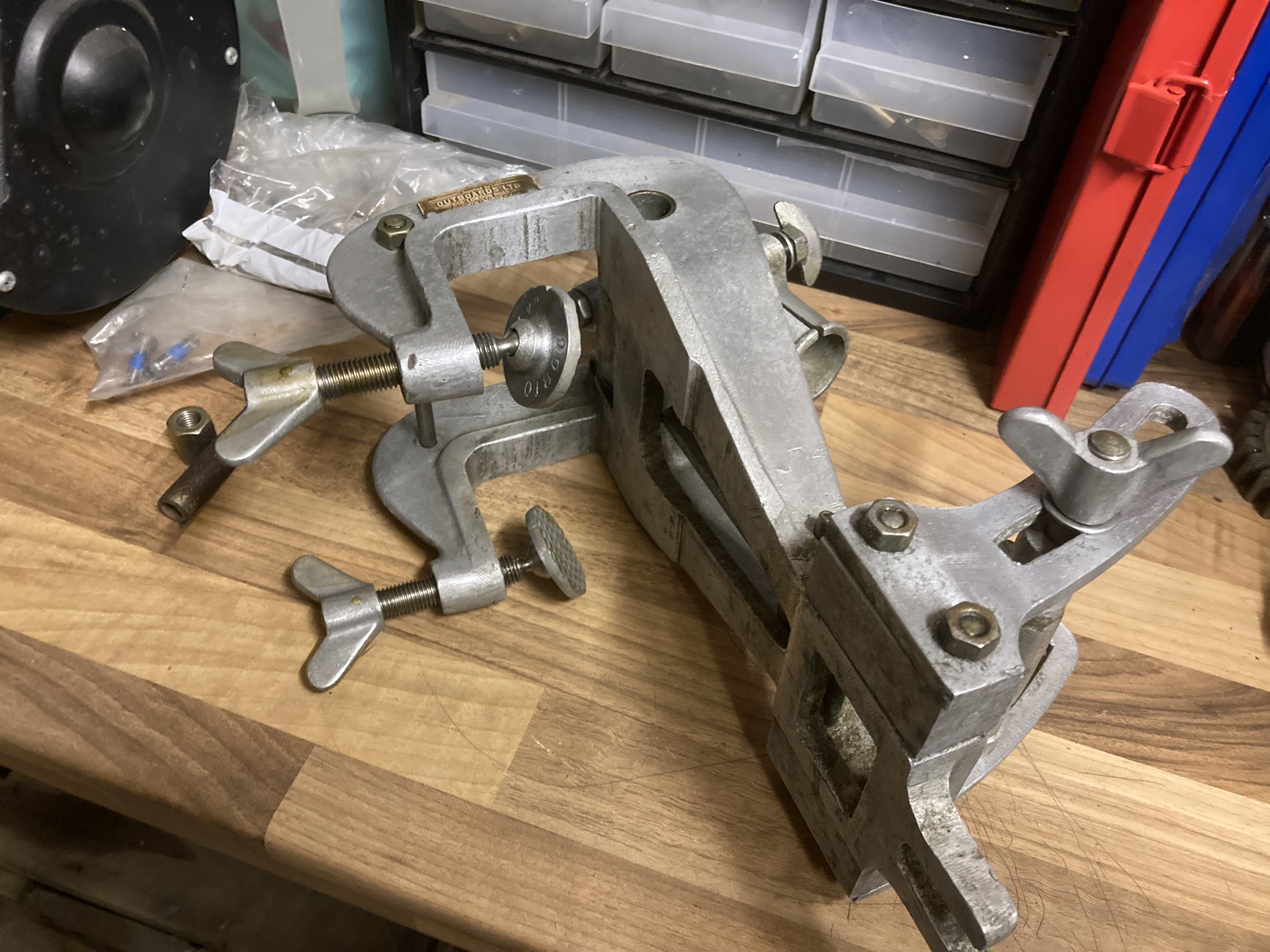

Finished bracket, cleaned, repaired and new parts fitted. Now 100% serviceable and functional.

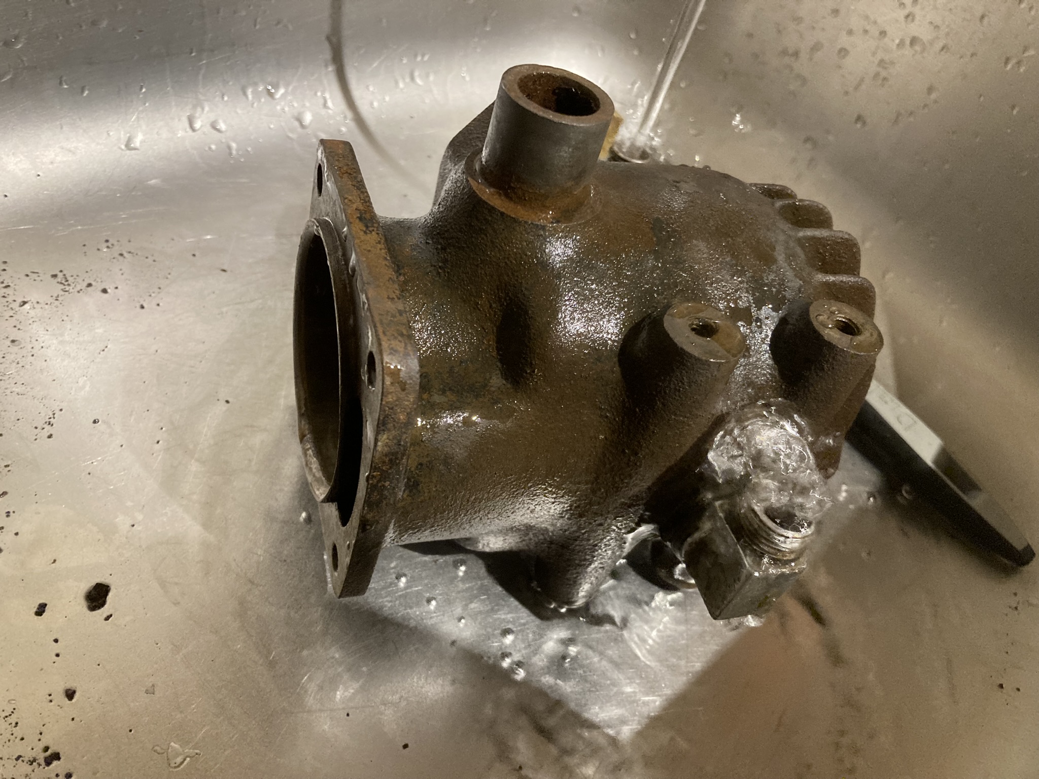

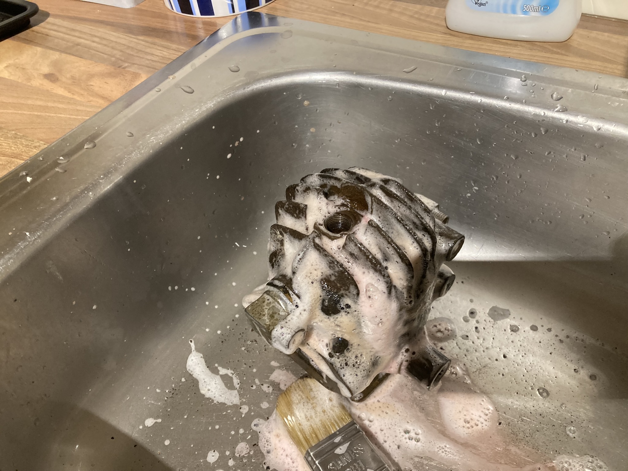

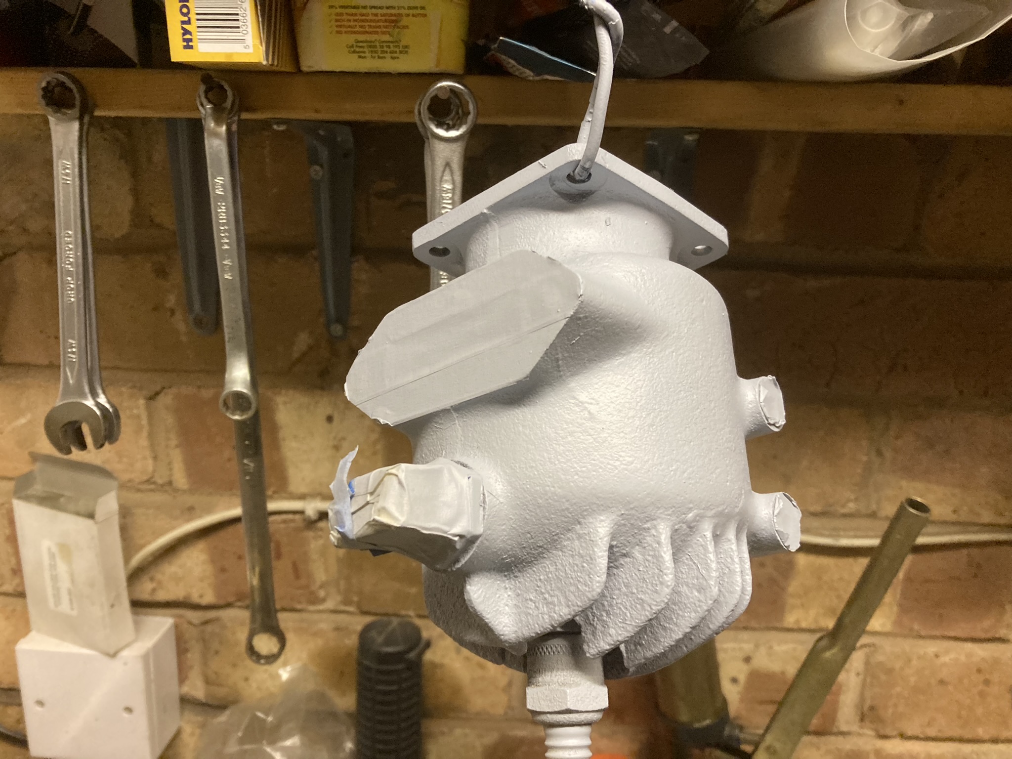

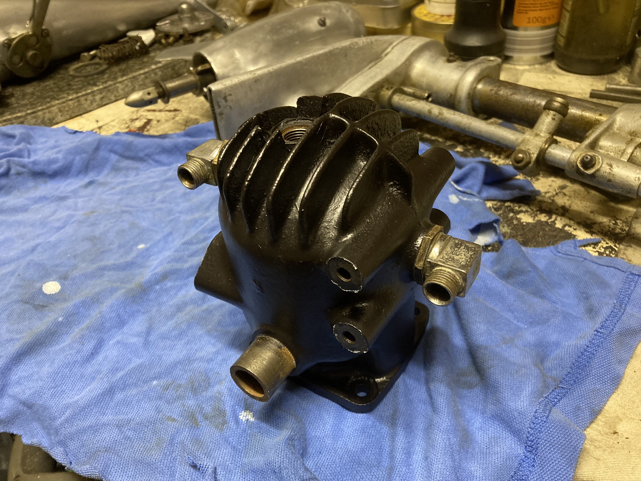

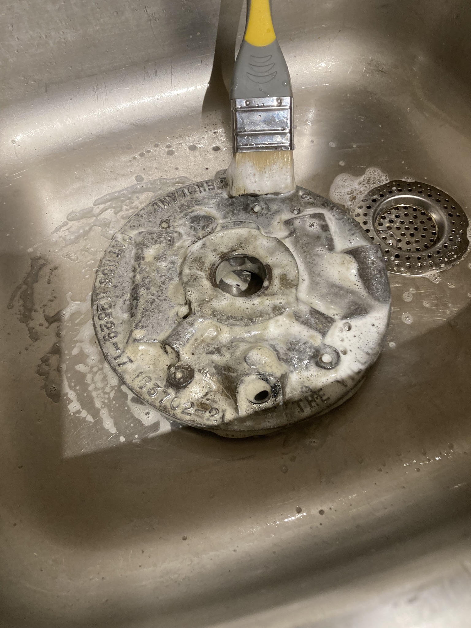

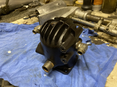

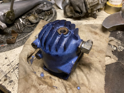

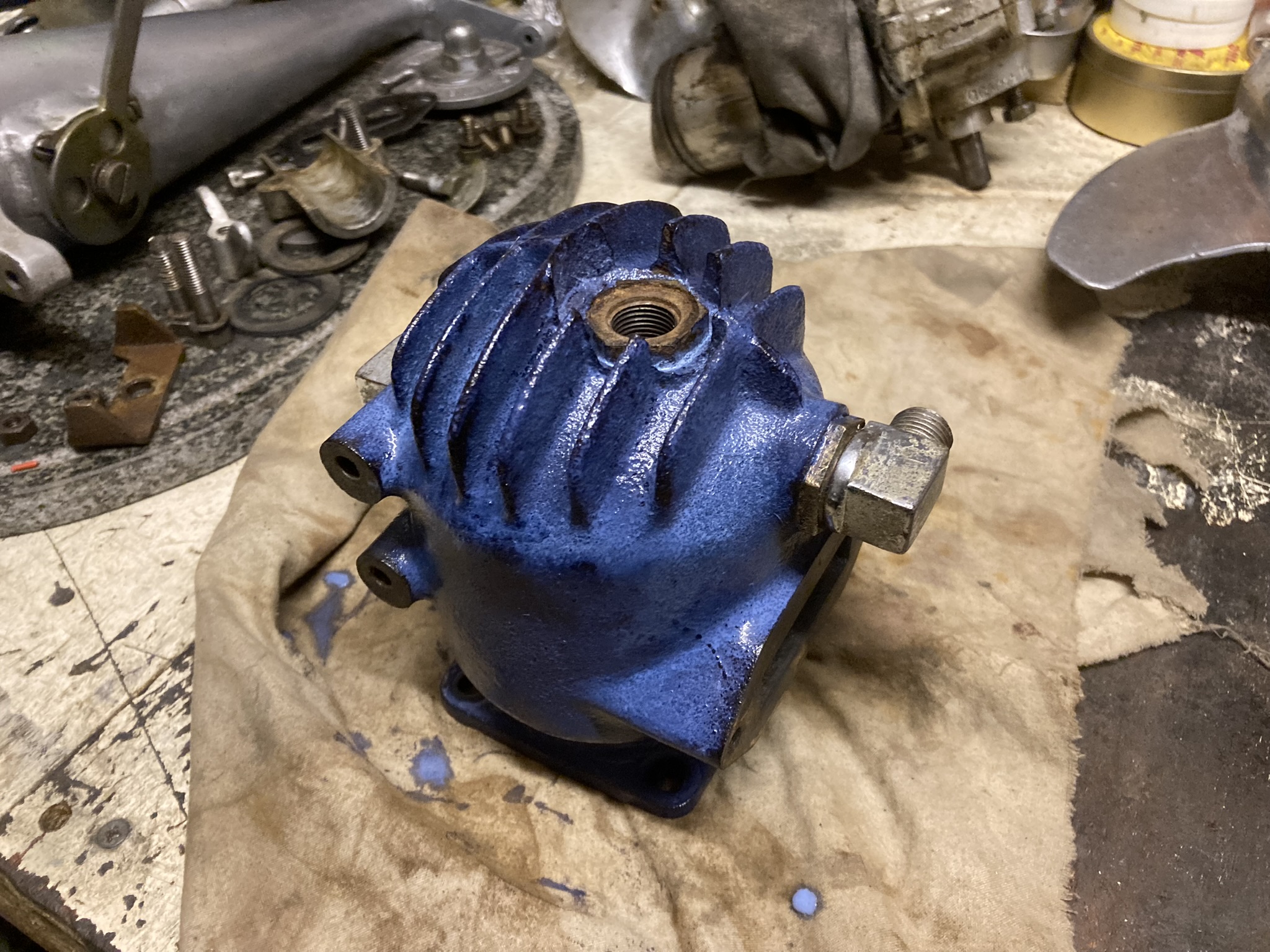

Next job after sorting out the transom bracket was to restore the rusty cylinder. A good degrease using washing up liquid and hot water, followed by a flush of the waterways.
To paint, prepare using a wire brush and rubbed down with emery paper. Then a coat of kurust to treat the corrosion, then a coat of etch primer, then 2 coats of VHT paint. Finally an hour on top of the log burner to cure the paint. A big improvement.

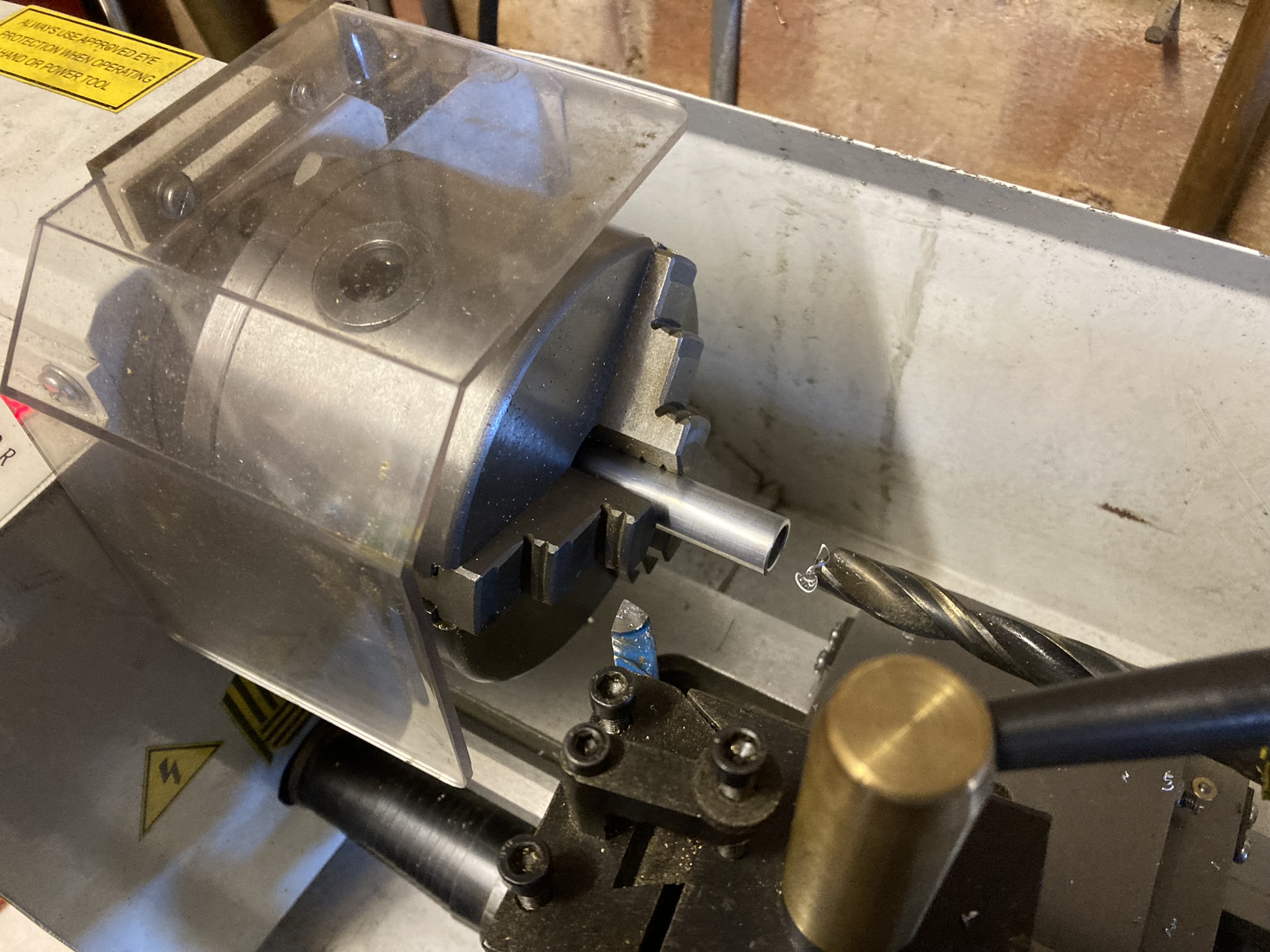

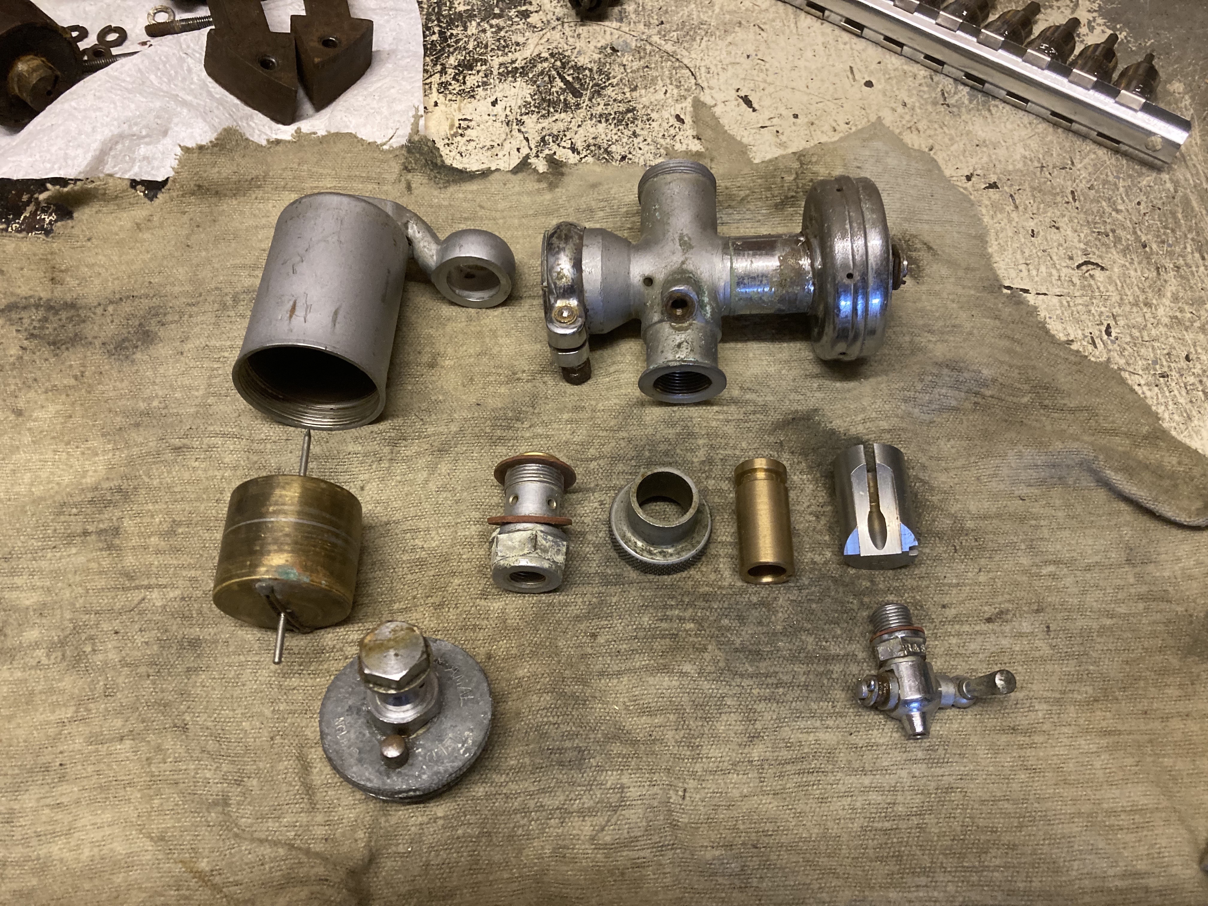

Next job was to strip and examine the carb, which was missing the small brass shaft that connects the carb to the gear linkage. With this model when you put the engine into gear, it automatically opens the throttle to whatever the throttle lever is set to. Drop it into neutral and the engine drops to tickover, set via the tickover screw on the carb. Clever 8) This is why this model has a cutout button on the tiller.

Yes, simple but clever. They did away with the FNR engines when they decided the reverse gear was rarely used and not needed and could save money. What a shame! The carb has a drain valve which is a great feature also.

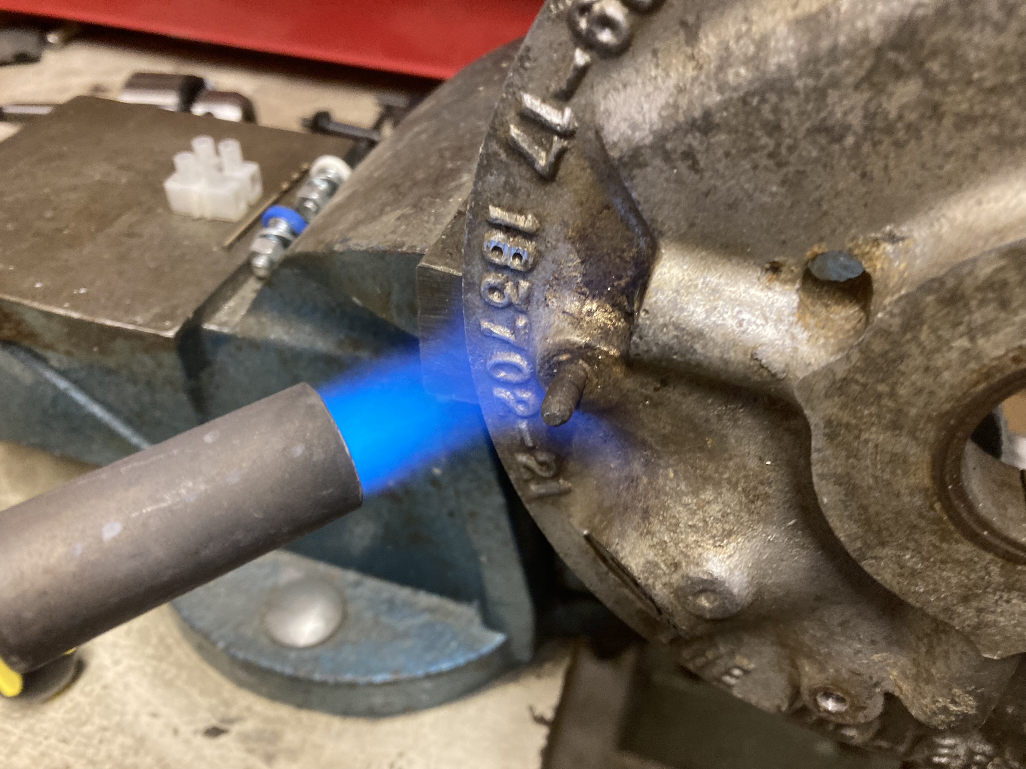

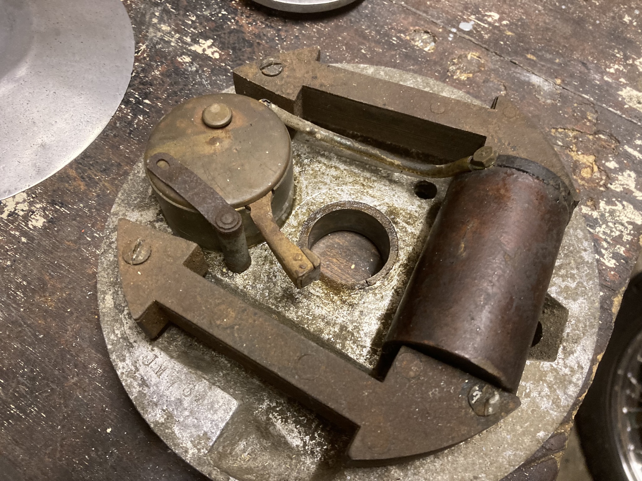

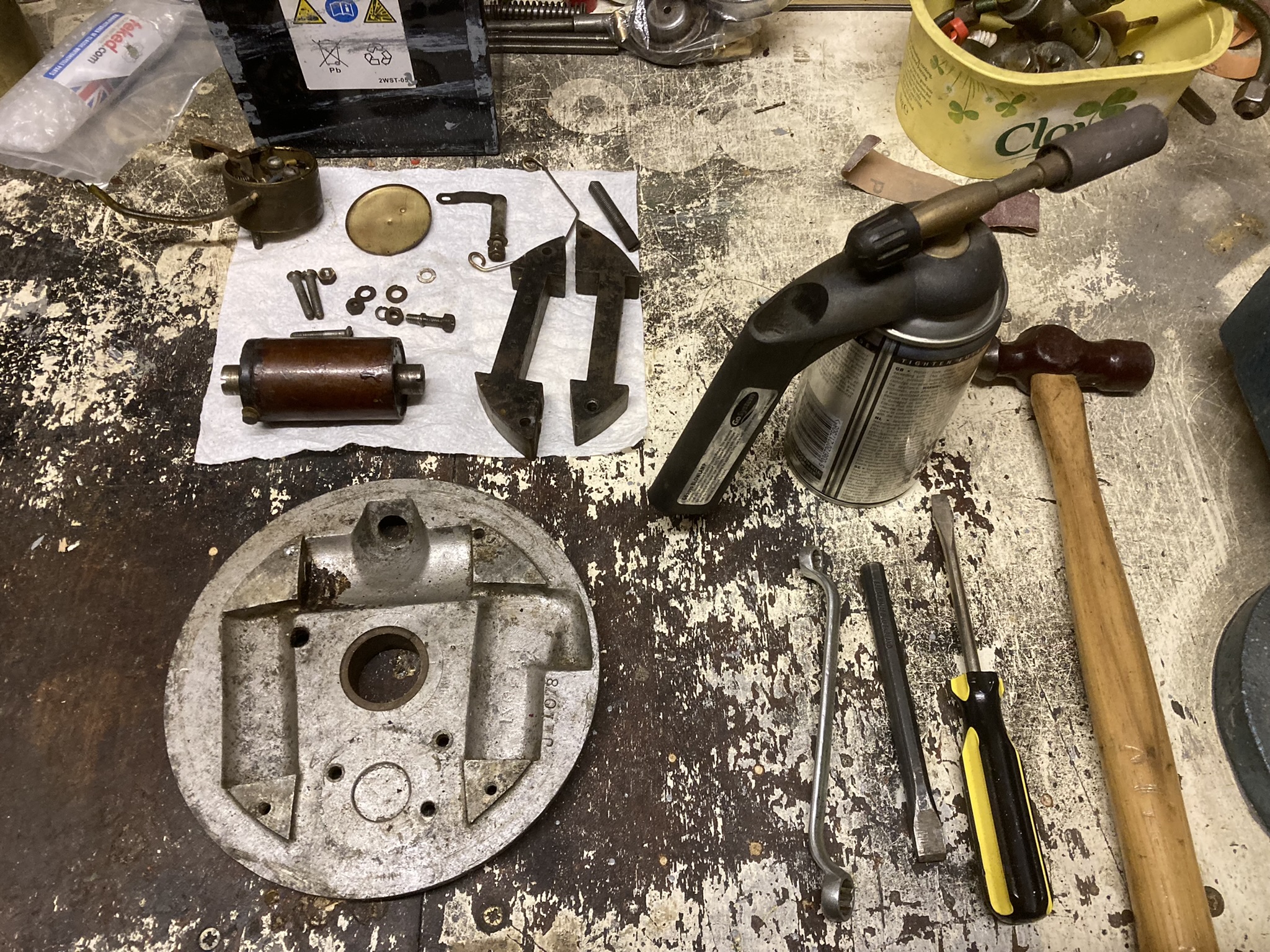

Next job was to strip the magneto, all fairly routine as its the same as later engines. The coil was of course dead, but new ones are available. Its always a good idea to apply a little heat, as a steel thread in an alloy casting will most like be seized. I even have a tiny torch with runs on lighter fuel, similar size to a big cigar 8)

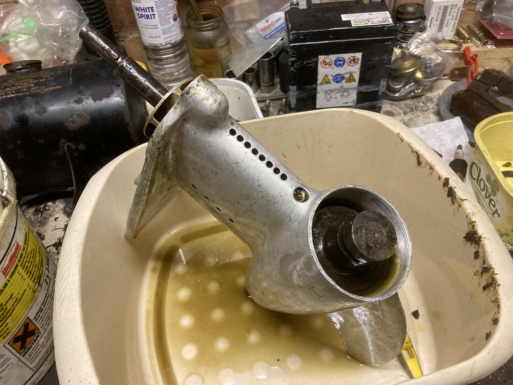

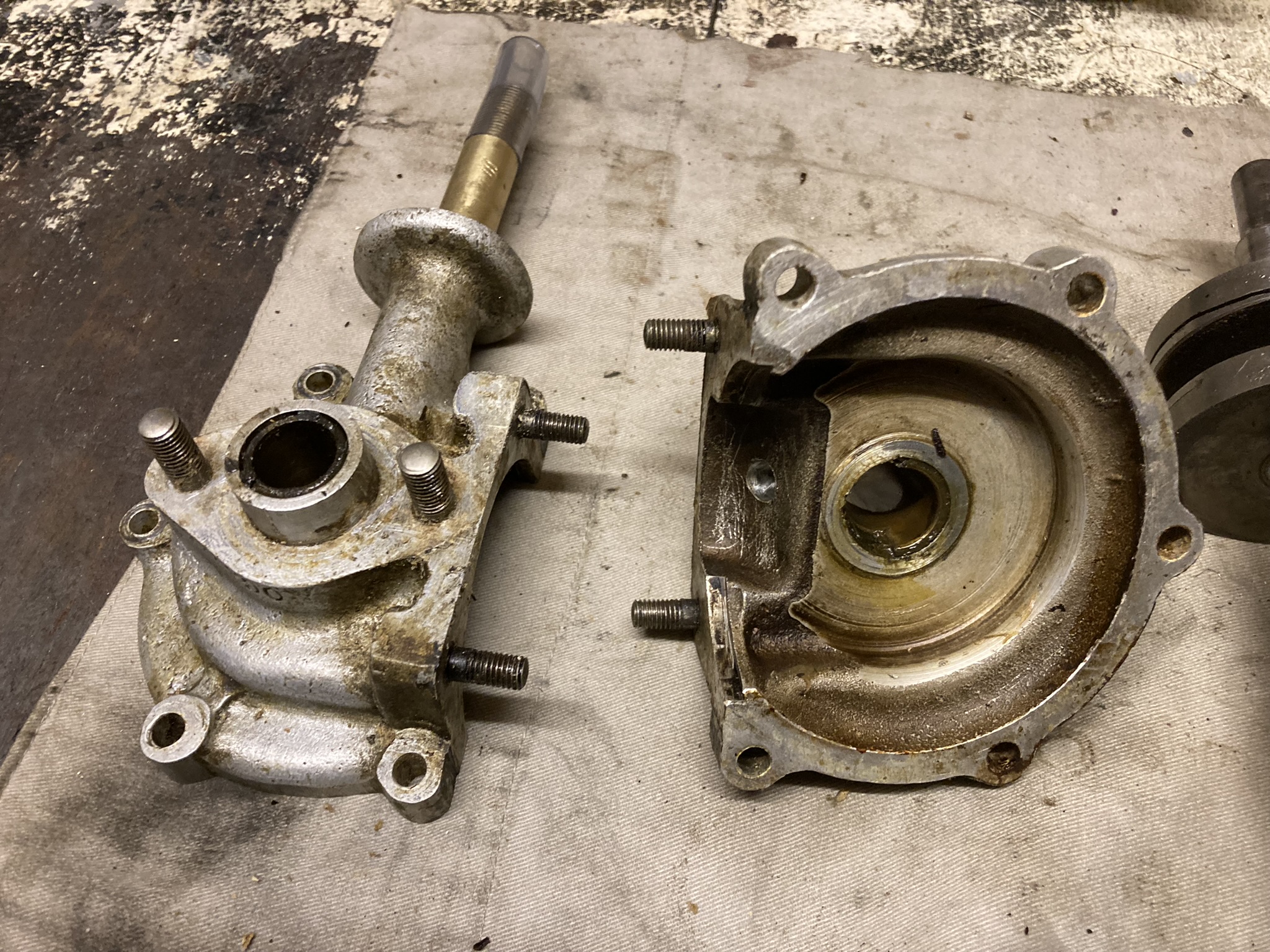

Next job was to investigate the gearbox, and would the end cap come off? I was hopeful as the FNR gearbox does not have the water pump behind the cap, so less chance of deep corrosion in the threads. Eureka!, it came off easily :D A full degrease and clean, and generally all in very good condition.

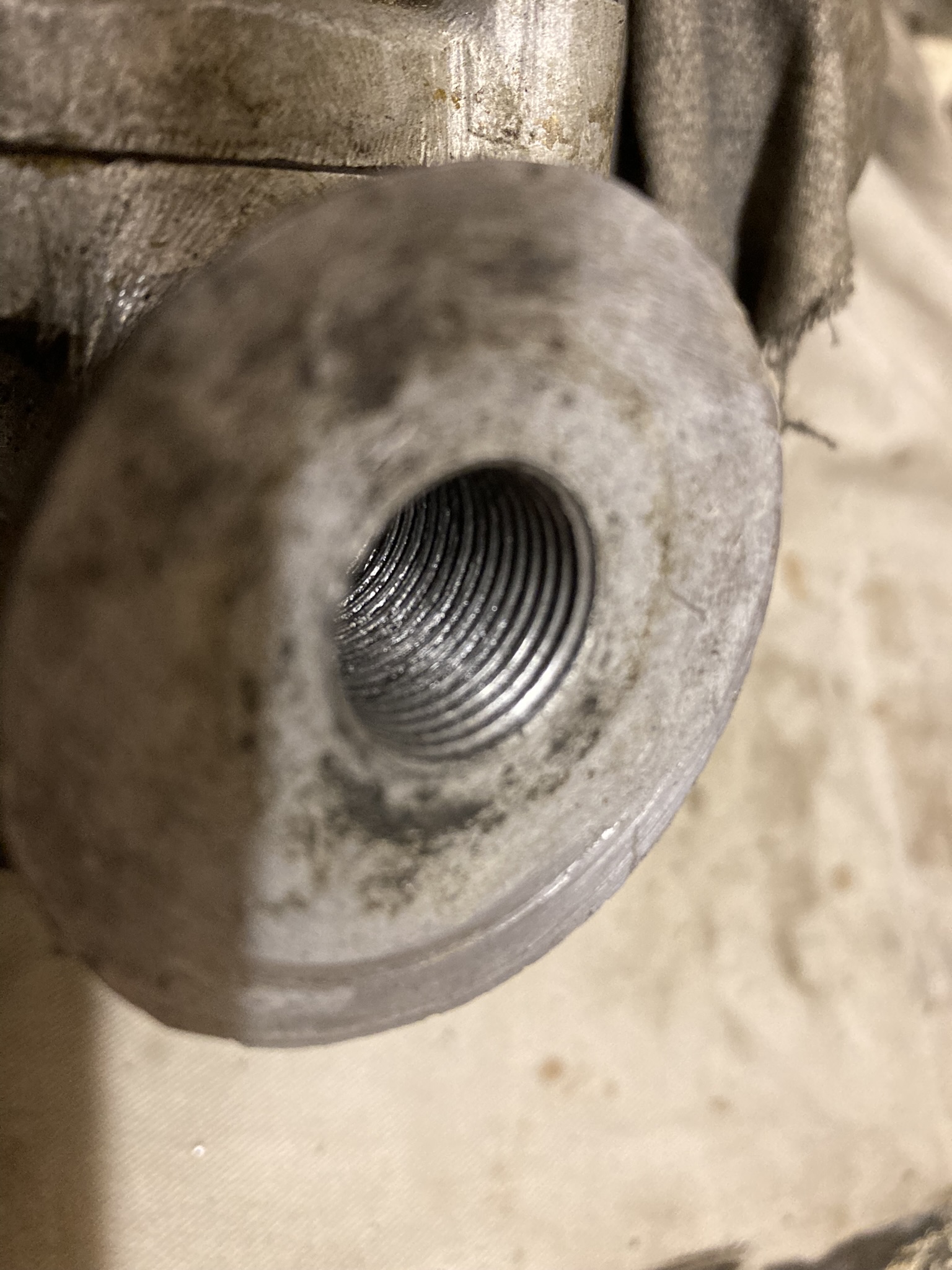

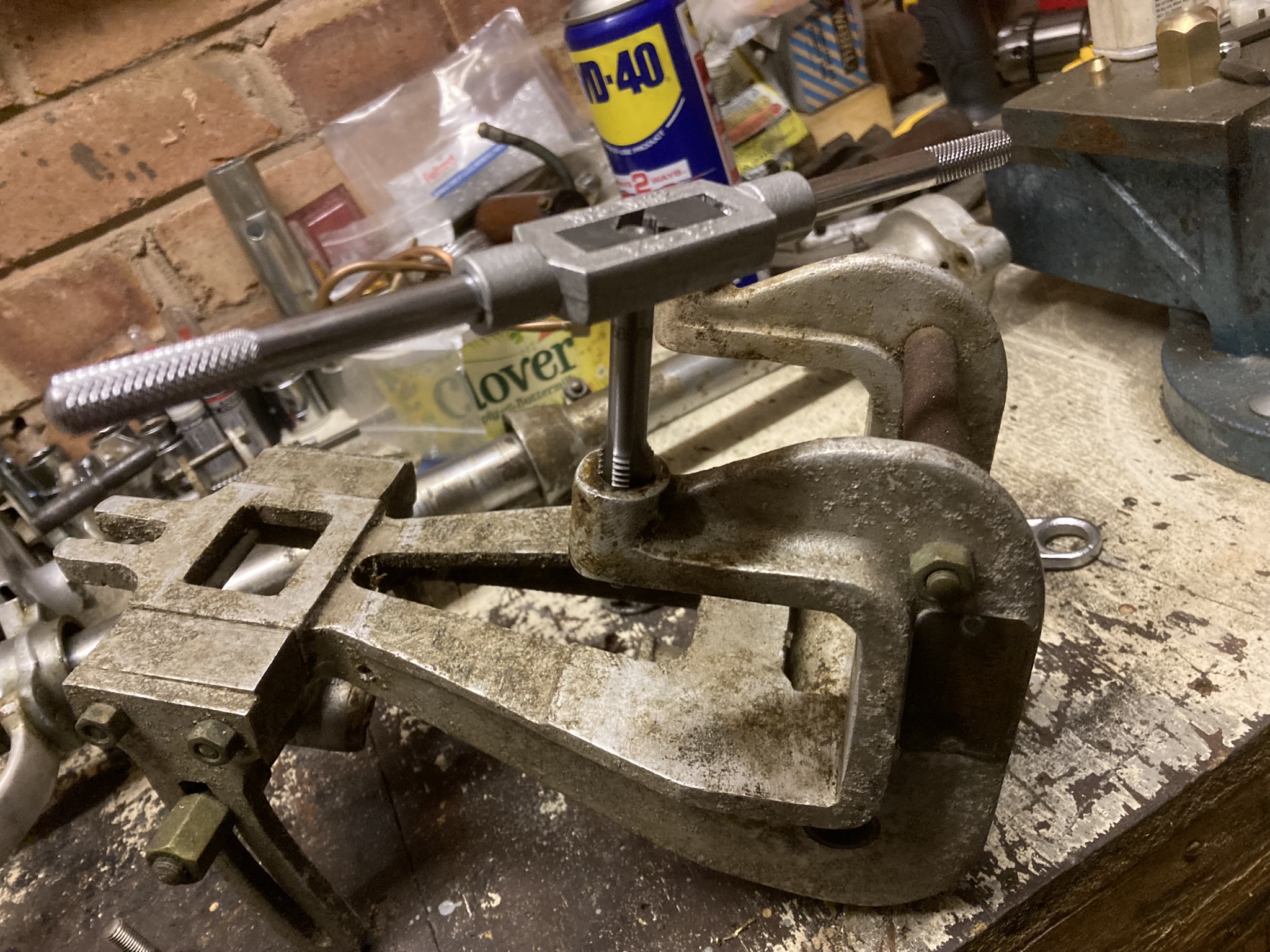

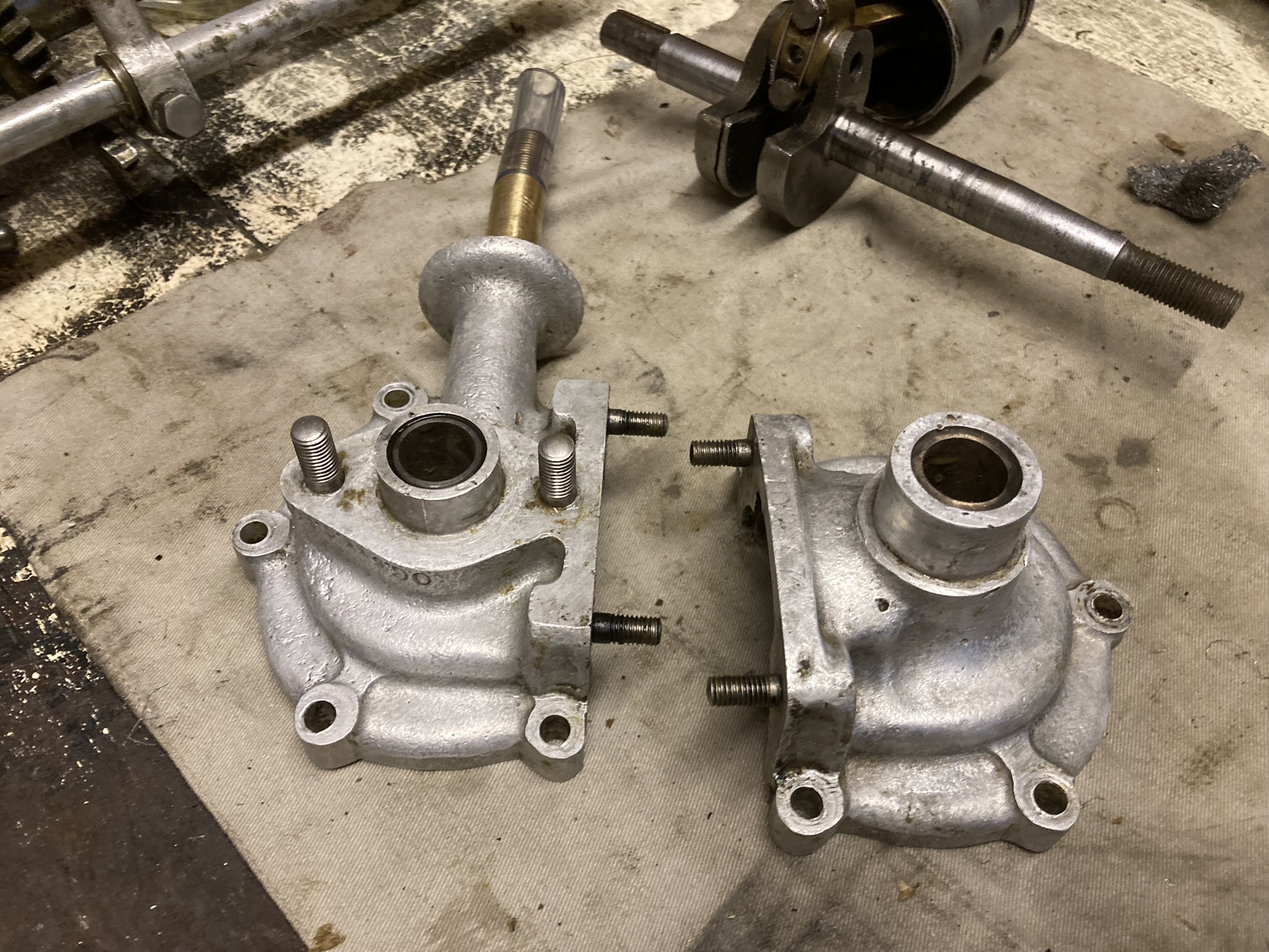

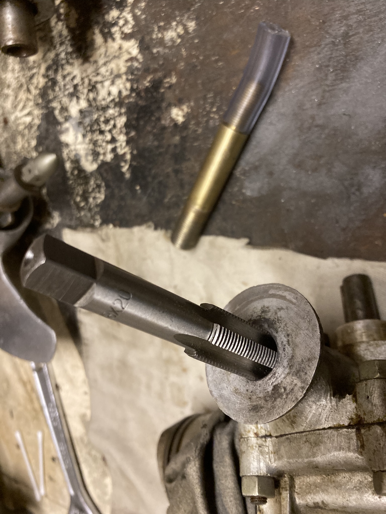

Next job was to give the crankcases a bit of a clean, and replace the tiller stub which had sheared. The original was made from monel, which is hard to find, luckily a brass SD one is identical. The treads in the crankcase for the tiller stub needed a light clean up by passing a tap through.
