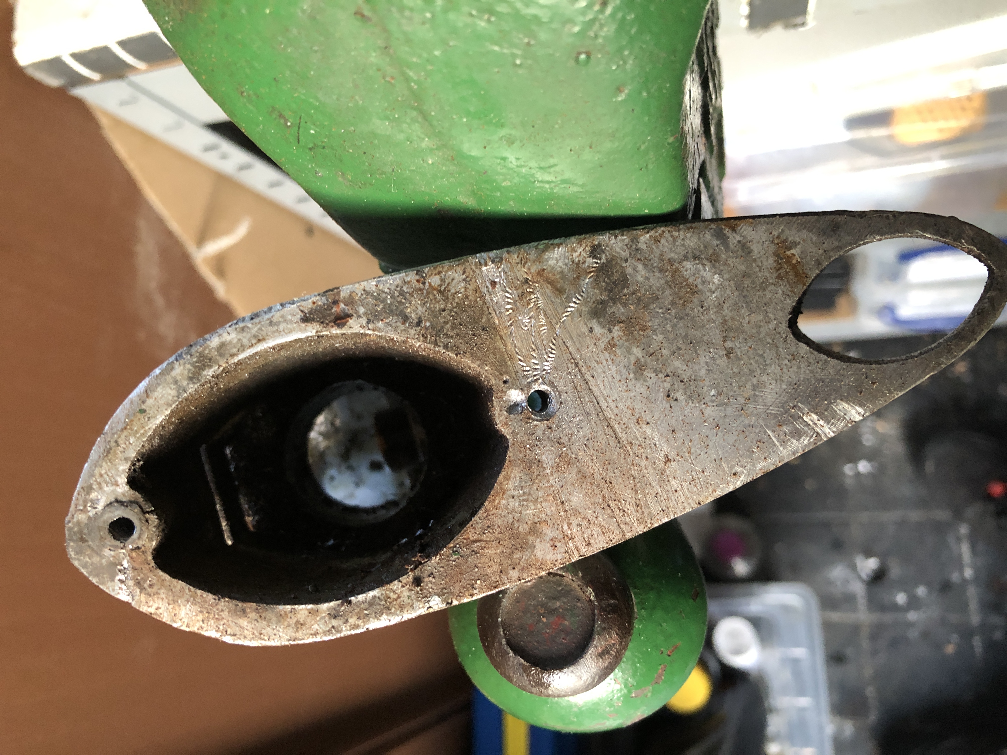

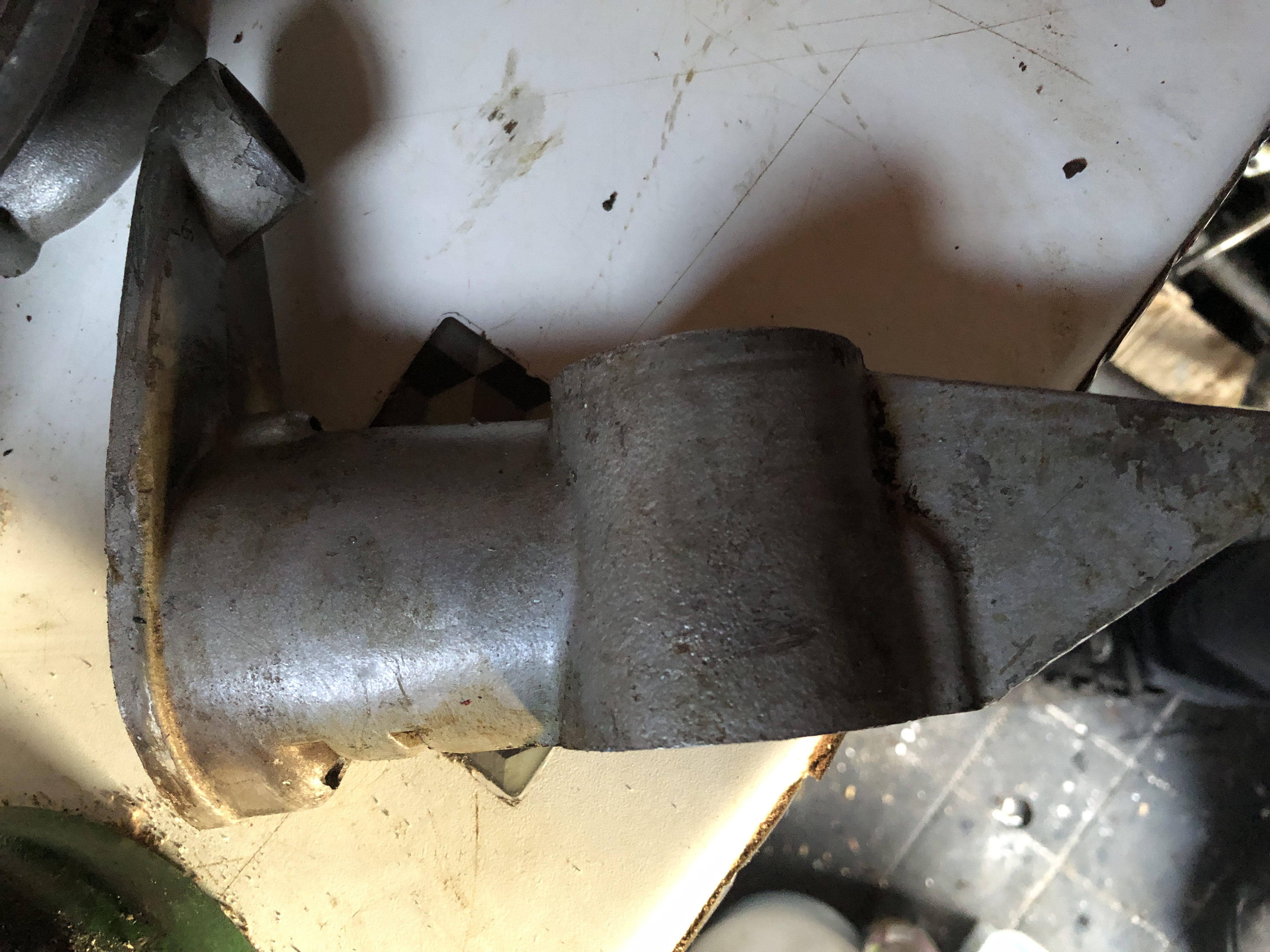

could anyone tell me the correct size thread for the gearbox housing of a forty featherweight, unfortunately one I have been tasked to work on has had the threads drilled and would like to see if I can repair it before trying to source another. many thanks in advance.
- Posts: 4960
Re: Forty featherweight gearbox
1/4 BSF, somewhere on here is a post containing all the thread sizes.
