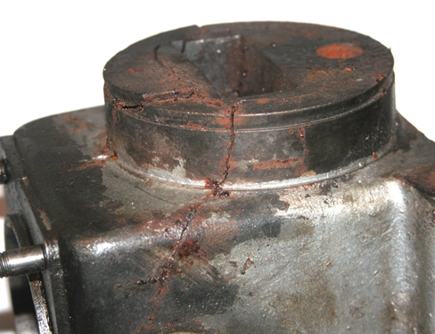

Let's carry this subject further can anyone with a "cracked" Silver Century cylinder, post pictures of the damage, so the areas most prone to salt water damage can be established.

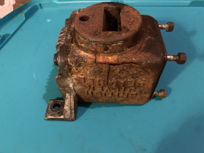

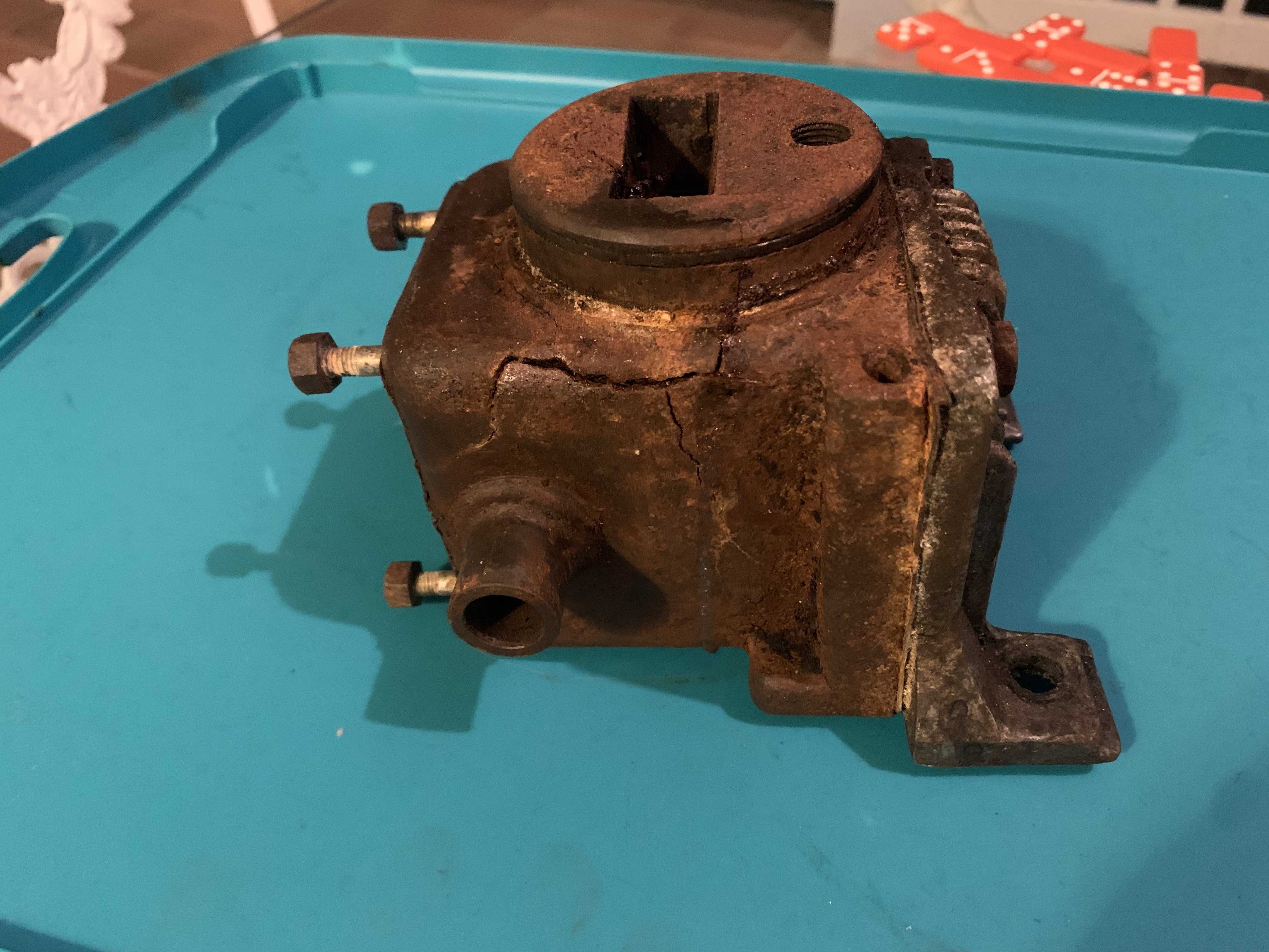

here is a rusty one
Re: Heat Transfer - POR-15

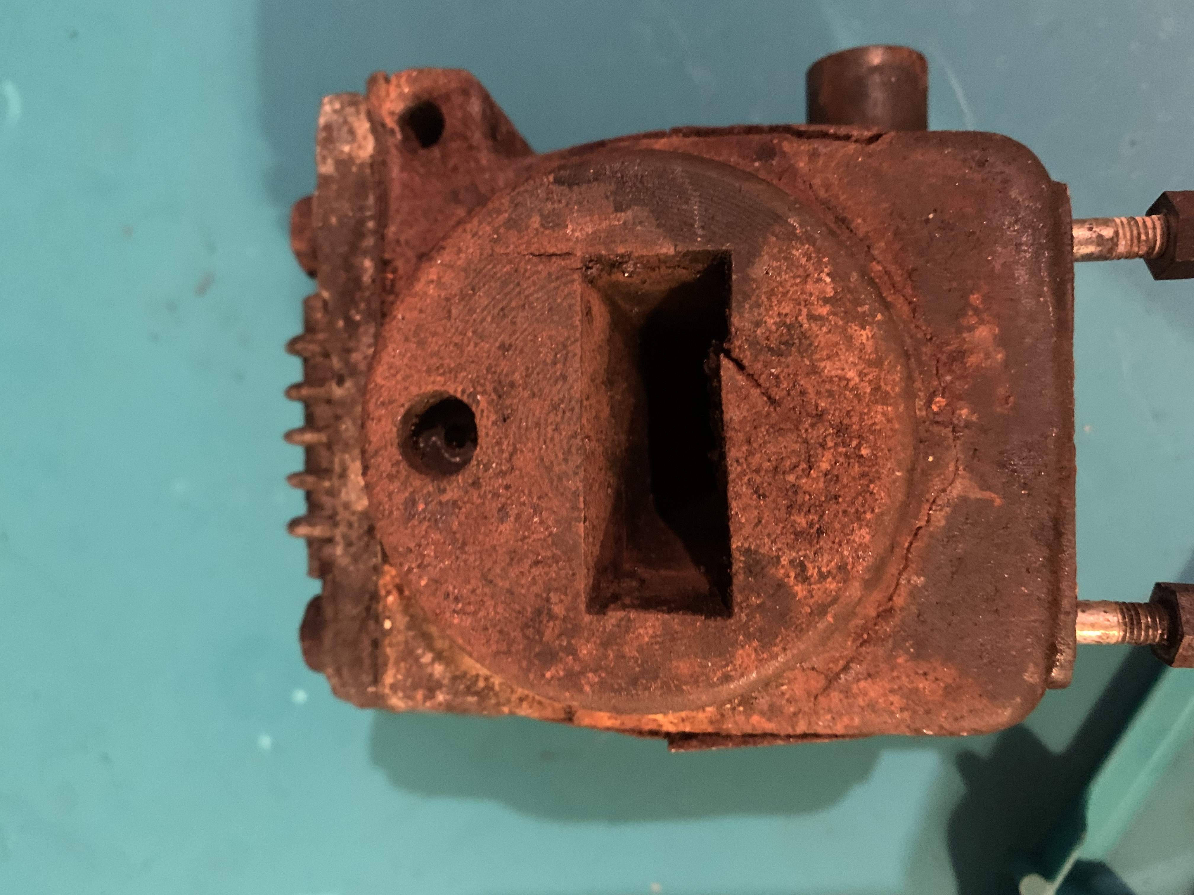

This one was my fault, I ran it in salt water about 10 years ago then stuck it in a damp garden shed without flushing. Found it in this condition last year.

Did it crack because of frozing in the shed or just because of the push of the swelling rust?
Sandro
Sandro
Only rust swelling! Doesn’t freeze here fortunately.
