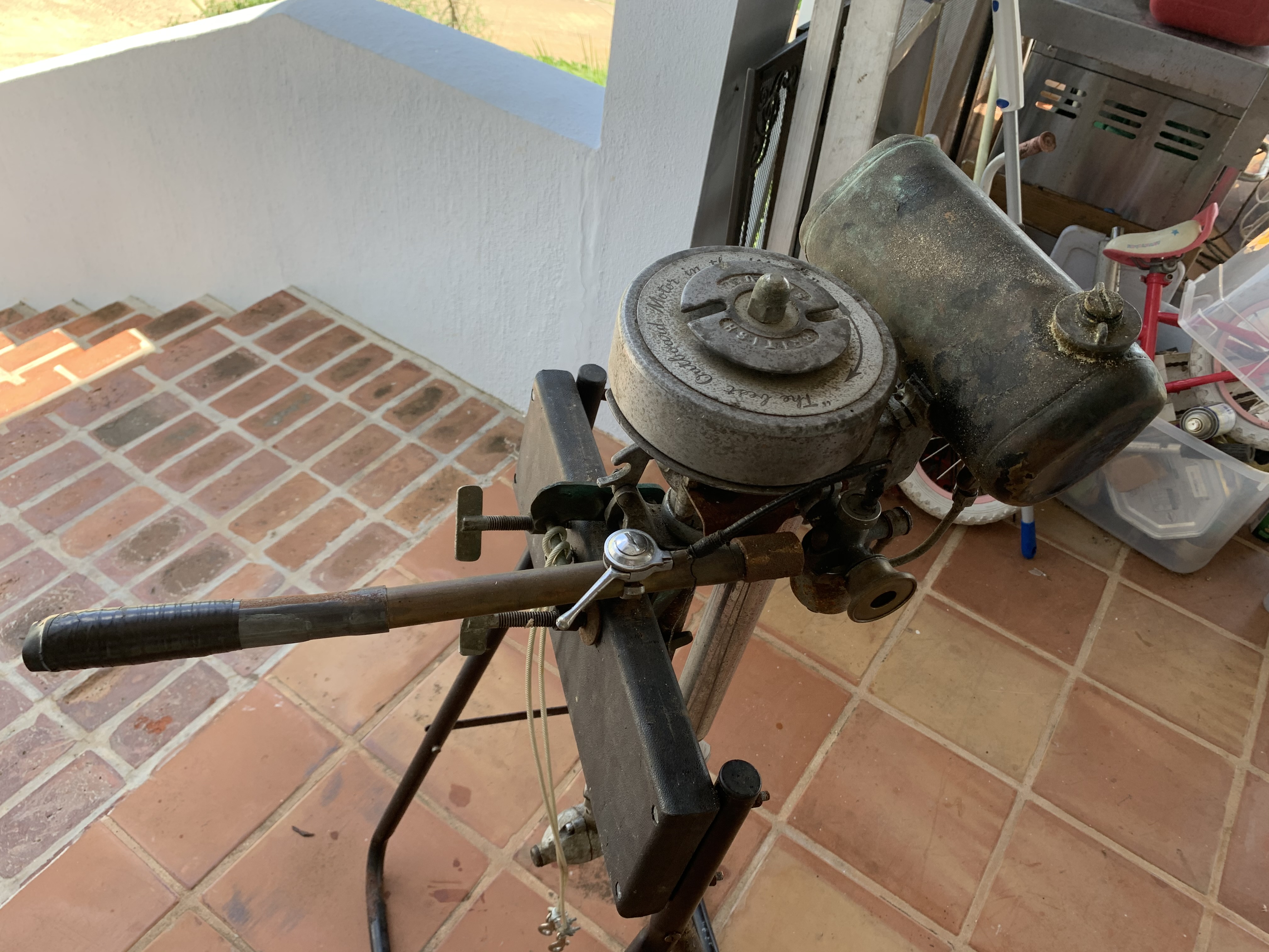

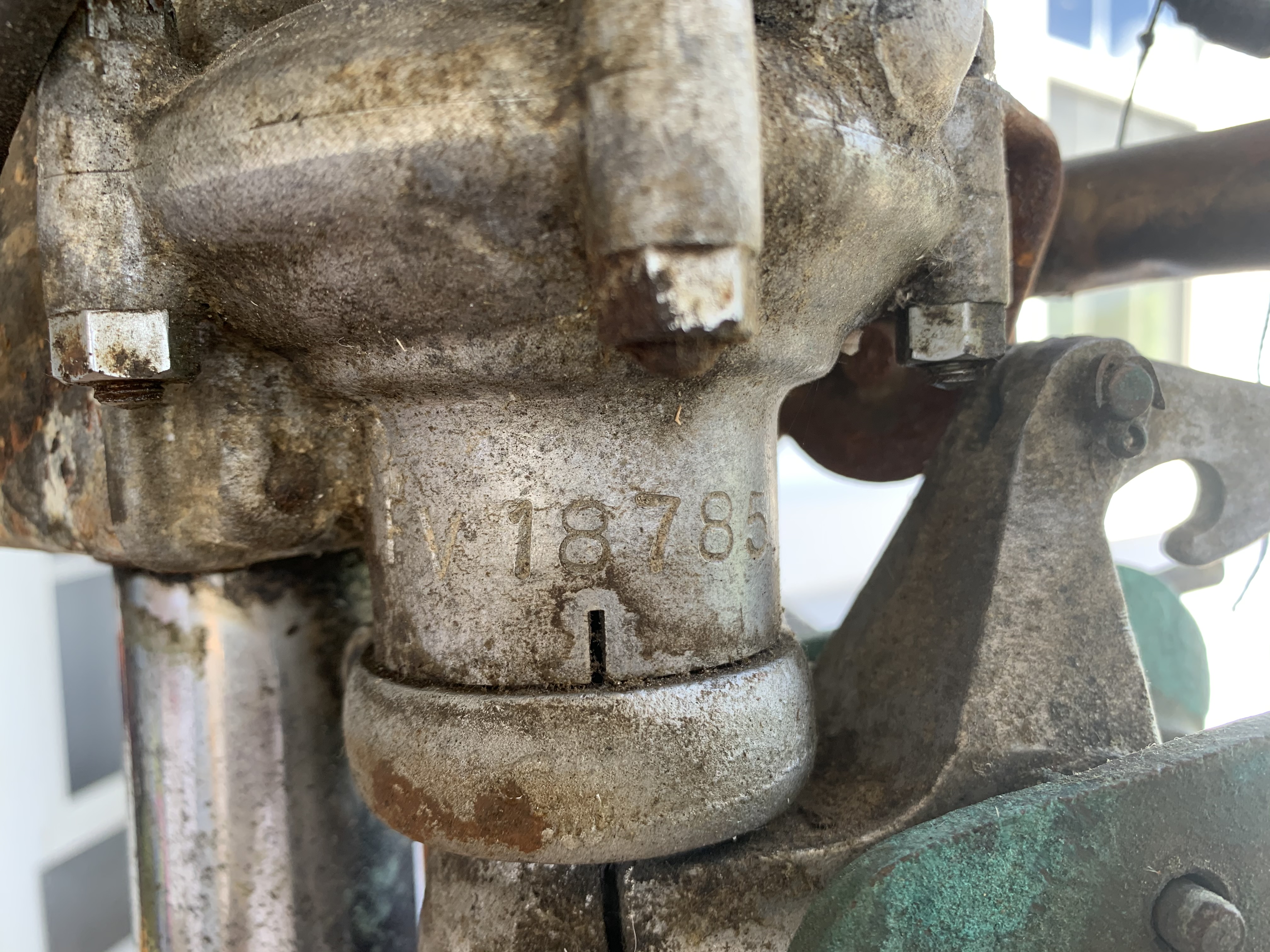

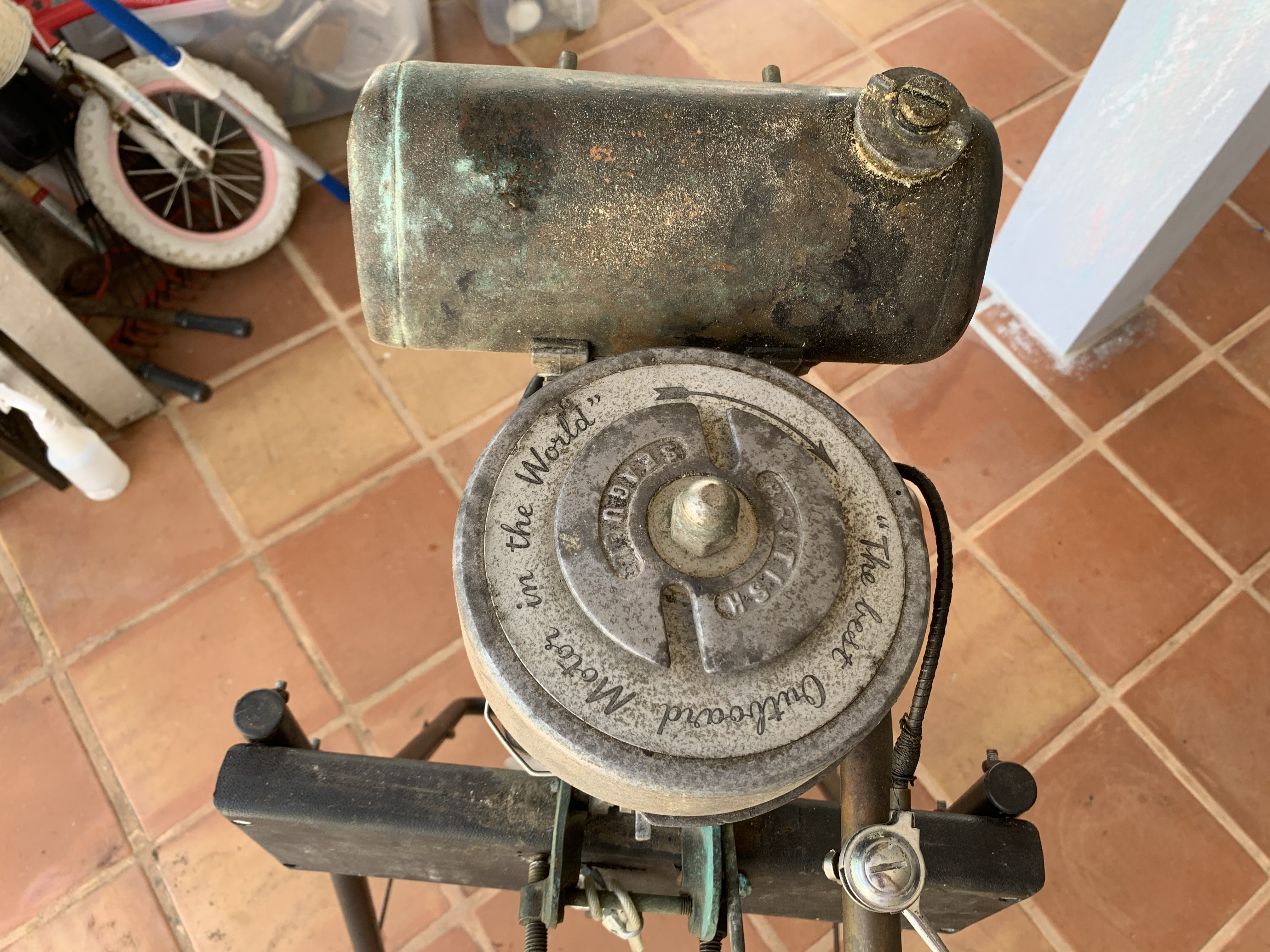

A candidate for my next project. Everyone loves photos!

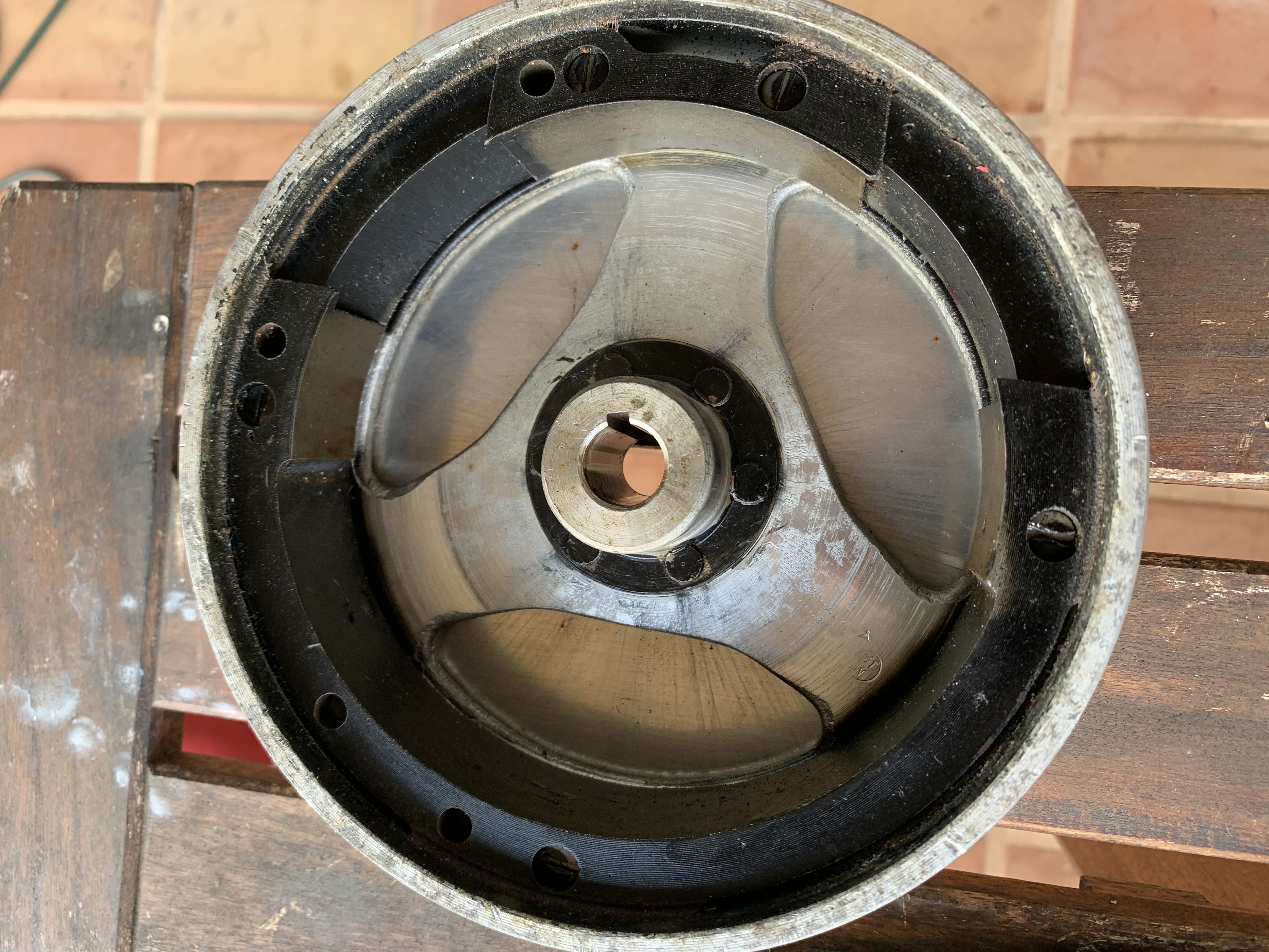

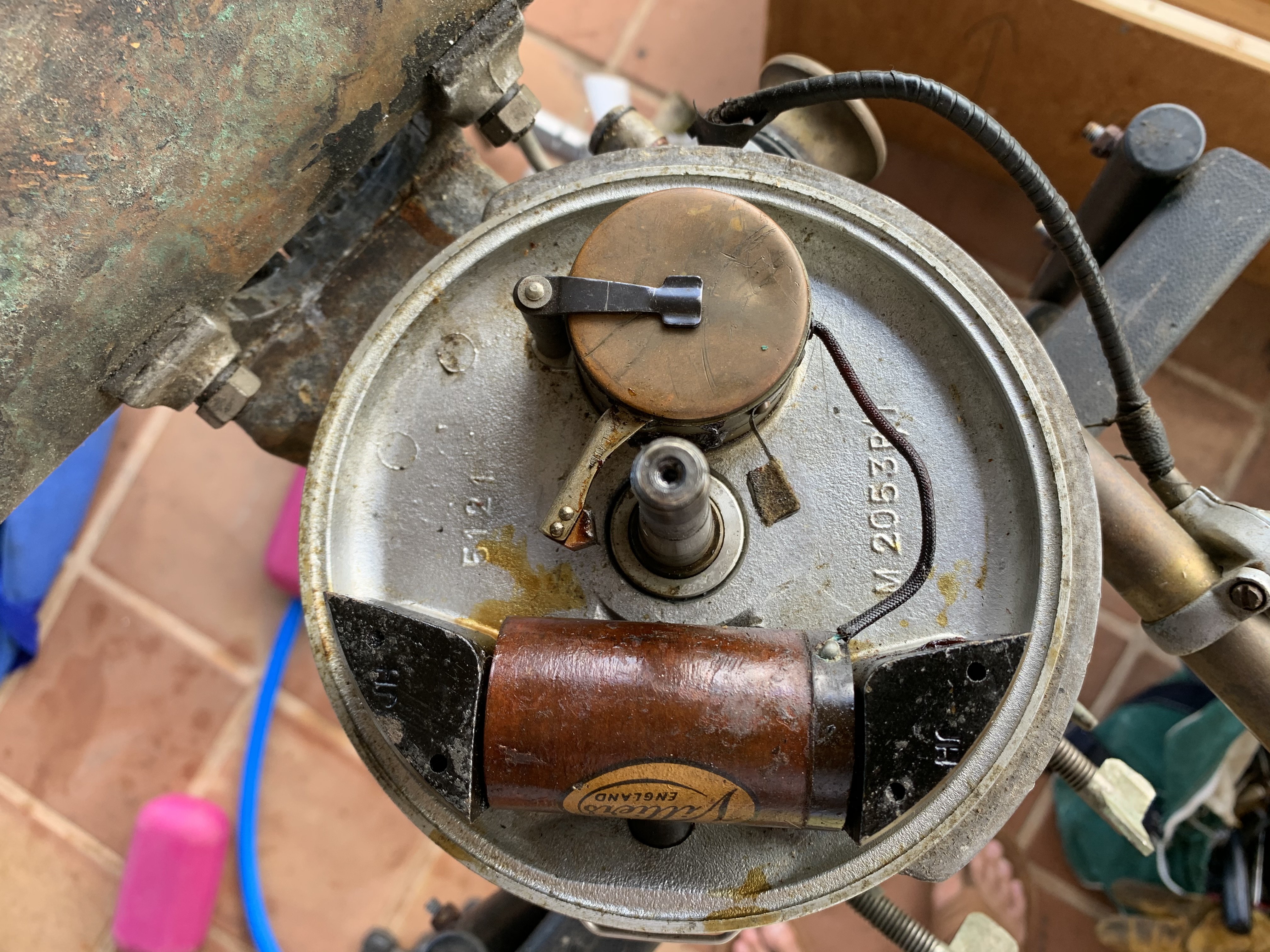

Had this a couple years but never checked it out until today. Spins freely, and most things that are supposed to move do. Coil has gone the way they are all going, no readings on the meter. It does have an orange spark, first time I've noticed that.

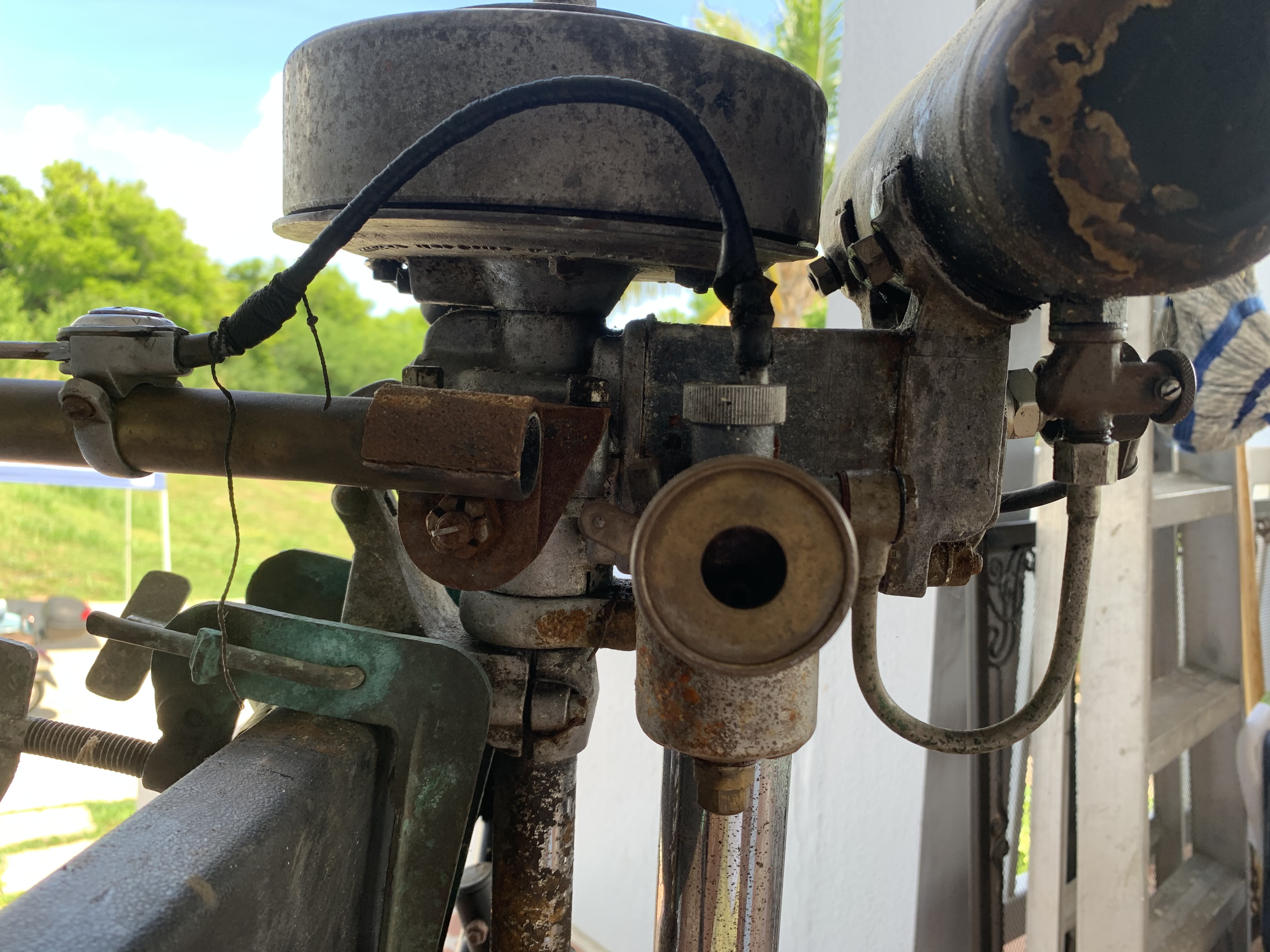

Would love to get forum feedback on this one for anything missing/unoriginal. Tiller looks extended, and tiller mount also not something I've seen before. If everything is there I'll start the hunt for a new/substitute coil, if not I may leave it a few more years :)

Hi Andrew
Looks like "FV Season" on SOS forum aye?
I am not really that able to nitpick on these later FVs as to how they should be exactly.

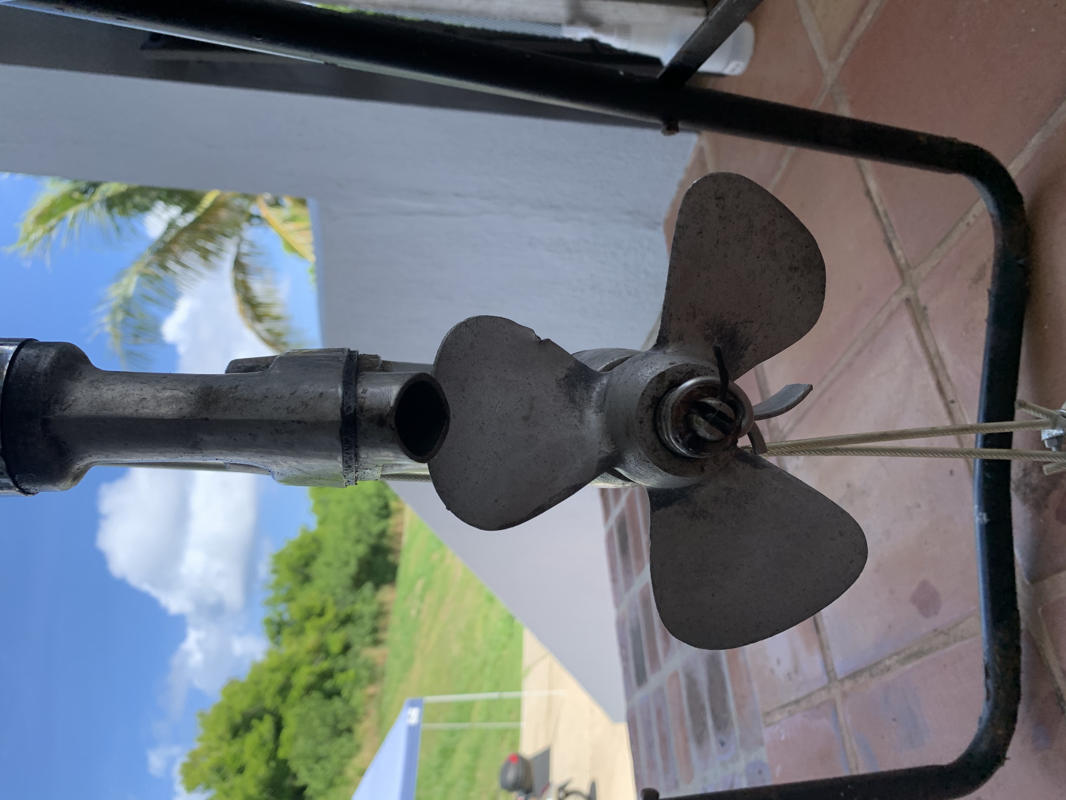

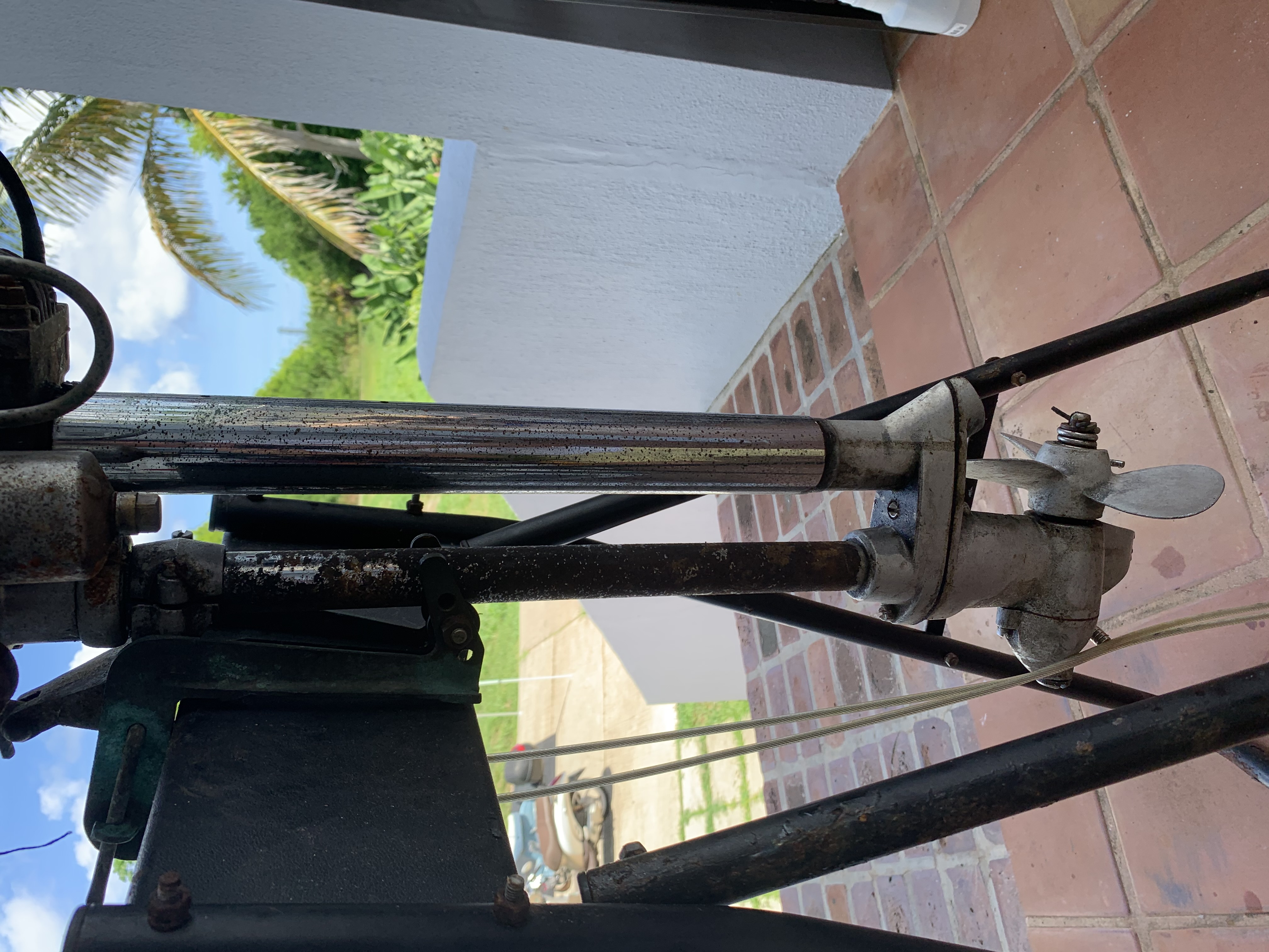

Gearbox cap is upside down (no biggy there), the transom clamp entire assy looks to be correct. (next gen from earlier years)
The tiller bracket was the next generation FV/P from earlier years. I think there were two styles as to the shape of the actual bracket...others may chip in I am sure on that.
Looks like a fun project Andrew.
Keep us informed along the way.
Bruce and Cello
Re: FV18785
Tiller mount bracket looks correct for a later FV, it replaced the cast in stub in the centre of the crankcase. Not many of those brackets about!
Re: FV18785

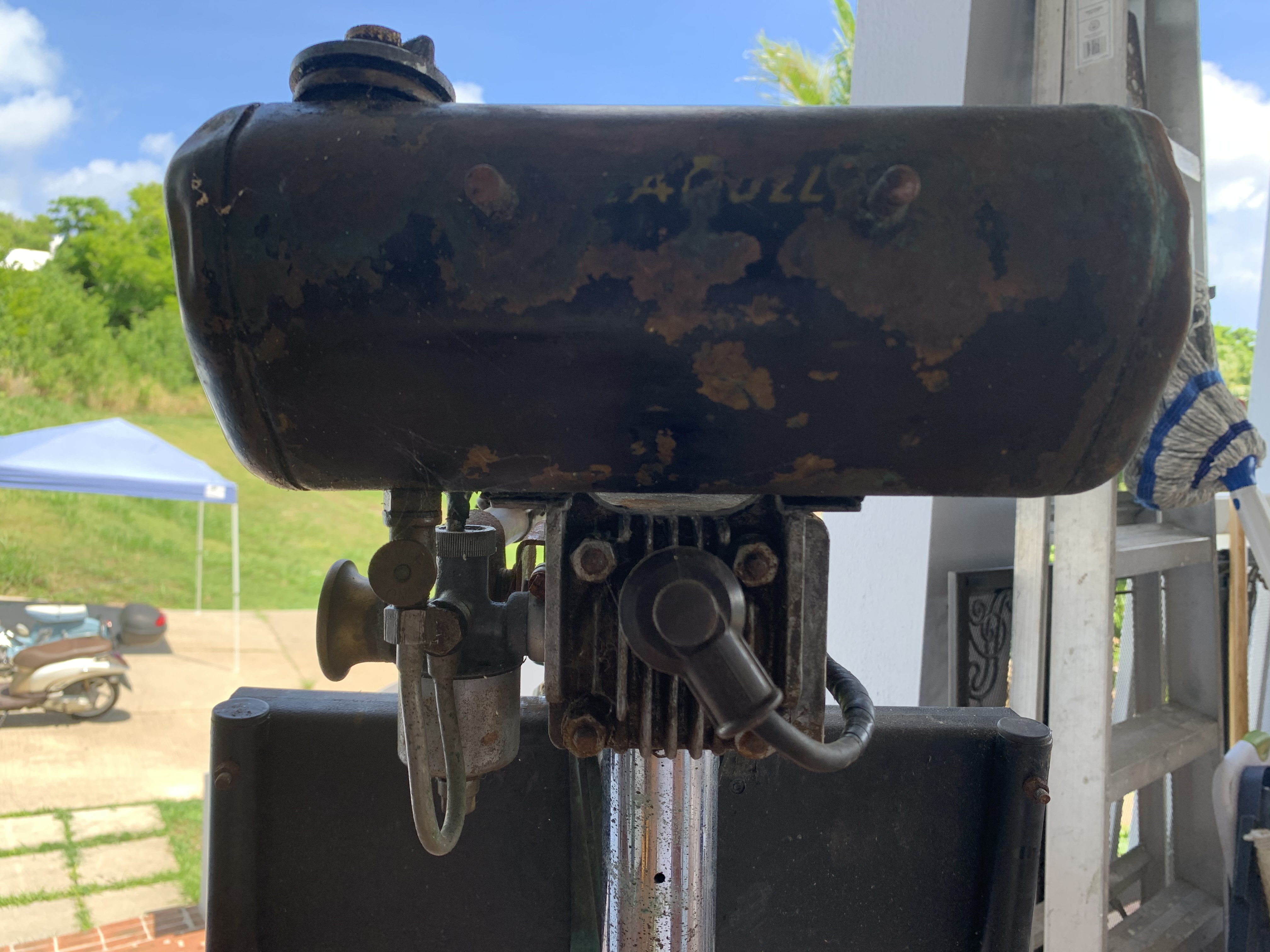

The tiller on a side mount, the U shaped fuel line, non-plated transom bracket, the transom clamp mounted on the drive tube, not the crankcase, are correct for a later Little Forty.
Half rim ignition in also correct.
