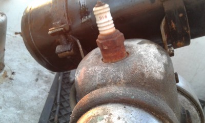

Picked up a 1952 model 102 with what looks like a dent in the head as if it was dropped on the spark plug, the broken plug got me thinking that anyway.
does anyone know if this is how they came or if its damaged?

when its going it goes really well, revs high, has loads of power but then locks up and just dies with quite a violent stop. could this be due to the dented head?
Is this normal? 102 woes

Would like to see another pic of dent can cast iron be dented I'd be checking con rod ???
