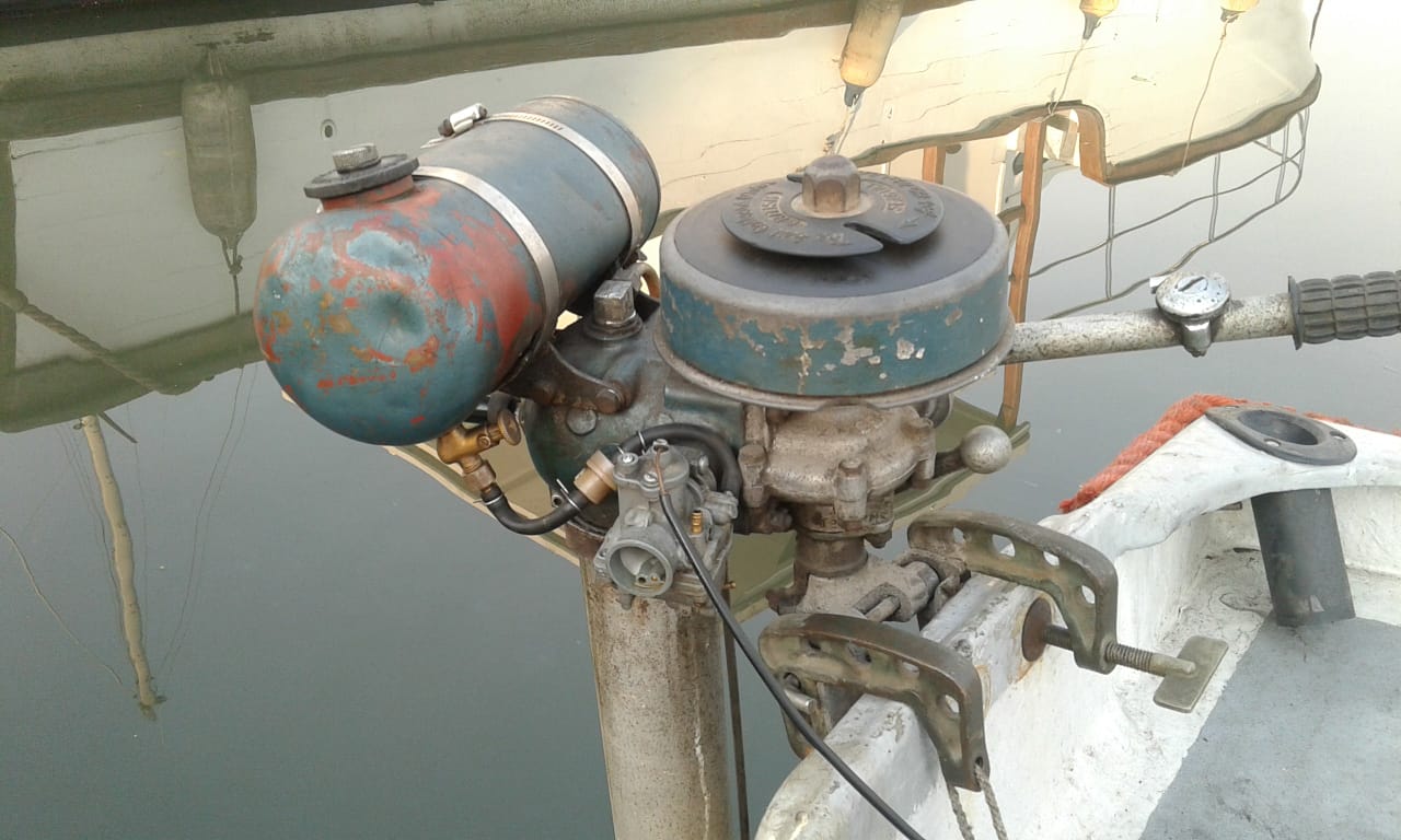

Heres the seagull as i got her, with the yamaha carb.

Getting non Gull carbs to work has been done but in your case best to get an original one to fettle the Bird that you have.

Jetting you carb is not going to be easy, as it was probably used on a motor of half the ccs & with a 50 : 1 fuel mix.

Well a pw80 is an 80cc 2stroke single cylinder motor, not far off from the 100cc seagull, i really hoped it would be as simple as bolting it on. is there any reason that a modern carb from a 100cc motor shouldn't work if you get the jet size right?

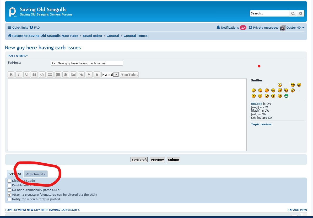

Re: New guy here having carb issues
CaptainSparrow wrote: Wed Jul 08, 2020 8:25 am i cant figure out how to post pics on the forum.
Click on attachments, options, add files then place inline.

Well your putting the carb from an 80cc, 50 : 1, reed valve motor onto a 102cc, 10 : 1, piston ported motor with 25% more capacity, that probably revs 30% less.
What's the throat diameter of your Yam carb & which jets are currently fitted & what size Jets are available at your location & at what sort of cost?
Your also going to need a throttle lever & possible an adjuster for the throttle cable, but most of all do not use without replacing the missing transom screw!

I'd suggest looking on ebay for the correct carb, as setting up the one you have might be tricky. To attach photos see this screenshot:

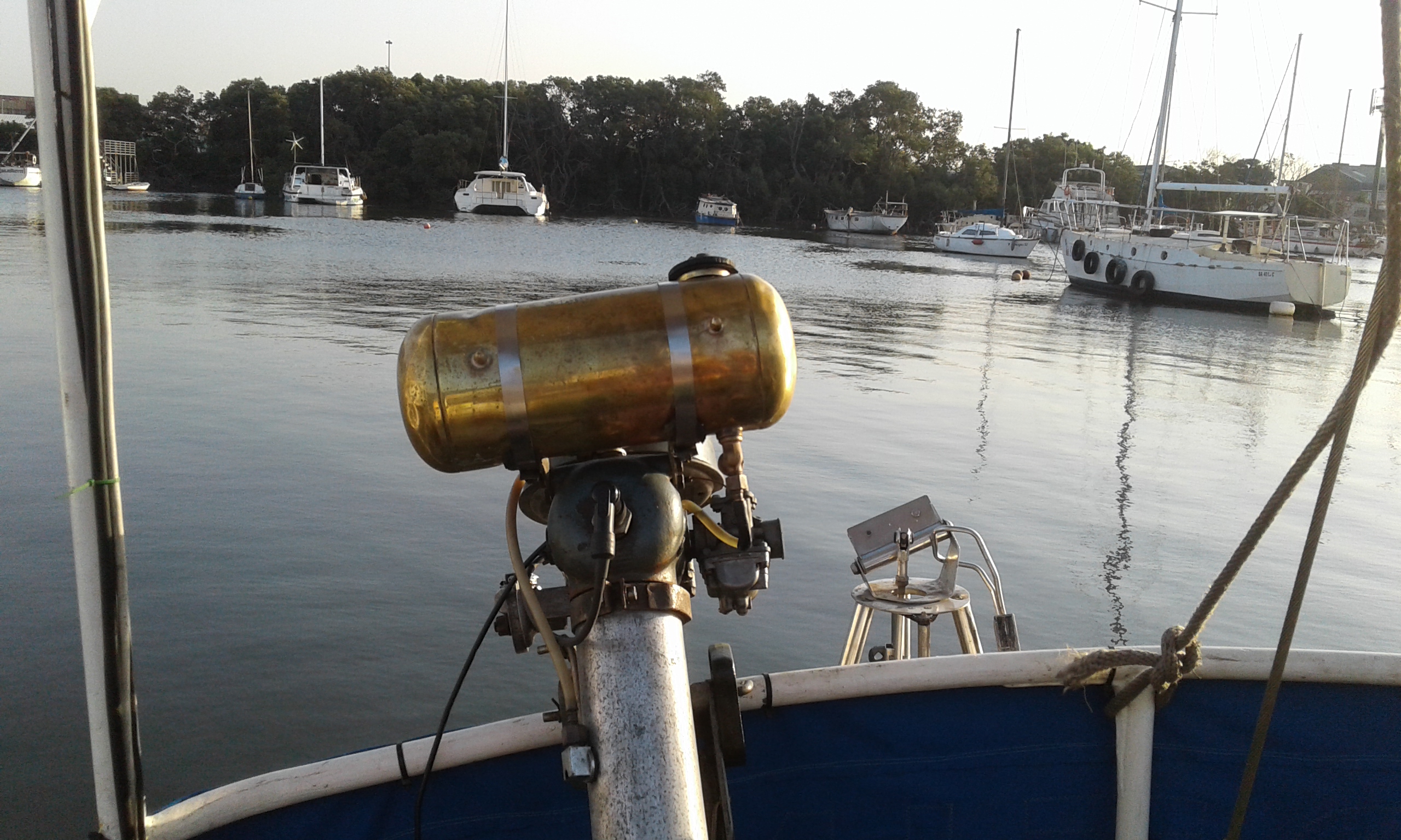

in the mean time look what i found under all that paint on the tank... thats right, 4 cracks from over tightening the clamps. :mrgreen:

well after a little looking around i was fortunate enough to be given not one but 3 amal 2 jet carbs, i stripped them all as they were really gunky and rusted. built up one and slapped it on. the motor runs so much better with her original carb and fresh juice with quality oil.
Theres a bad misfire which is the next issue ill address, i did give the ignition system some attention when i cleaned her up, maybe i did something wrong... top of my list is:
The cable I used is for solar panels
The spring i uses from a bik pen, looks stainless but probably isnt. kinda hard to find a brass spring
Modern suppressor cap with built in resistors, suppose its easy enough to replace it with a ring lug and see if it helps
point and plug gaps set at 0.5mm
