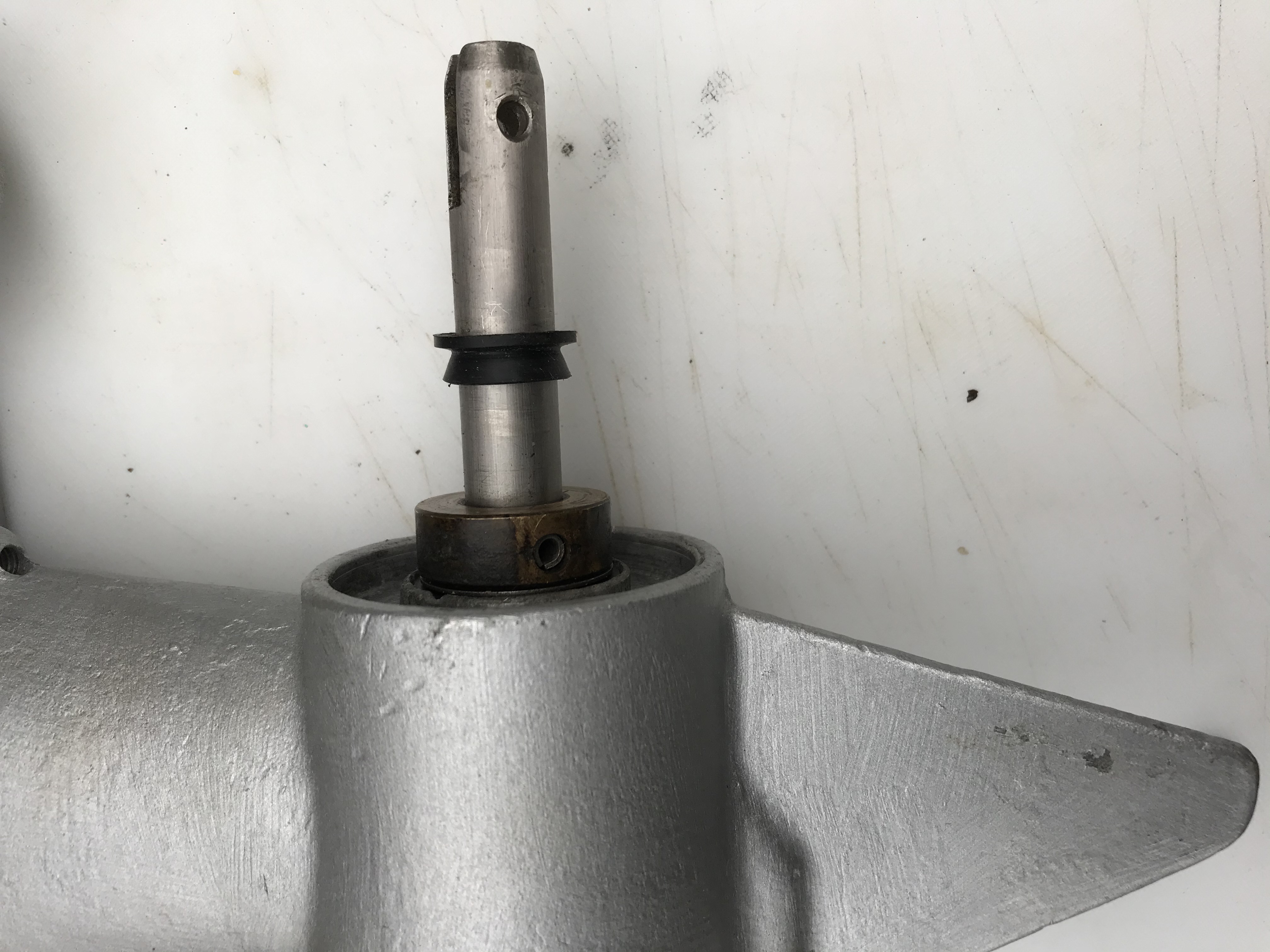

Is this the right way round - with the lip towards  the gear box?

It's been separated from it's engine - but it is a 10/21 featherweight box without seals, in good condition.
I have taken what you said on a previous thread ie tried to get the prop shaft so that it has no play up and down and almost none ( I suspect it's about 10 thou) fore and aft - and a new what the spares book calls a rubber oil seal washer - and D140 Castrol gear oil - but it still (very slightly) leaks

For some weird reason the photo comes back with unrecognised file - or similar!

Try again
At last - seems to have worked
Obtained from wych bearings, as per thread some time ago

I can't see what your trying to achieve, where is your oil seal going to go.
						Re: V ring seals on prop shaft
As I understand the previous thread from the guy who suggested it, it replaces the Sheridan rubber seal washer altogether - and supposedly acts more as a seal rather than merely a grit barrier
It’s on there in the photo just to demonstrate its shape - the photo here looks a bit different from the photo in the thread, so I wonder if it’s the same. I have put it with the lip facing towards the gear box, which is presumably the right direction?
Also, I understand that it’s meant to rotate with the prop shaft, hence it’s tight fit. Part V12A is supposed to be for shafts 11.5-12.5 and the shaft is12.67 mm so perhaps it’s a bit tight but that’s what was suggested

So the seal on your pic is where it's going just a little lower.
No it’s instead of the existing British seagull rubber seal/wash ie I would take off the brass collar and put the new seal behind it
The new ring seal is smaller in its outer diameter than the BS one - does this matter?

No it's probably going to rotate with the shaft against the brim of the top hat shaped prop shaft phosphor bronze bearing.
If your loosing SAE 140 gear oil from the prop shaft bush it's normally a sign that there is wear on the prop shaft or the bush or both, when these boxes were new, they lost very little oil.
The models with boxes designed for oil seals were & are very good when they have good seals on the prop shaft & pinion.
I have never tried Gannet's idea, but I have renewed prop shafts & their bushes & pinion bushes, a high cost fix, I've also tried changing the gear oil grade, a much cheaper potential fix, I think I've tried 220, 350 & 480.
480 is the viscosity I use in the early grease nipple boxes.
Raising the viscosity of the gear oil either with a heavier grade cocktail or just a few squirts of cheap grease that will mix with SAE 140 might well minimise your oil leakage problem.

Thanks for that - very helpful - I’ll give it a try and see how it goes
I didn’t realise one could get 220,350 and 480 - which of these still pour? And who sells them - I haven’t seen them on web sites

I suppose I should have asked that question more intelligently - which of the heavier oils stay on the teeth of the gears whilst in use, and therefore still lubricate them?
And does it matter what GL number they have? GL4 seems to be the only suitable grade around commercially these days

I am cancelling my previous two entries, quite simply because buying any heavier oil I have discovered is going to cost about £17 for 1 litre -having already bought sae 140 1 litre, so it’s all getting a bit out of control and counter productive
Thank you again for explaining it - I shall try the ring seal and put some grease (which I already have several tins of..) into the existing 140

I got mine from heavy industrial machine service engineers, it seemed to arrive in milk bottles, they all seem to pour & they get it in 200 litre drums.
All Seagull lower units in the 30's & 40's had grease/oil nipples & no oil filler cap, I can't remember what the recommended lubricant was but you'll find it on here, CharlesP was researching that area.
