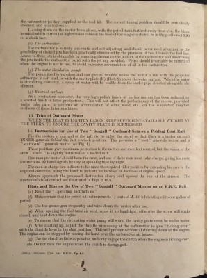

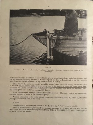

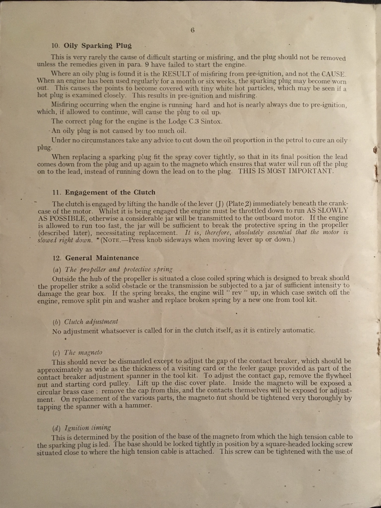

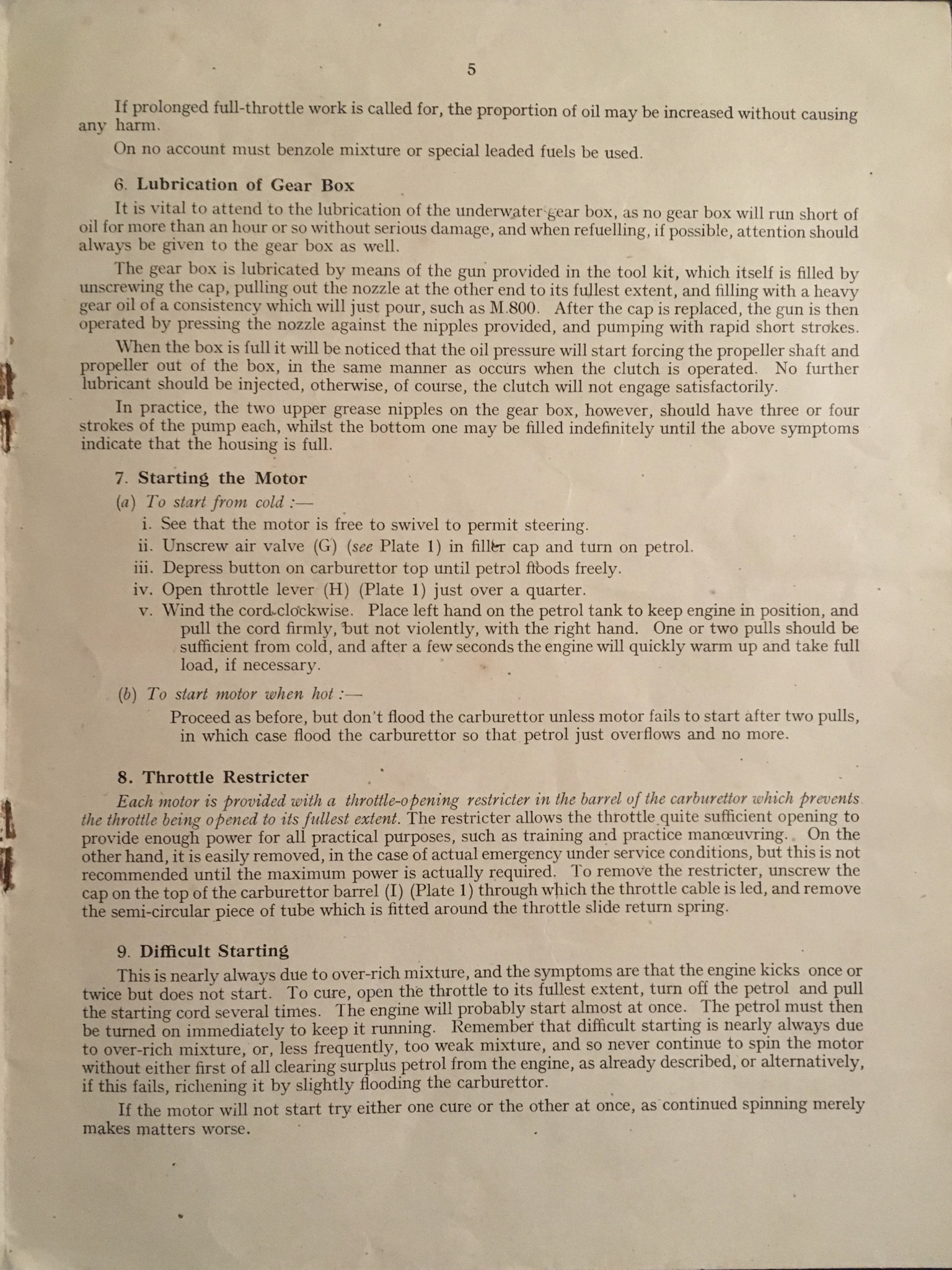

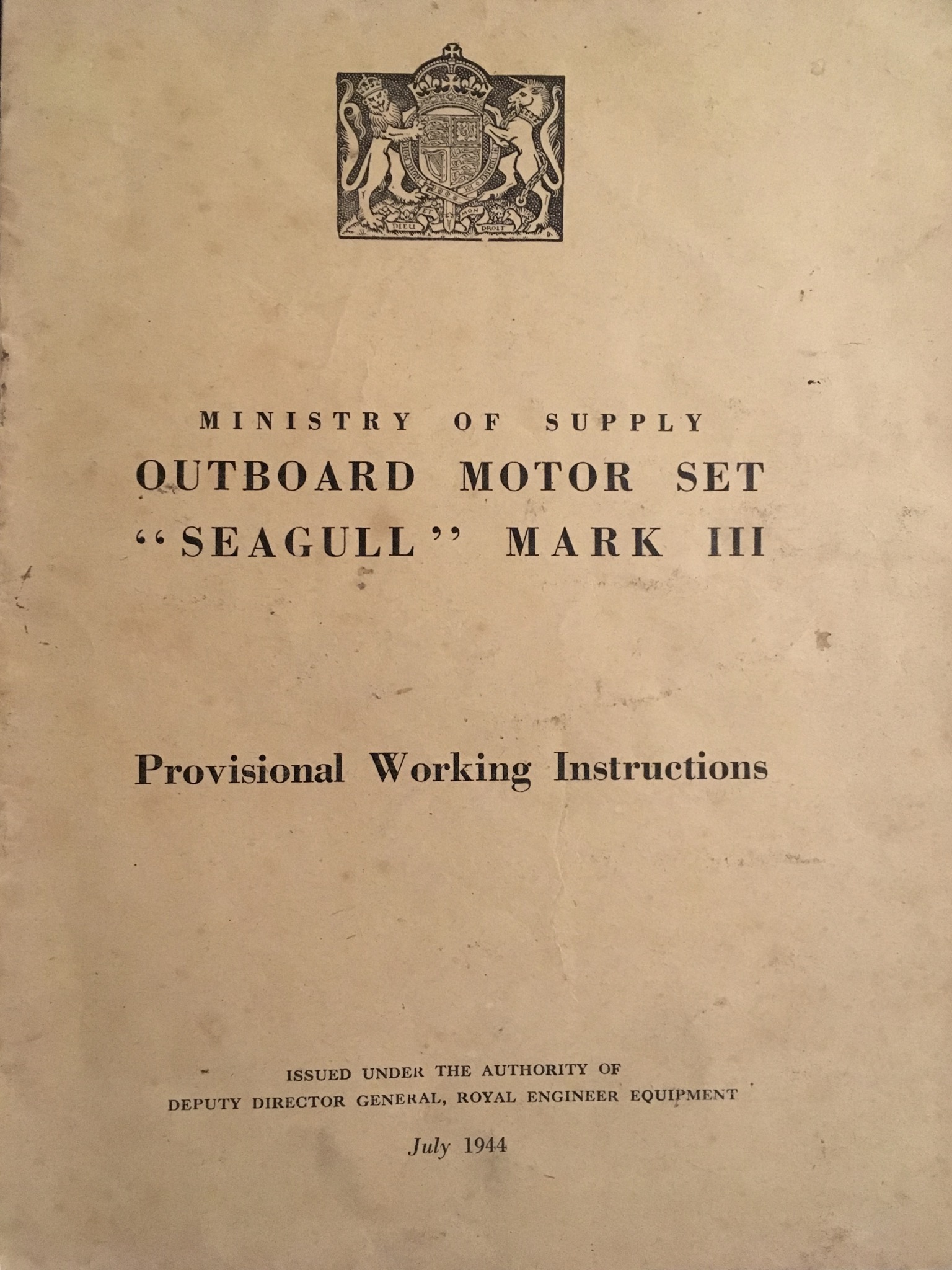

Here’s a little Christmas gift for those with an interest, I picked it up recently and thought why not share it.
Re: A little gift
Excellent ! Thanks for sharing
I wonder what the mk 1 and 2 were ?

On page 2, in the list of spares, it specifies the spark plug as a Sintox C3. This is a Lodge plug. Did the SD's have Lodge from the factory or was this just the army spec for the replacement? I can't recall this plug being mentioned in any of the posts I've read.

Nice old read that -
1 and 1/4 pints to the gallon is a very heavy mix ? ( thats over 6:1 )
Also - did SD's have a choke flap ? - as there is no mention of using one on starting - cold or hot.
I like the advice tip ( adjust throttle screw until it ticks over etc ) and stop it by choking.
Are side mounts common - never seen one or seen one for sale ?
Good basic advice there also for problem starting a flooded 2 stroke.

No choke just a 2" trumpet, chromed or bare brass.
There are pics on here of wartime side mount brackets but they were designed for specific military boats so need modification to work on modern gunnel & transom styles.
Remember there were no 2-stroke oils available pre 1950, apart from racing castor oil so a bit of extra 30 weight motor oil was probably playing safe!

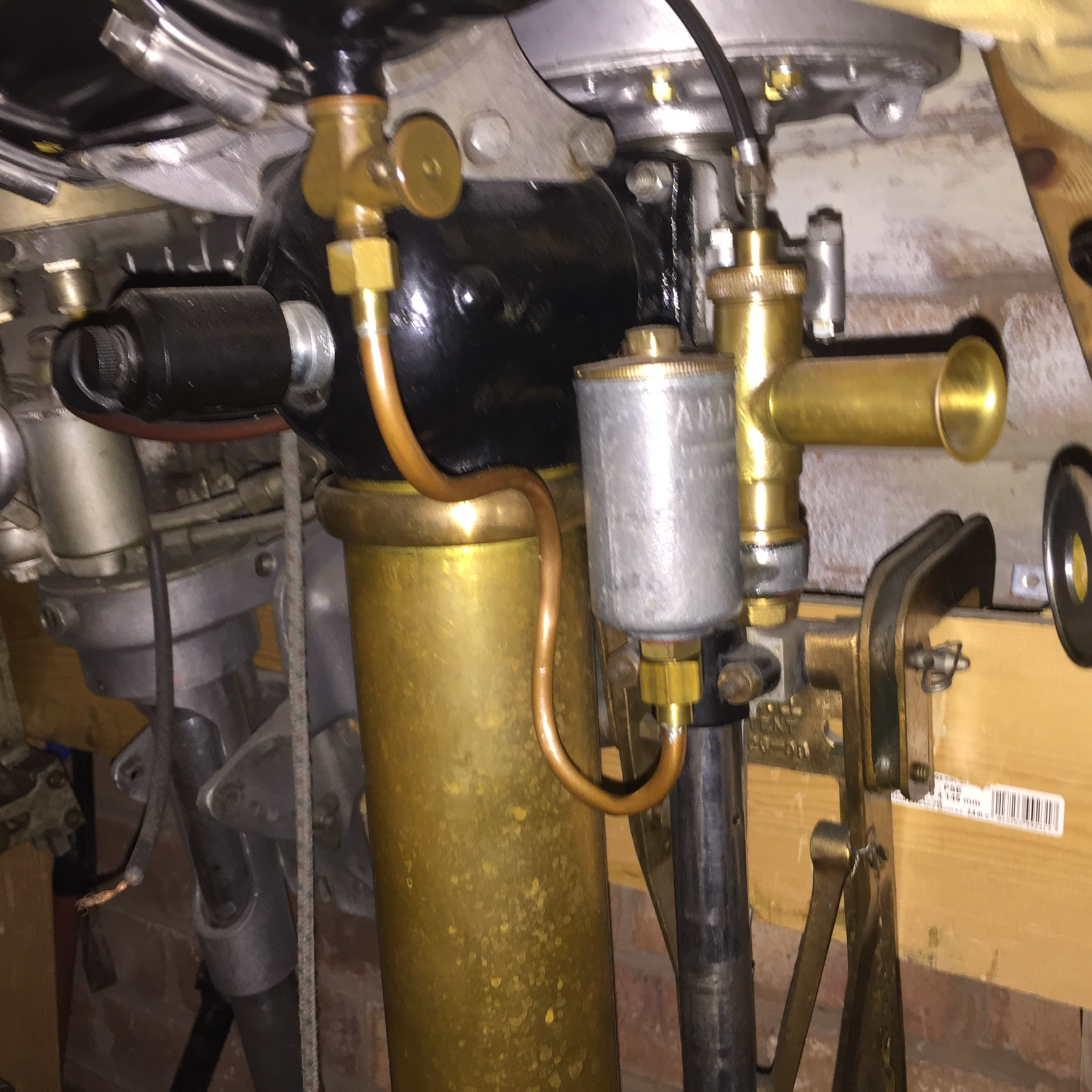

Here’s a another photo of a wartime side mount, only a few of these known to exist. Also a photo of a brass inlet trumpet, fitted to a rare brass carb body.
